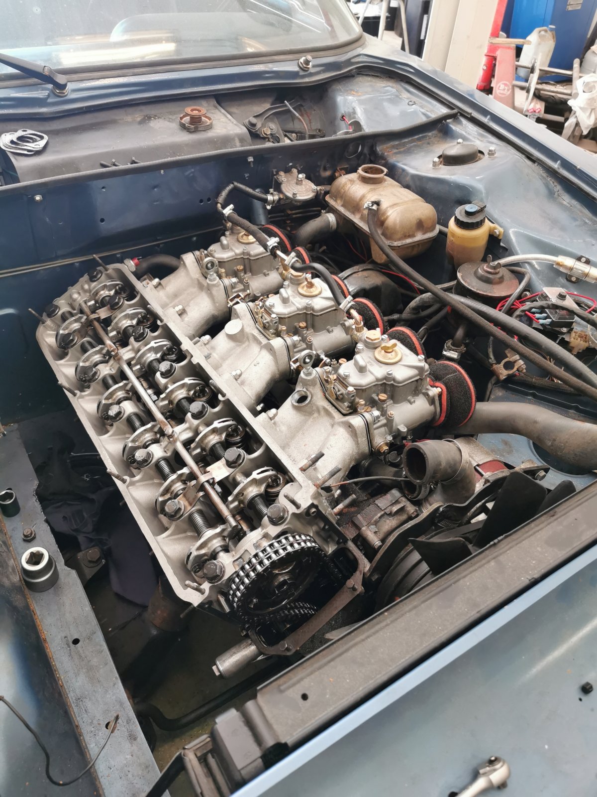

Last year I change my head with a later one since overheating the original and finding exhaust in the coolant. Bought an 85 head and spent 1000 bucks to have it completely redone. Pressure tested, milled, New valves etc. Also milled the chain cover.
Started it up last year just to see that everything worked then it's been sitting and now I've rejetted my dcoes and change bearings in the trans to get it Rolling again.
However i am getting a lot of blue smoke, and also bubbles in my coolant when revving. This gives me bad vibes.
Bolt bores were cleaned thouroughly and bolts and washers lightly oiled when I installed the head. Torqued after warming up, However did not loosen the bolts to do it. Have not found my coolant exhaust tester yet so will see what that tells me when I find it.
Will I have to redo the whole thing again?

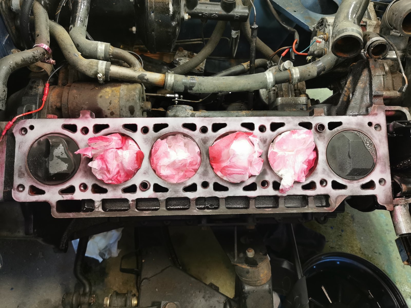

Alright, no oil in the coolant luckily. Will pull the head tomorrow, all is prepared now though.

Is there a trick to detect very fine cracks? I think my block is good but I want to make sure while I'm in there.
sfdon
8,148
4,469
sfbay area
A bright light and some patience.
and study that gasket carefully
use a micrometer on the gasket

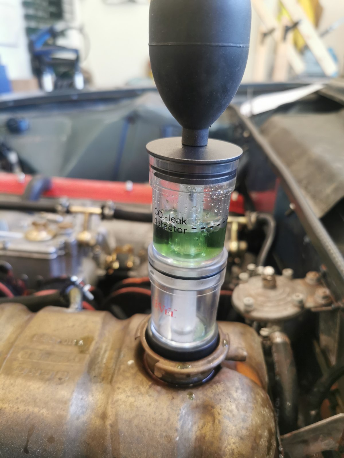

Checked the block with light and Crick 120 crack detector. Found nothing.
My exhaust coolant tester turns green though. Dont know what to make of it?
Still runs hot, but not as before. Takes longer and kond of settles around 3/4 up. Will buy a new temp sensor and see IF that is acting up.

Been checking temperature with a laser now and it shows about 85 C, even with temp gauge higher than middle. None of the hoses are hard, which would indicate exhaust in coolant. Starting to question the reliability of The test or if it's possible that exhaust gases can be trapped within the coolant system from before?
