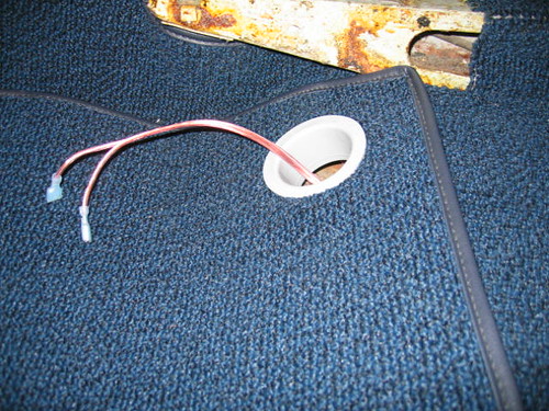

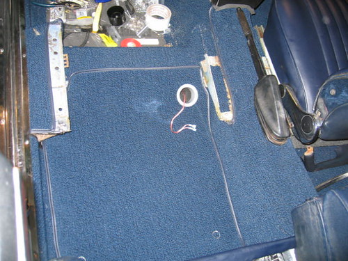

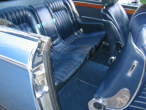

In this photo, the carpet has been installed and inconspicuous 2-inch; hole cut in the box; under the driver seat to create a sound chamber for the 6x9 speakers.
This is the least intrusive space to mount 6x9 speakers in a coupe. No cutting of rear parcel shelf or area beneath the rear seat. Very innocuous location!

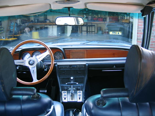

In this photo you can see the dash panel with new veneer has een installed revealing the newly mounted 1.5-inch; tweeter speakers that will be hidden by the speaker grill. The other wires behind there are for the power door locks/central locking and alarm.
Tweeter mounts are fabricated from galvanized &quot;L&quot; brackets screwed into the rear of the vertical dash wood by shaved wood screws (screws can't be more than say 5/16-inch; long, otherwise they'll comprimise the front veneer).

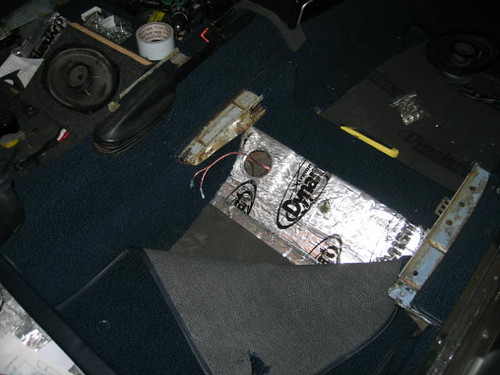

Dynamat & Dynaliner under carpet
Close-up of the 2-inch hole cut for sound chamber.
Here is aprofile shot of the speaker box. As you can see, it's a very tight squeeze. I ended up shaving another 1/2-inch; from the bottom of the speaker box after this shot was taken.
Here you can see the speaker hidden below the seat.
Rear passenger leg room was not a concern for me. My primary concern was to avoid cutting holes in the parcel shelf and area beneath the rear seat.

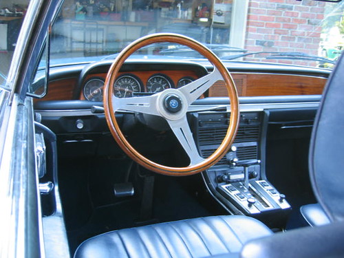

The period-look; radio is a 240 Watt obtained from Woody's in LA. has 4-channel output, choice of 6-disk changer, USB interface or i-Pod interface. all controlled from head unit.
Need to obtain some correct vintage BMW knobs to finish.
I still haven't figured a solution to the former location of the Fasten Seat Belt indicator that polluted the middle of the dash.
I may re-install it and have the alarm indicator LED reside inside the seat belt indicator.

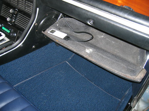

Here you can see the finished carpet and inconspicuous location of iPod dock cord in the glove box.
....and, after 8 months, the first day in the sun!

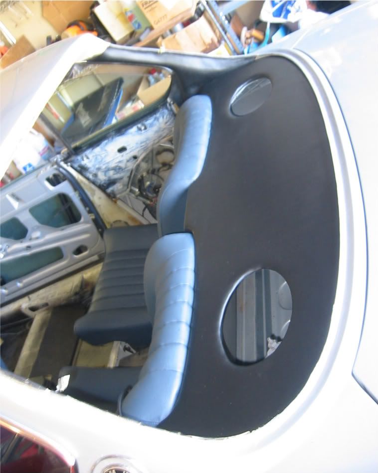

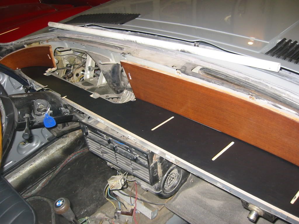

You're a good month ahead of me. Here's a couple of photos showing what I worked on today: rear parcel shelf, and dashboard assembly.
