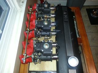

Hello!
I'm in the middle of rebuilding my Weber carbs. My question is: the carbs have been sitting for a while and I've been soaking various parts to loosen things up. I'm trying to remove/inspect accelerator rod and spring. There is no movement at all! Is there a trick to removing or is mine stuck? Any ideas?
Thanks!

These are side drafts. I'll post before and after pics!

Thanks for all the help! Head is out at the shop...this is where I'm at!
