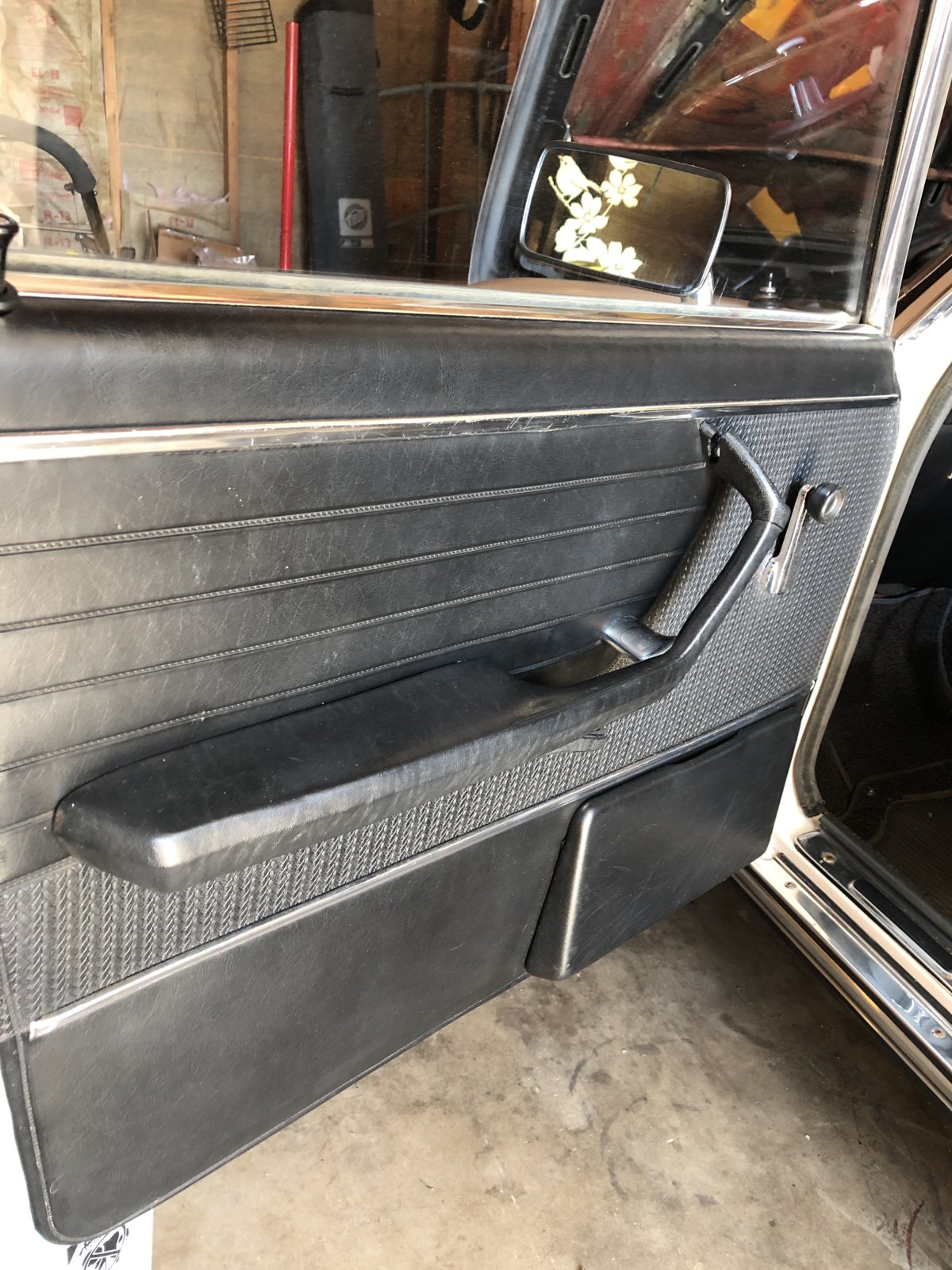

I have been pulling out the old seat covers and the blue vinyl under it is near perfect. It was a great surprise. Even the driver seat is great. The carpet is great too. Looks original. The doors also look great, except for the drivers side door pull. It’s broken at the top. Here’s pics.

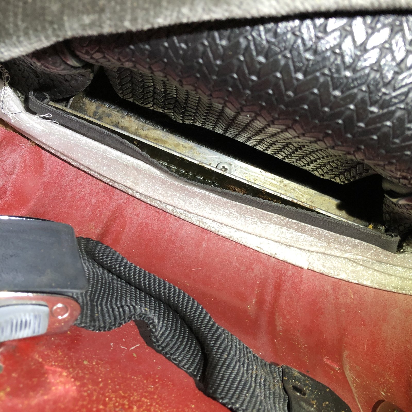

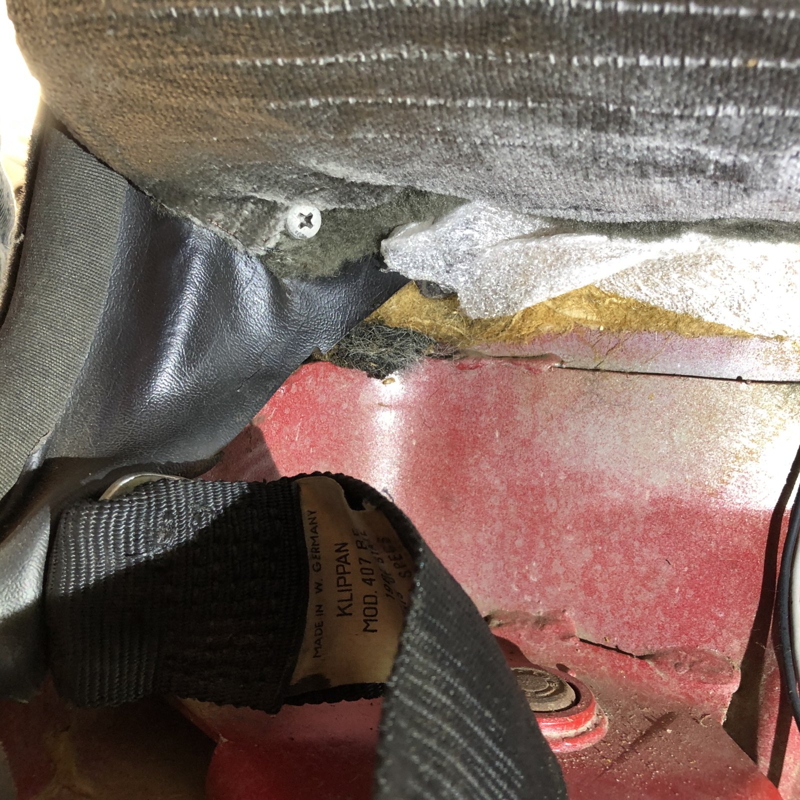

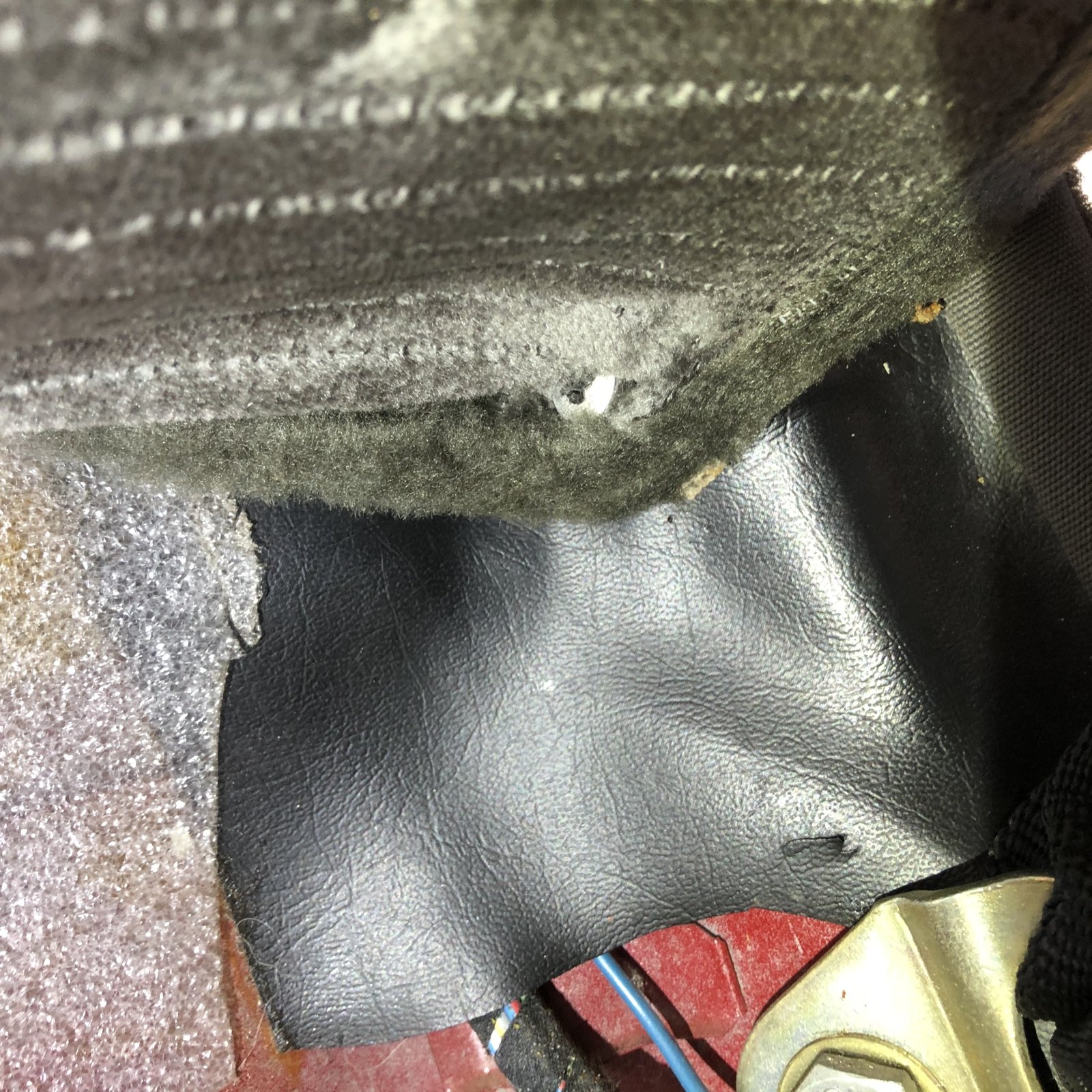

Ok, here are pictures of the 3 screws holding the upper rear seat in place.
this one is a little difficult to see because of the sagging seat cover
here’s the middle
And here is the opposite side

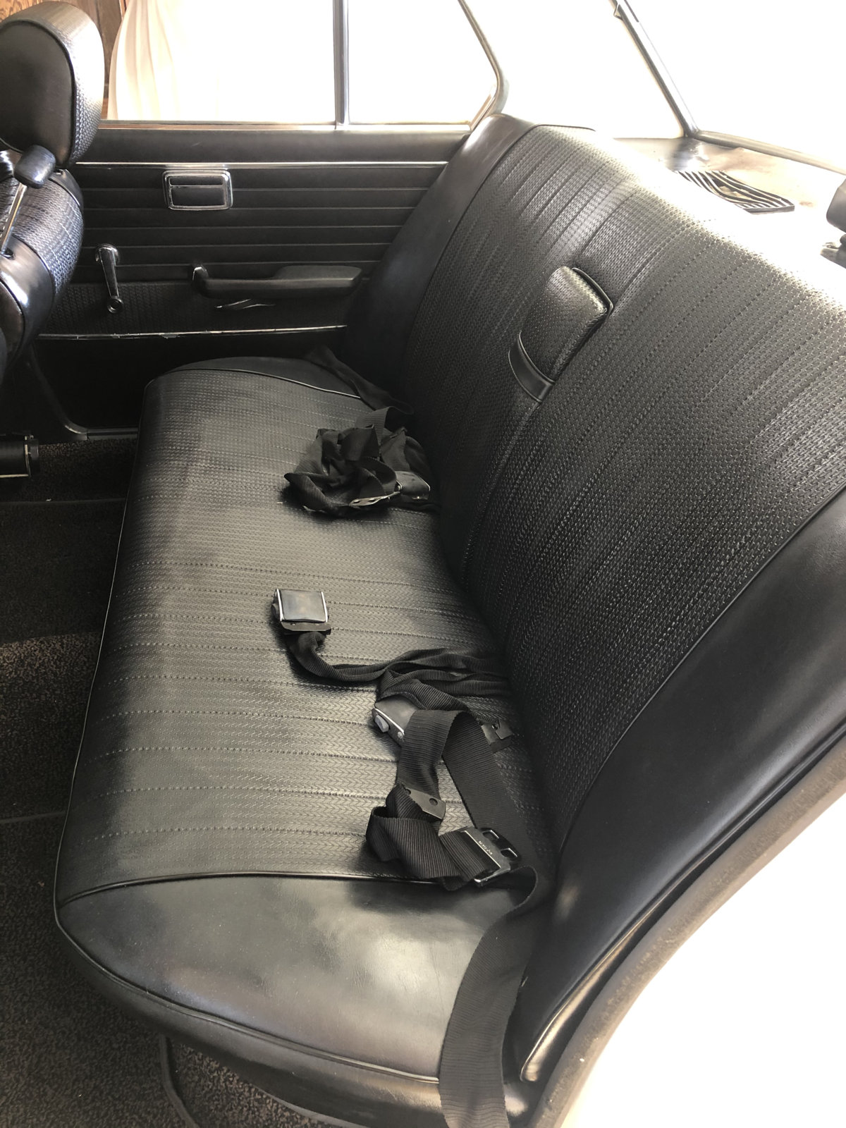

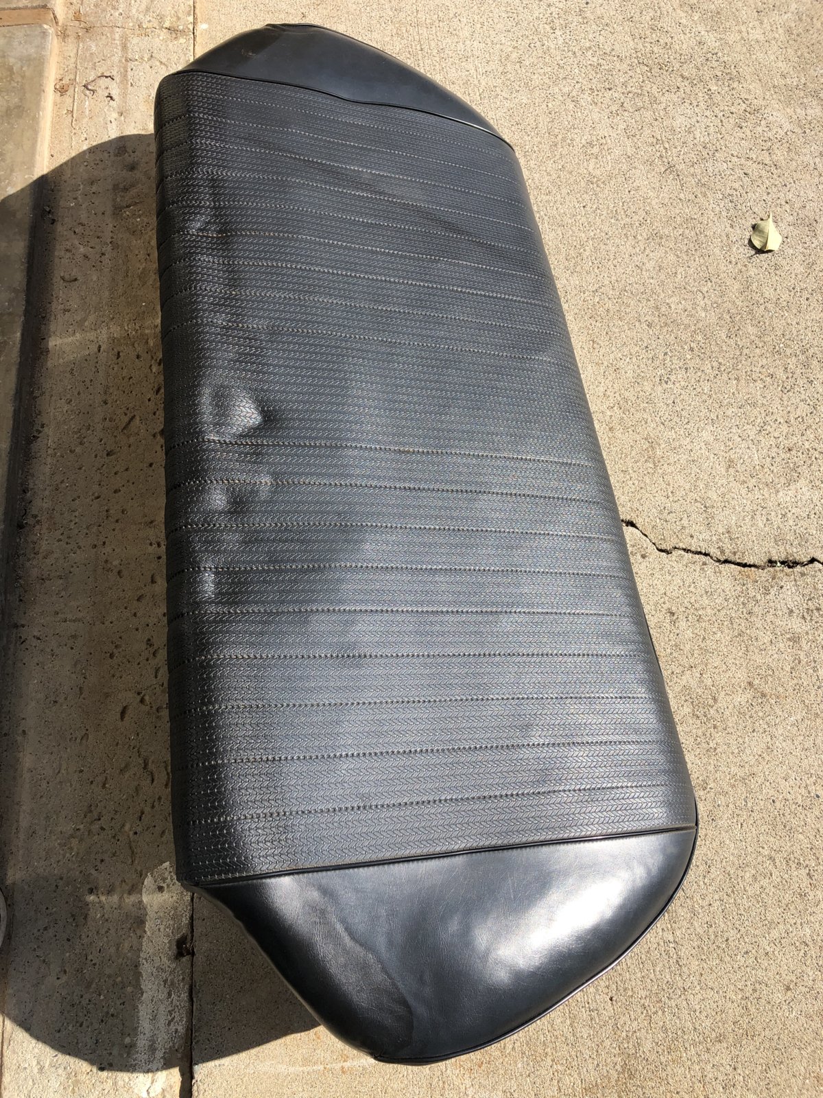

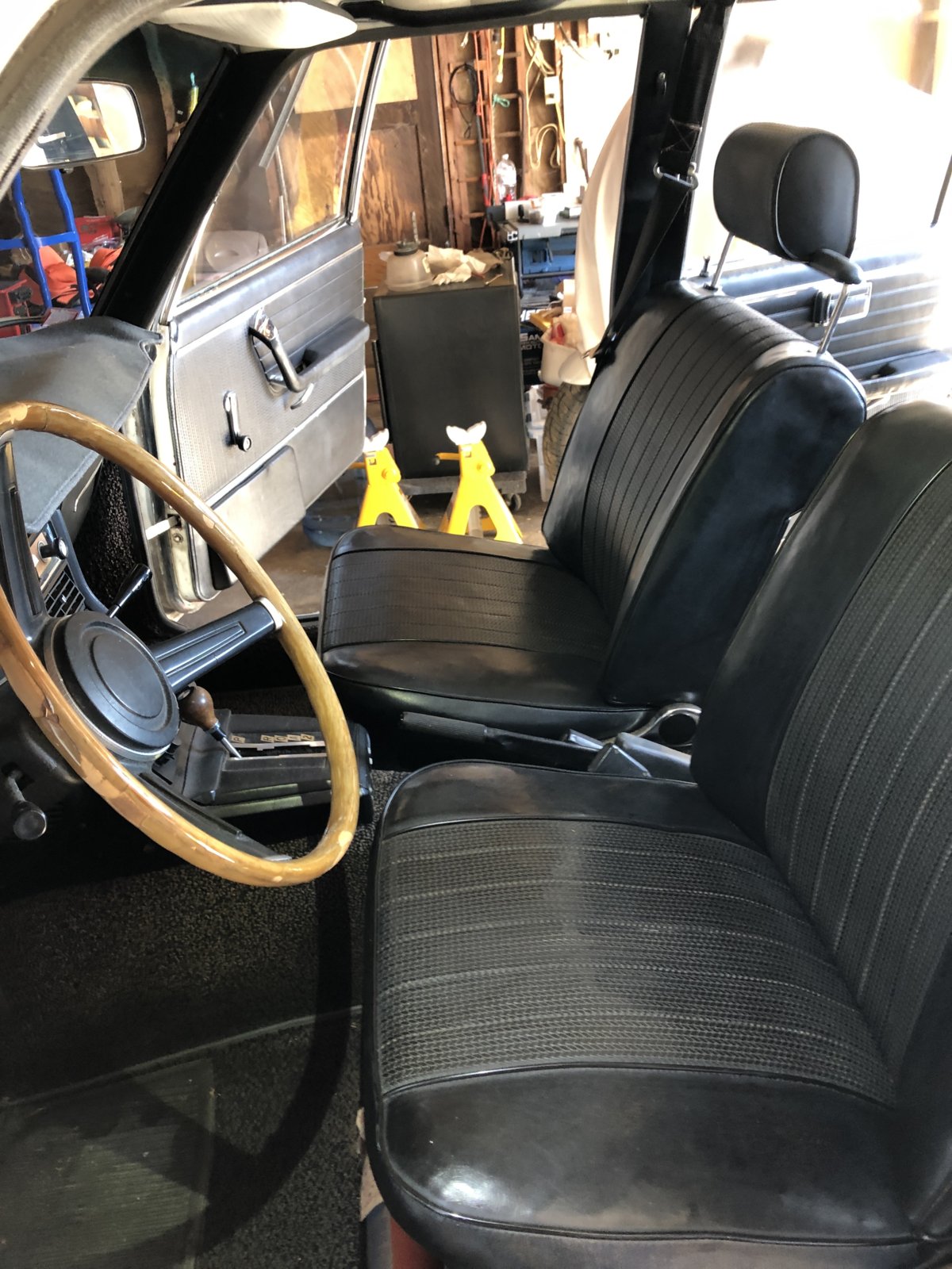

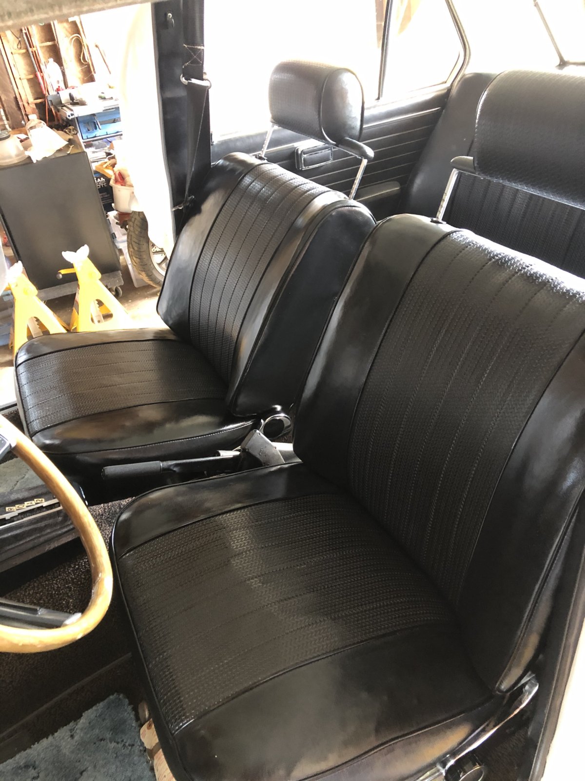

And here are what the seats look like after cleaning and mineral oiling. Thanks for the advice on that, it worked well.
