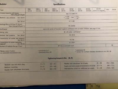

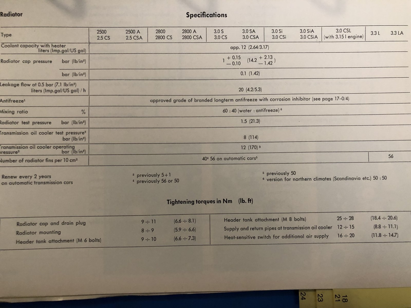

What should the psi be for a radiator/coolant pressure test for a 73 CSi with D-jet? 21.5 per Blue Book?
