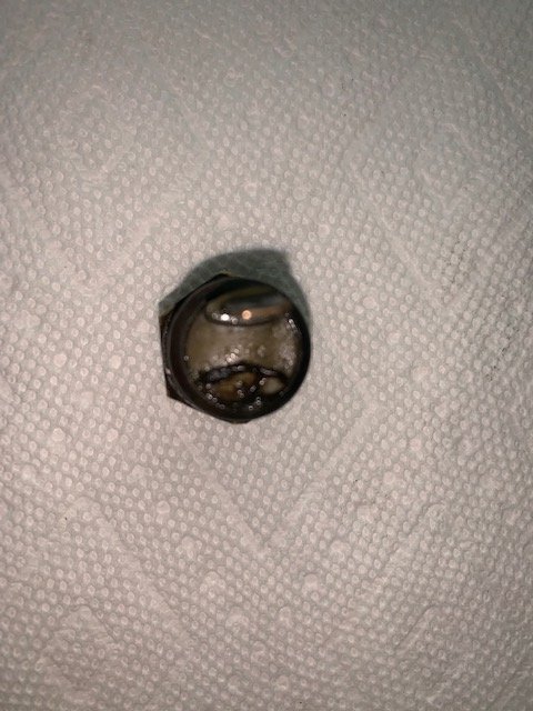

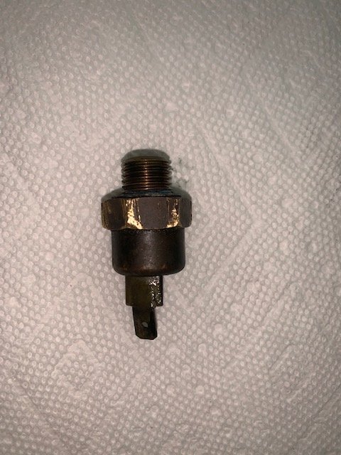

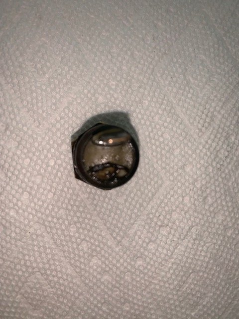

Sorry, should have sent some. Here's one from the side and one looking straight down on it. I tried to solder it back on but there's nothing to grab onto so it just melted some of the plastic.

It is the temp sensor that turns on the fan in front of radiator when A/C is off and car gets too hot. These were introduced in 74.

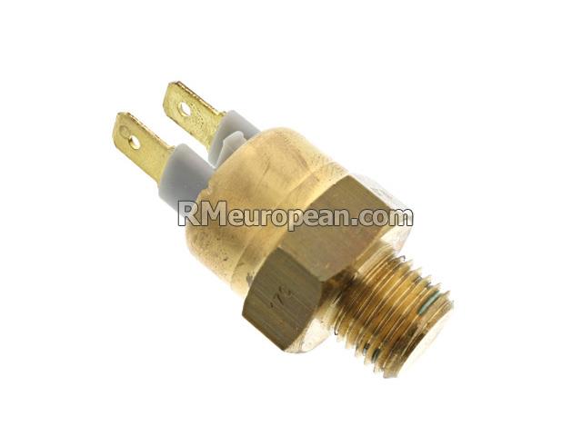

BMW 320i Coupe E21 2.0L L4 Auxiliary Fan Switch - 82 deg. C
BMW 320i Coupe E21 2.0L L4 Auxiliary Fan Switch - 82 deg. C​
