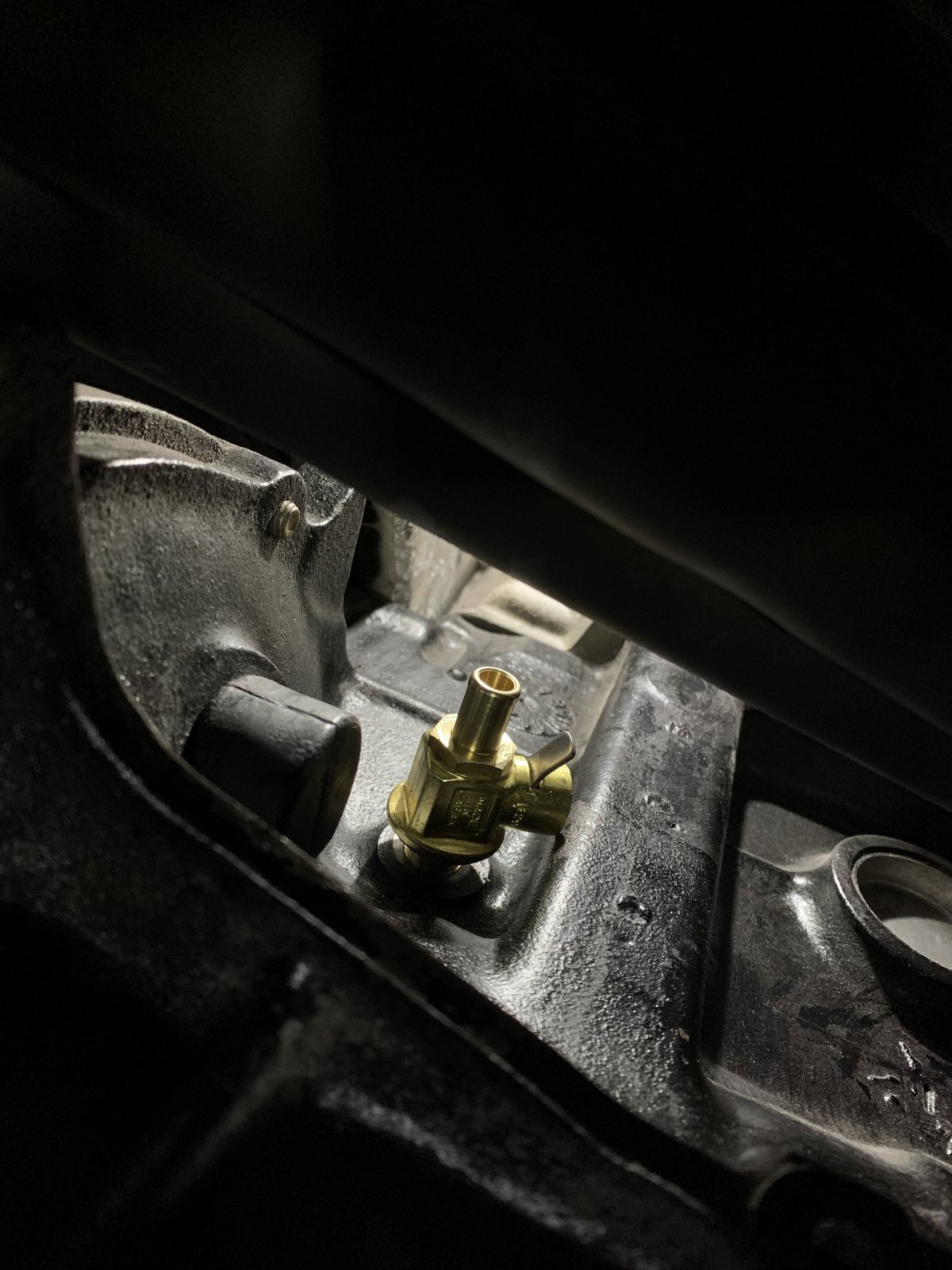

Bmachine
3,525
1,779
Northern California coast
@Ohmess Chris did you also install a fumoto valve on the block coolant drain hole? I tried to do that but you need to use their extension because there is a “rib” on the block that keeps you from screwing the valve in.
Luckily they have an extension just for that reason
Hi Bo - No, I just did the radiator. But now that you mention it...
