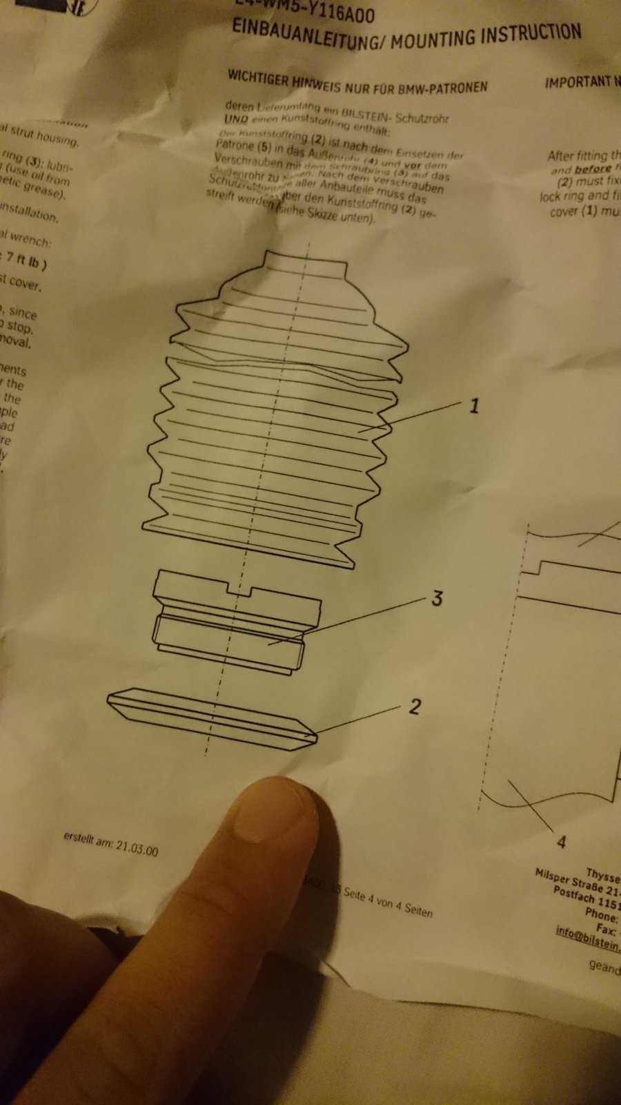

Hello to everyone. I'm trying to catch the best topic about the Bilstein B6 install and I found this one.
I'm now almost ready to install the front cartridge into the original strut suspension.
Reading the Bilstein manual instruction they say that I have to install a plastic ring, under the dust cover, for the BMW assembly but into the box it's missing....
It's necessary? if it's needed were I can buy It?
Thank's in advance and sorry for my not perfect English
Belgiumbarry
1,618
1,116
Belgium
yes Carmine, that ring was for the oem dust cover to seal" perfect"... not needed with Bilstein's ….it doesn't even fit if i remember correctly.
Carmine
24
14
Italy
Thank you! And another question. Whit the new Bilstein it's necessary or not put the oil into the suspension strut in order to dissipate the calor?
Thank you in advance!
Belgiumbarry
1,618
1,116
Belgium
if necessary , i don't know… but it sure can do no harm ! i always put oil in the struts to help cooling effect to the outer tube. I even fill it up till overflow.... so contact is 100 %.
