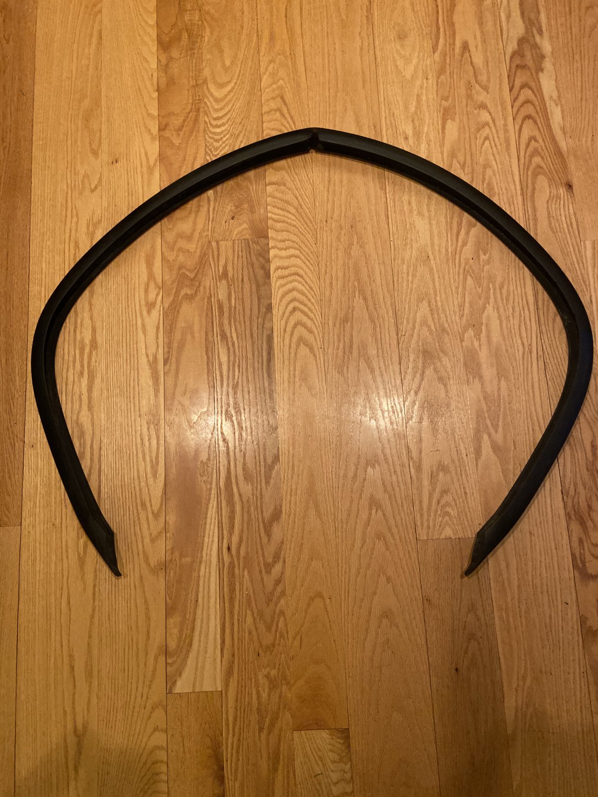

I've got 2 sets of rear bumper covers- $65 each ship free. Blemish can be mounted on bottom,

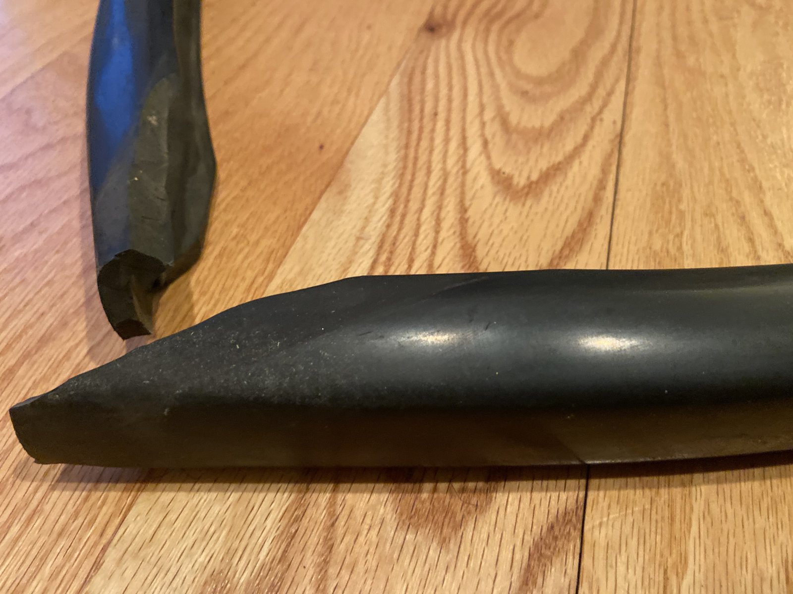

Heres' the other set. Unit is solid, bumps were generated as faults on bumper. Again, bumper can be mounted so blems are underneath.

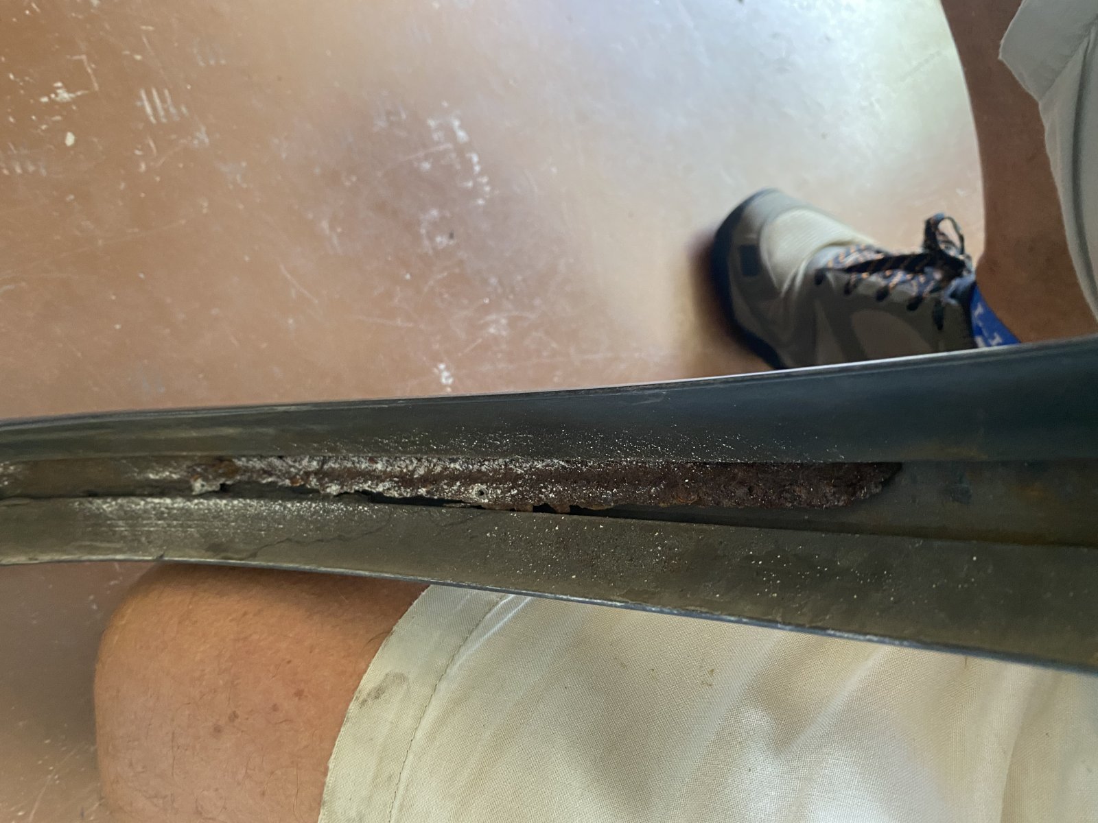

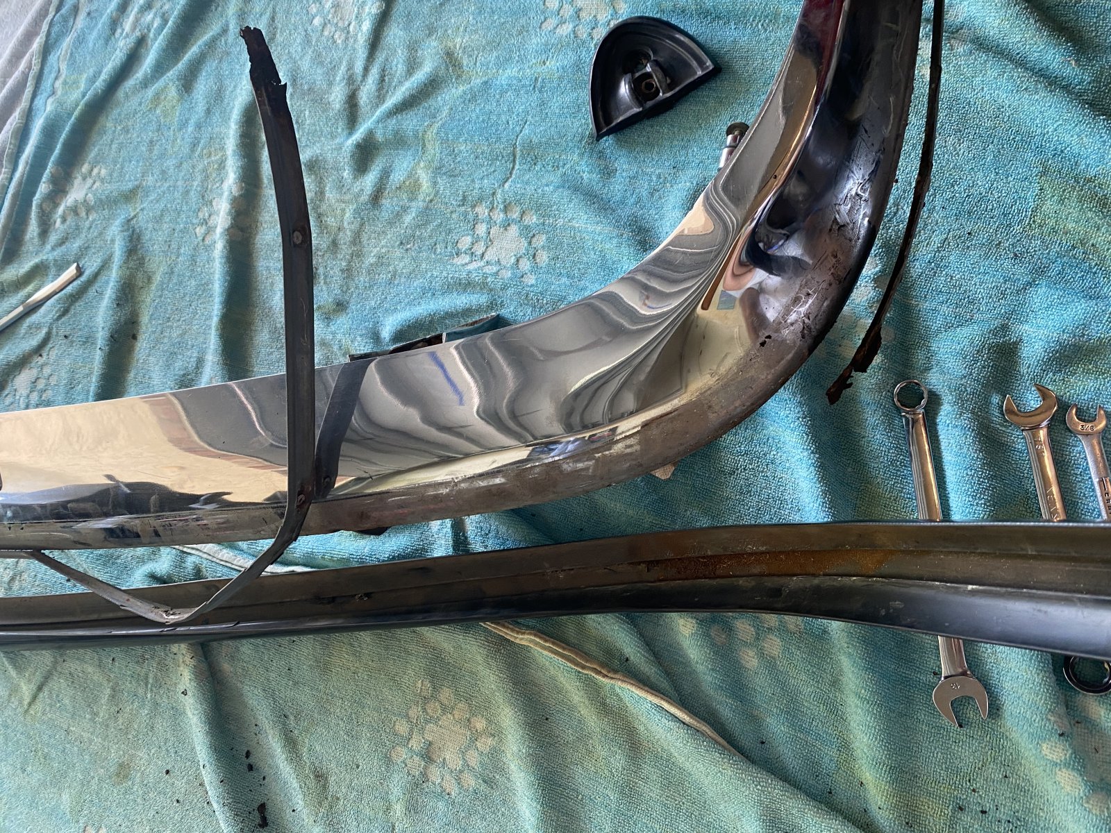

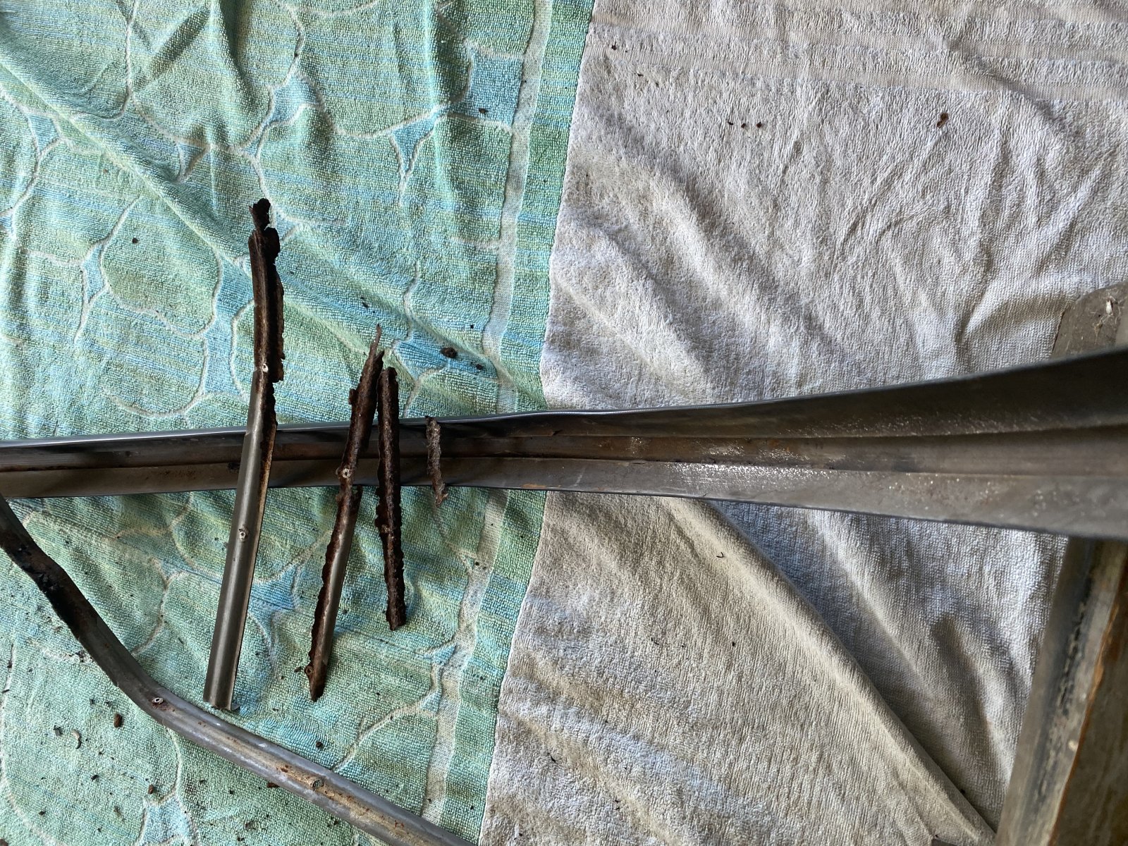

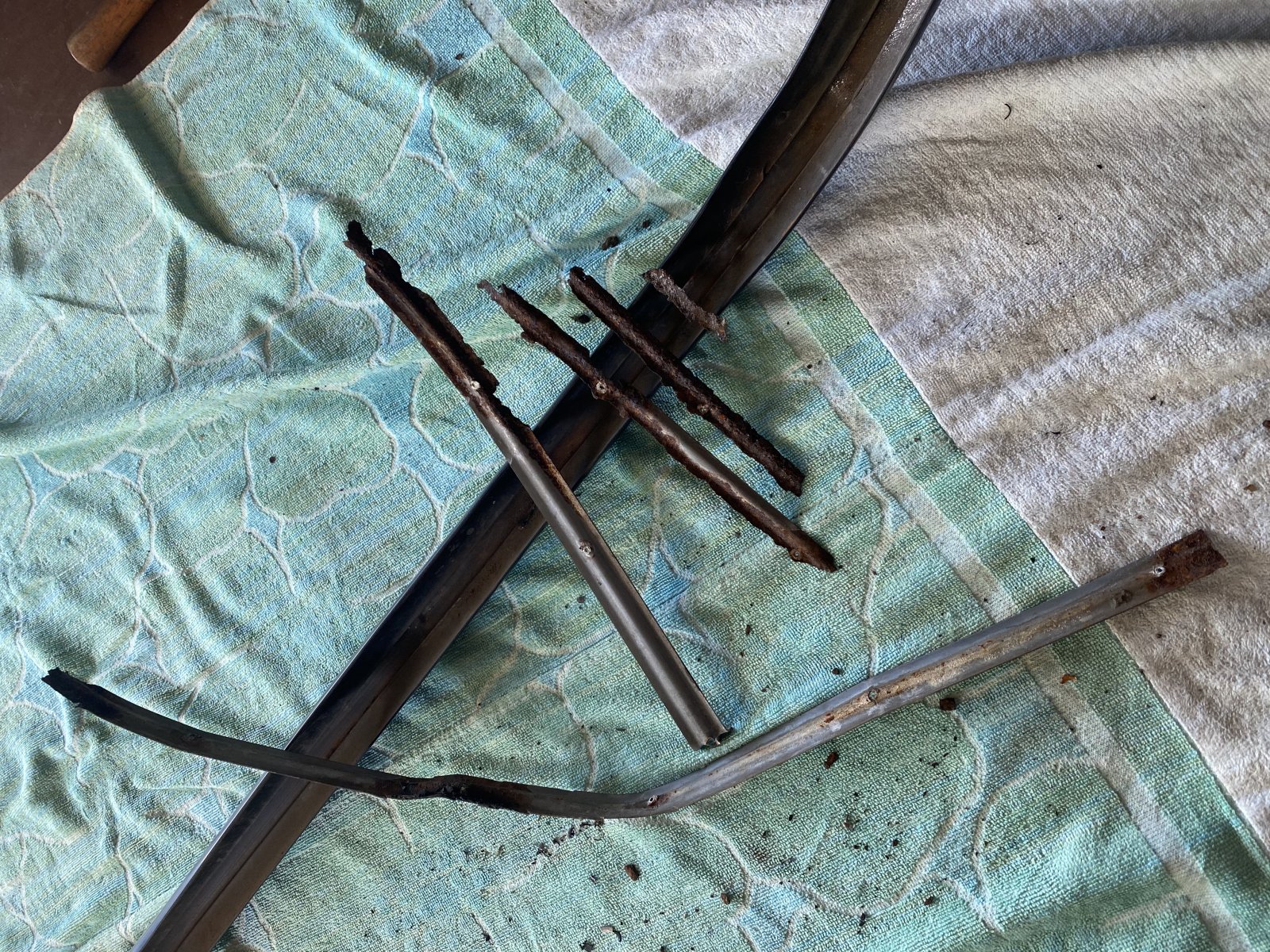

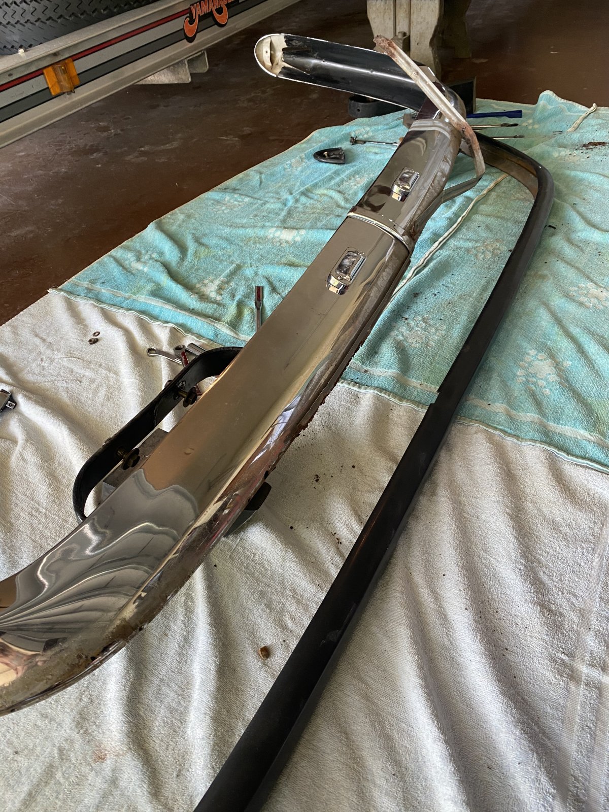

I just removed the rubber from the bumper after the above advice and help from HB Chris and Markos. The rubber is held in place by a galvanized metal strip that's riveted on the center of the chrome bumper. The inside of the rubber has top & bottom slots that fit over this metal strip. Since water can get into those slots when the road is wet, the metal strip will rust away after years. You won't know it until you take the rubber off the chrome bumper. The metal strip is available in the W&N website. You will have to drill out the old rivets and replace them when the new strip is installed. My rubber strip was tight against the chrome even though the metal strip was 80% gone to rust. I wanted to re-chrome the center spacer since the bumper was off the car during a color change from custom blue to Factory Turkis. I have not put everything back together yet,and the rule usually is back together takes 5 times the effort to take it apart. Here are pics of the rusted metal strip removed from the chrome bumper.

That’s a definite problem point. I thought I’d taken a picture of one set I dismantled but alas, no—the actual metal left was a small rusted morsel that wouldn’t pass for a prison shank. In that set, the crud and rust held it together more than any actual metal. If I had a car with original bumpers, I’d check that piece—it is a definite point of cancer that metastasizes back into the bumper.

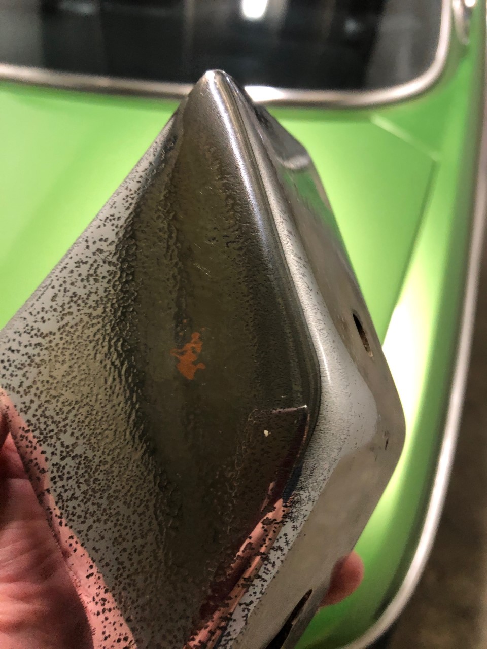

The other weak point I’ve noticed is actually at the pointed ends of bumpers that rust from the inside & leave nothing but copper, nickel & chrome. It deforms by touching the outside. From the great repository of YouTube knowledge, this is pretty common across all makes for chrome bumpers b/c the common position of where the electrodes were placed in chroming and the lack of attention to coverage or protection of the backside of chrome pieces. Upside is they make a great canvas to play with making shorty bumpers w no rubber.

I’ve tried to learn more about chroming, and it seems like a lost art & science where a million things can go wrong to spoil the sauce. Fascinating craft. I’m not sure where my set had been, but they were OK from the outside and it wasn’t until I started to inspect & polish that I noticed the soft spots on the ends. Upon sanding the backside & doing some research, I knew they’d never be regulation again w/o welding & finishing beyond my skillset or economical to hire out.
