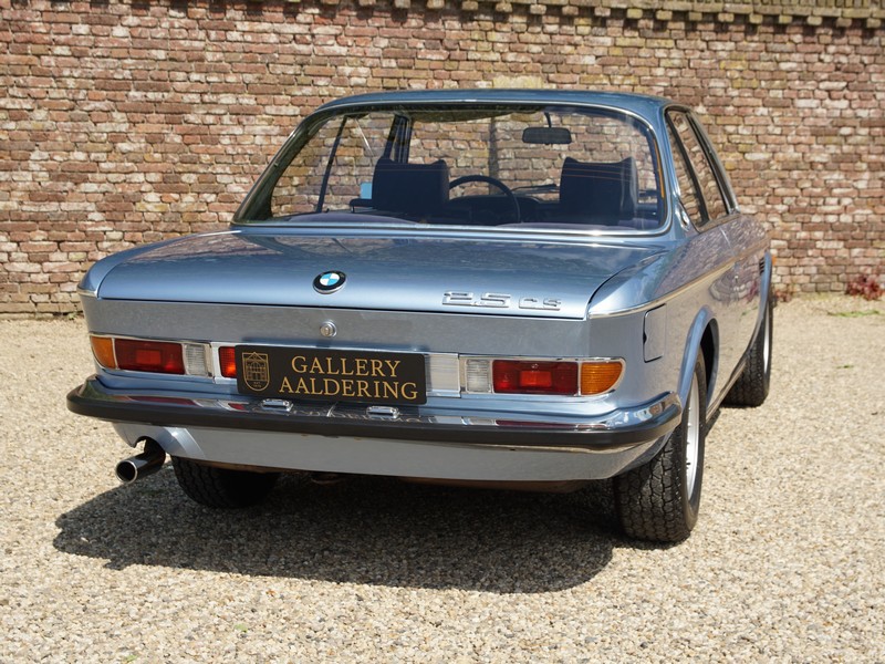

These underriders were an integral par of our Coupe's design with only one exception the 2.5CS were they were deleted to save money.
So unless you don't care about authenticity you really should have them installed. Just my 2ct.

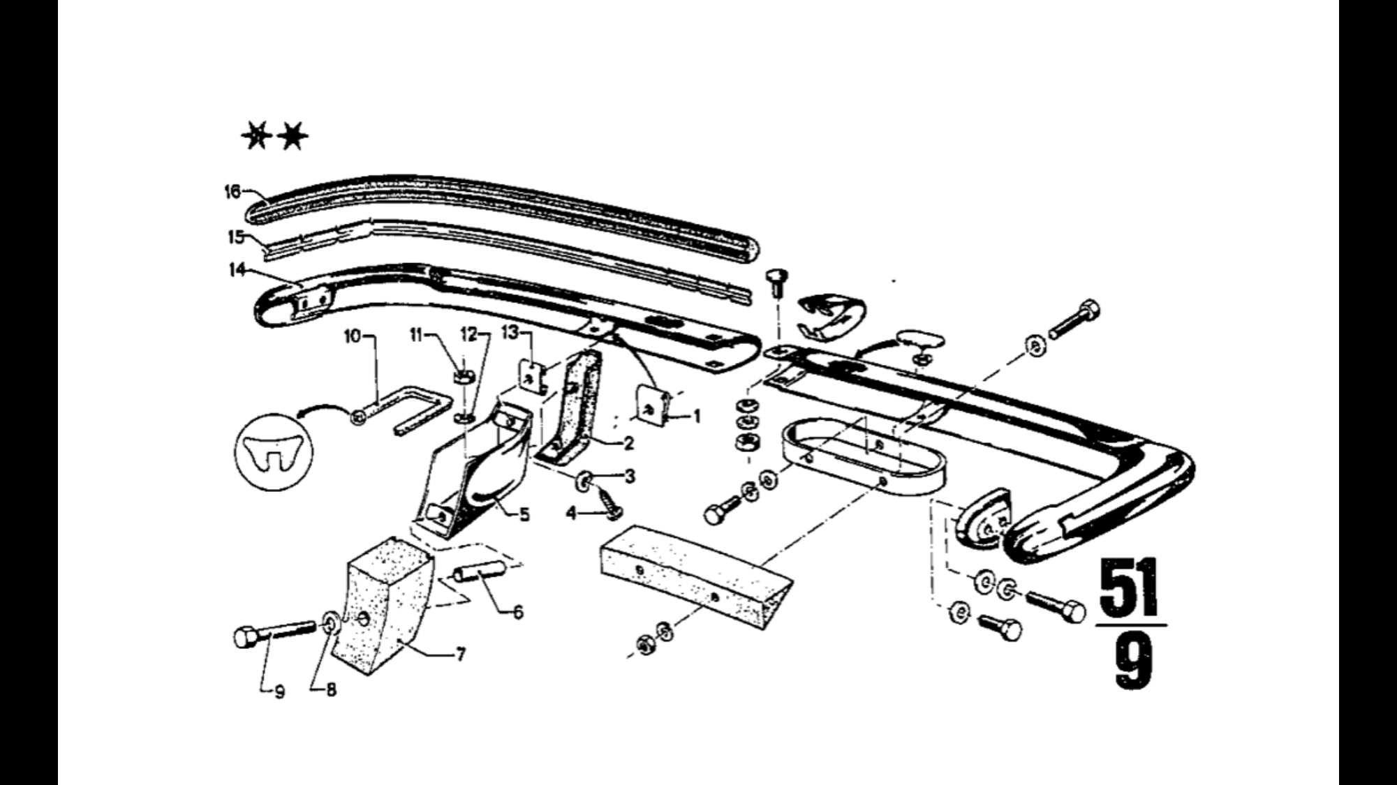

I was researching other threads, and saw Rob's rear valance. That size hole is something I can live with.
Is it necessary to dismount the bumper to attach the underrider? I cannot tell from the drawings. It looks like the underrider gets attached to the underside of the dismounted bumper, then the whole assembly gets mounted with the bumper mounted first, and then the valance bolt through to the underrider?
Markos
13,369
7,503
Seattle, WA
Yeah you need to connect the under rider to the bumper then bolt the bumper to the rear. The rear bumper is easy to remove. Six bolts all accessible from the trunk.

And be sure to thread the bolt through the body first, there isn’t much room between tire well, gas tank and body.

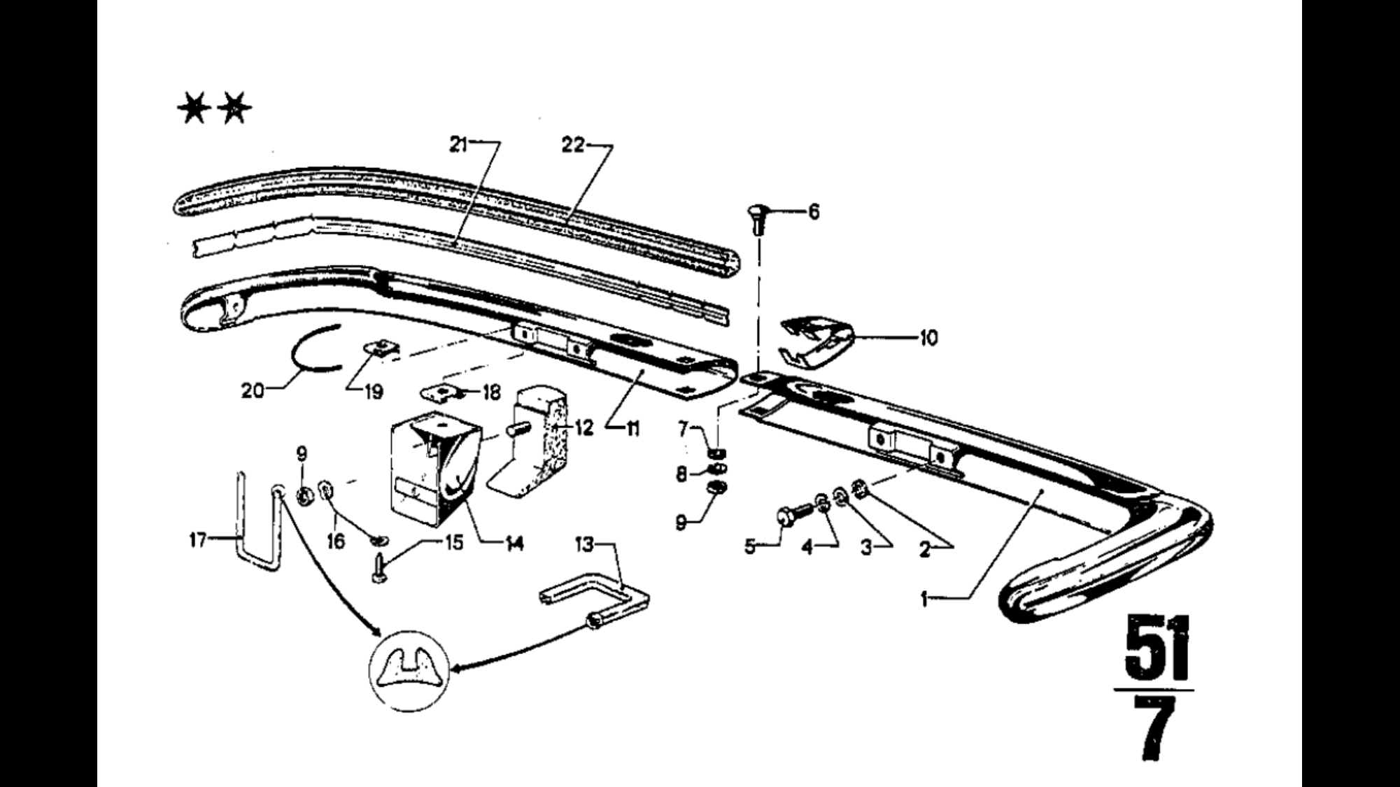

Thanks for the confirmation Markos. I guess I will assemble the parts and wait to tackle lubricating my trunk lock at the same time!;)
Looking at the other thread: https://www.e9coupe.com/forum/threads/e9-rear-bumper-over-rider.26269/
There is a distinct difference between the earlier assembly 51/7 and the newer assembly 51/9. (I can no longer access 51/9 on BMW OEM or W&N)
It looks like I just purchased the later assembly Item #5 on 51/9 on eBay,
which means I need the NLA rubber block #7. Hmmm. I have 3CM closed-cell foam, but that's probably not stiff enough...
Good news is, even though W&N shows drawing 51/7, it looks like the bumper is actually the correct one for Item #5 on 51/9.
Question: Has anyone had experience ordering these assemblies?
HBChris
, I saw you subsequent comment (running dual threads) about making sure to fit the bolt through the valence before re-mounting the bumper. Thanks for that.

The big rubber block is only for US 1973 coupes with 2 1/2 mph interim bumpers. Earlier cars use #17, a small rubber strip. The chrome pieces should be the same, part numbers are the same whether for the chrome or the rubber bumper itself, weird that the pics make them look so different.
Thanks Chris, Markos for the helpful input. A project to add to the list!
