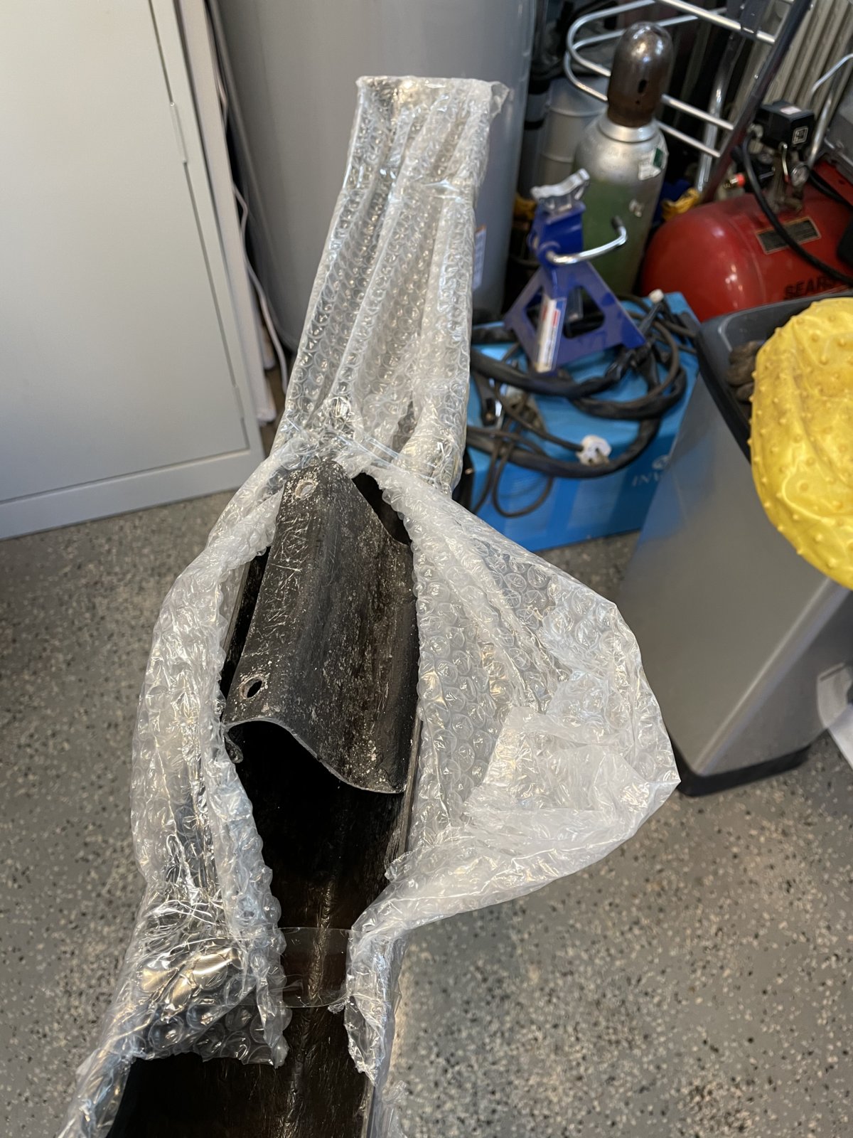

The factory brackets are welded to the bumper and have no separate part number.
I think that coupeguy is the only one who sells a repop CSL rear bumper without brackets. The original CSL bumper as well as quality repops have brackets molded in.
Here is what my zaprace CSL bumper looks like:

Correct with the factory bumpers as well coupeguy will not supply brackets so if is kind a frustrated !
Thank you for the picture ! Did you ever put it on your car?

No not yet. I don’t actually wrench on my car or drive it for that matter. I only buy parts and talk about e9’s on the internet. :D
