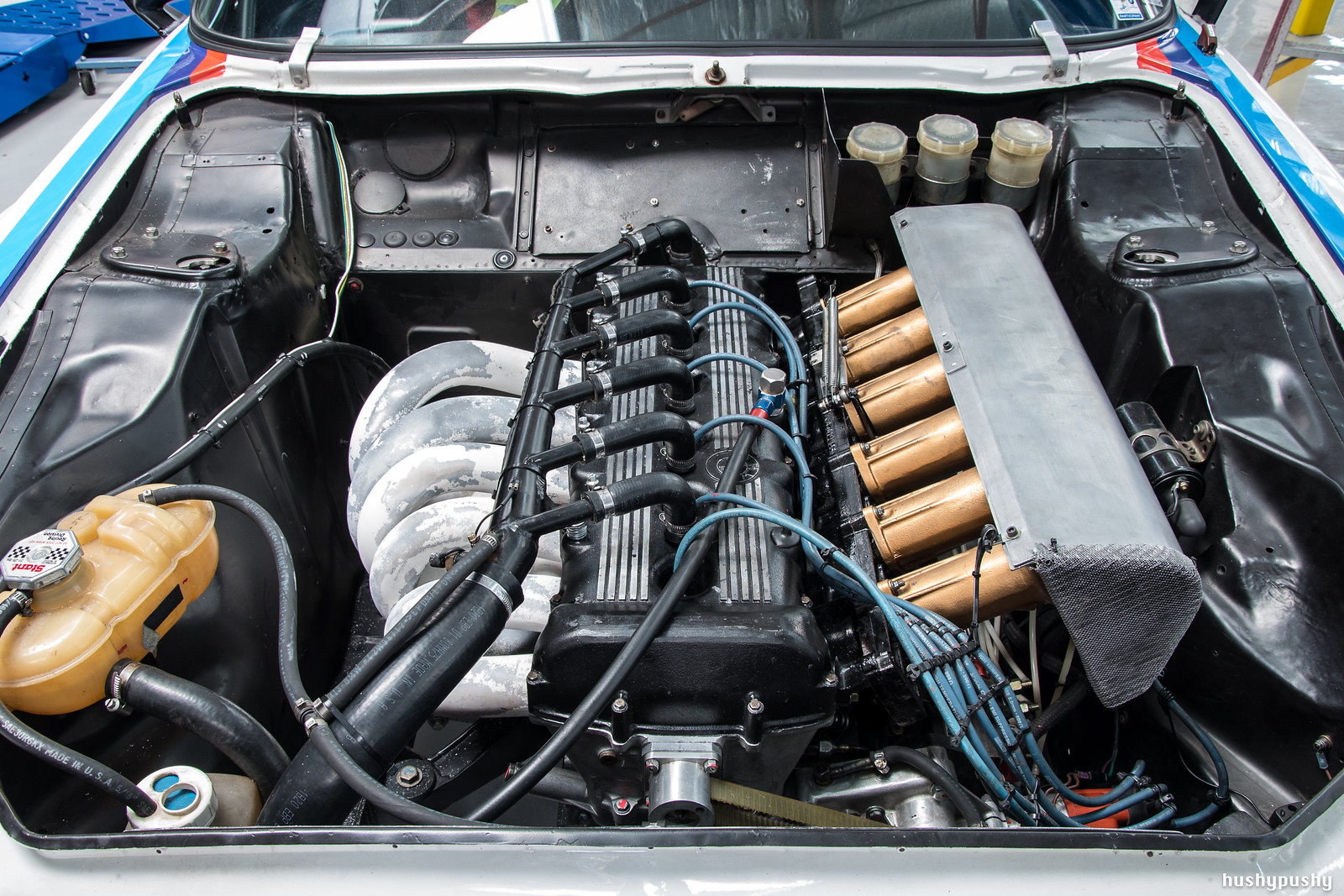

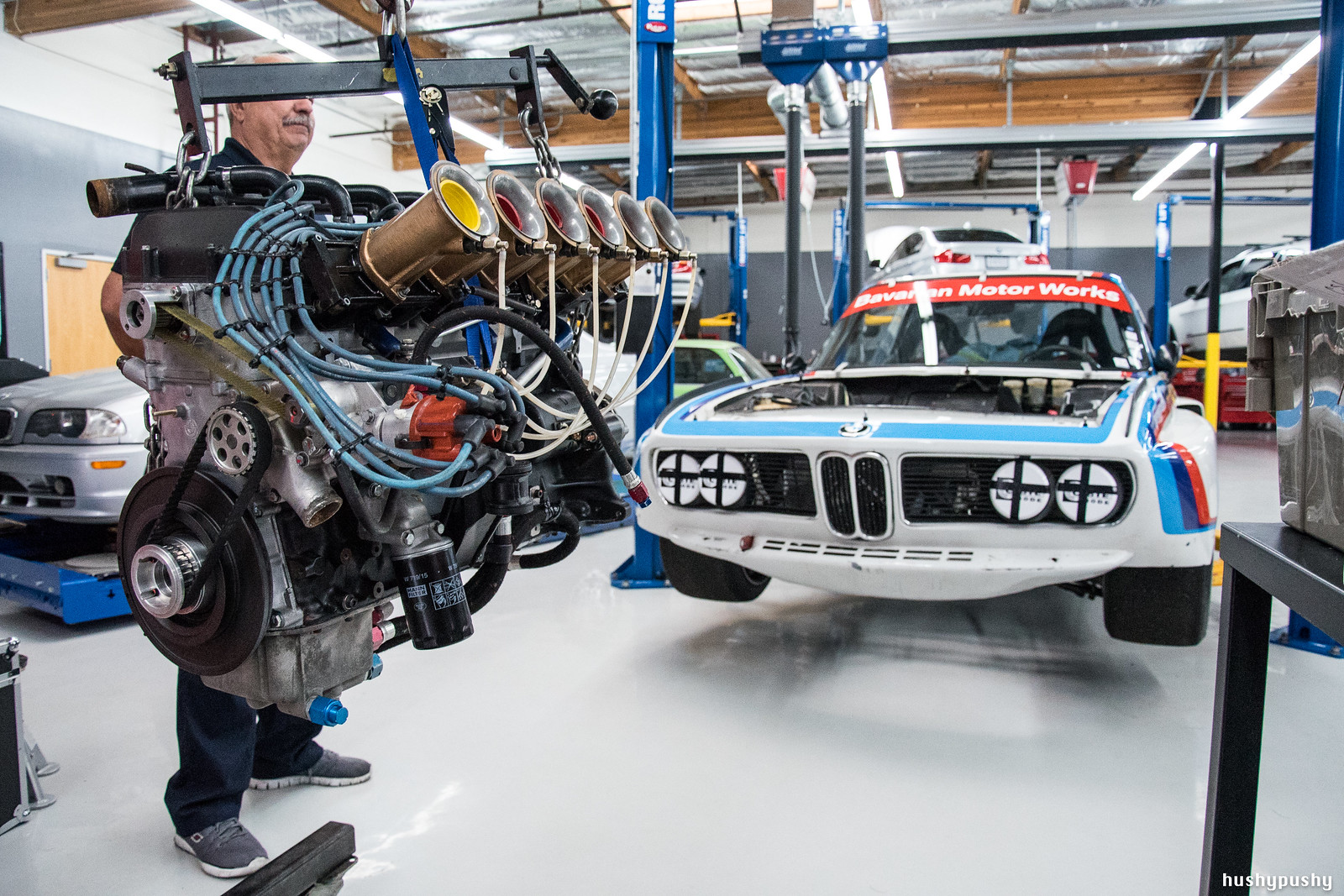

    There's the engine, fresh off the dyno where it made 477hp @ 8500 RPM. It can rev to 9500!

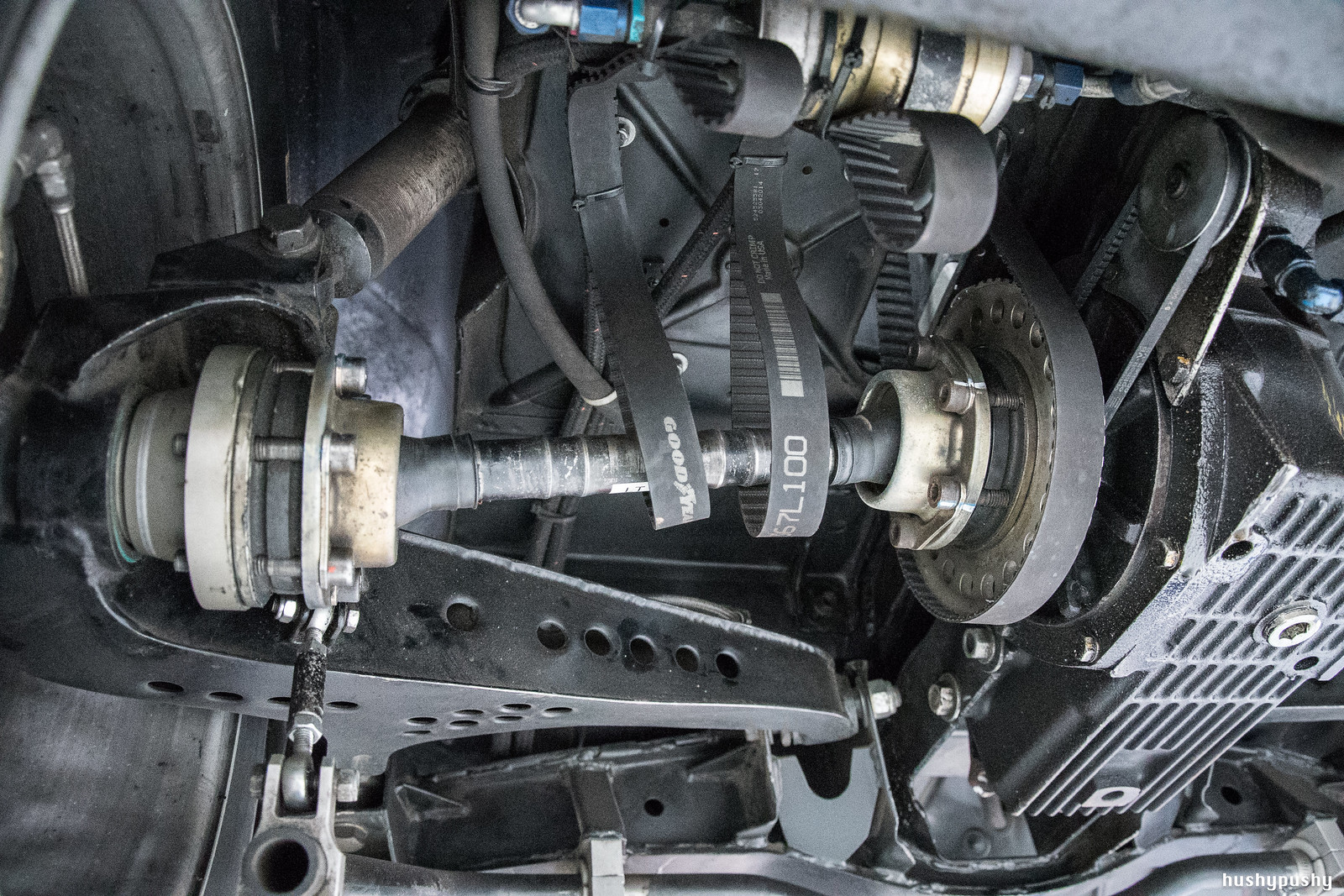

    Check out the extra belts; it's like that so they don't have to remove an axle if the belt breaks. Just cut the old belt off and slide the new one on.

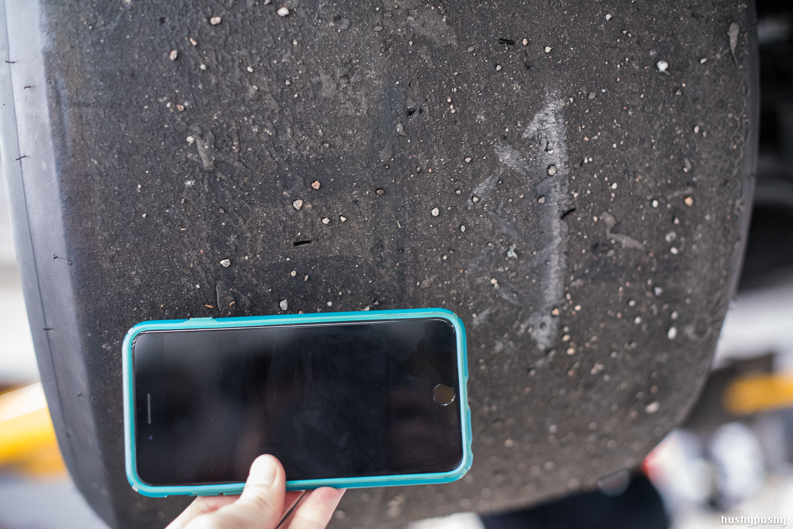

    That's an iPhone 7+, so hopefully it gives you an idea of how HUGE these tires are!

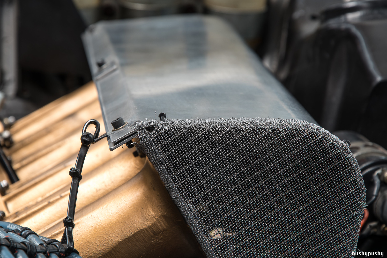

    The "air filter" is more like a "large rocks and small birds filter" :laugh:

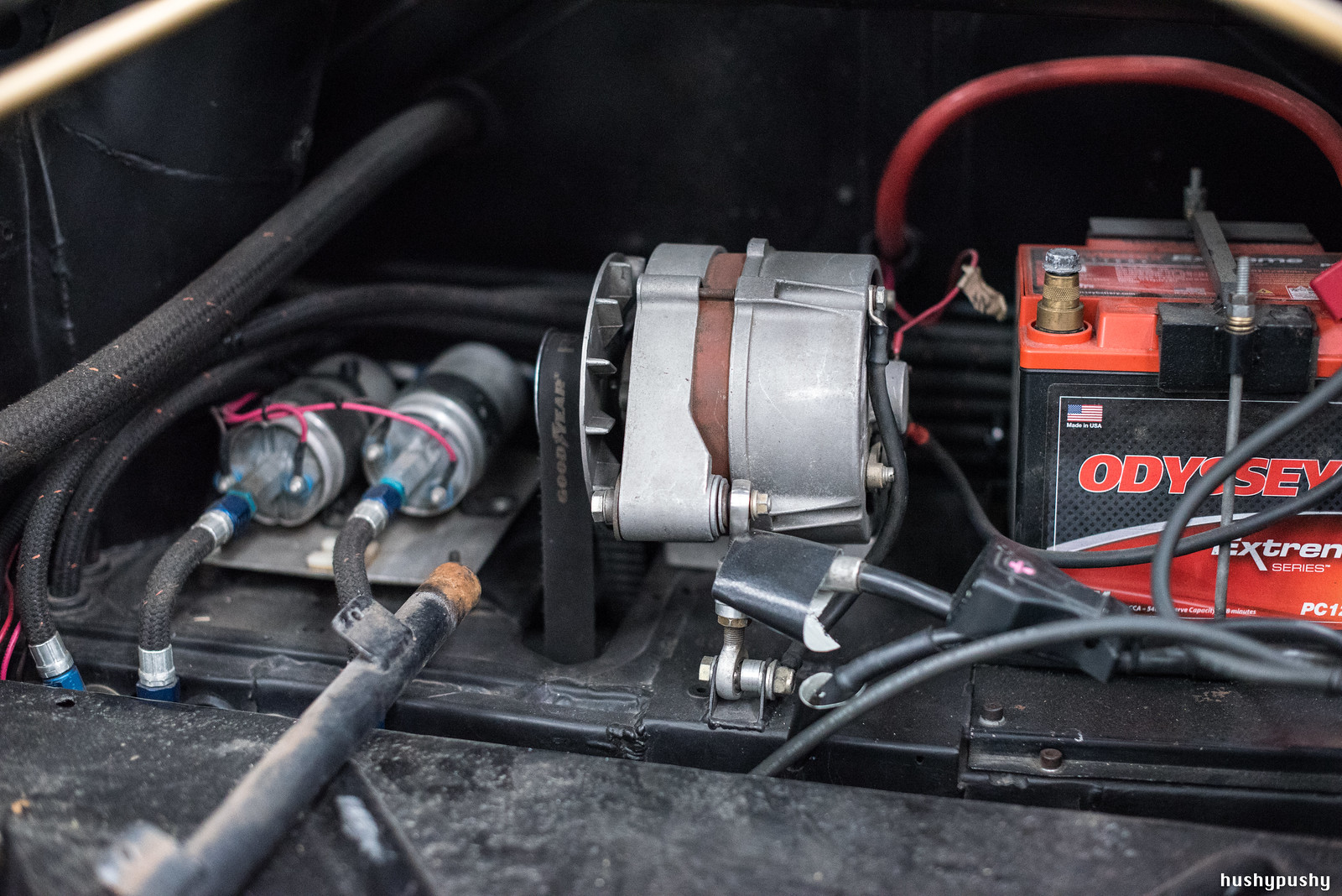

    One of the many thing that are real interesting is that they are running the alternator in the trunk with a belt running off the diff??? I wonder if that is just for weight distribution or if there is another reason.
    There is also another belt going off the diff. Wonder what that is for... Diff oil pump?

    The engine was build at Steve Dinans shop in the South Bay. Not Dinan, but his new independent shop. Built but Stephen Freeth

    I knew about the rear alternators. There is brief discussion of the subject on this site (but very little).
