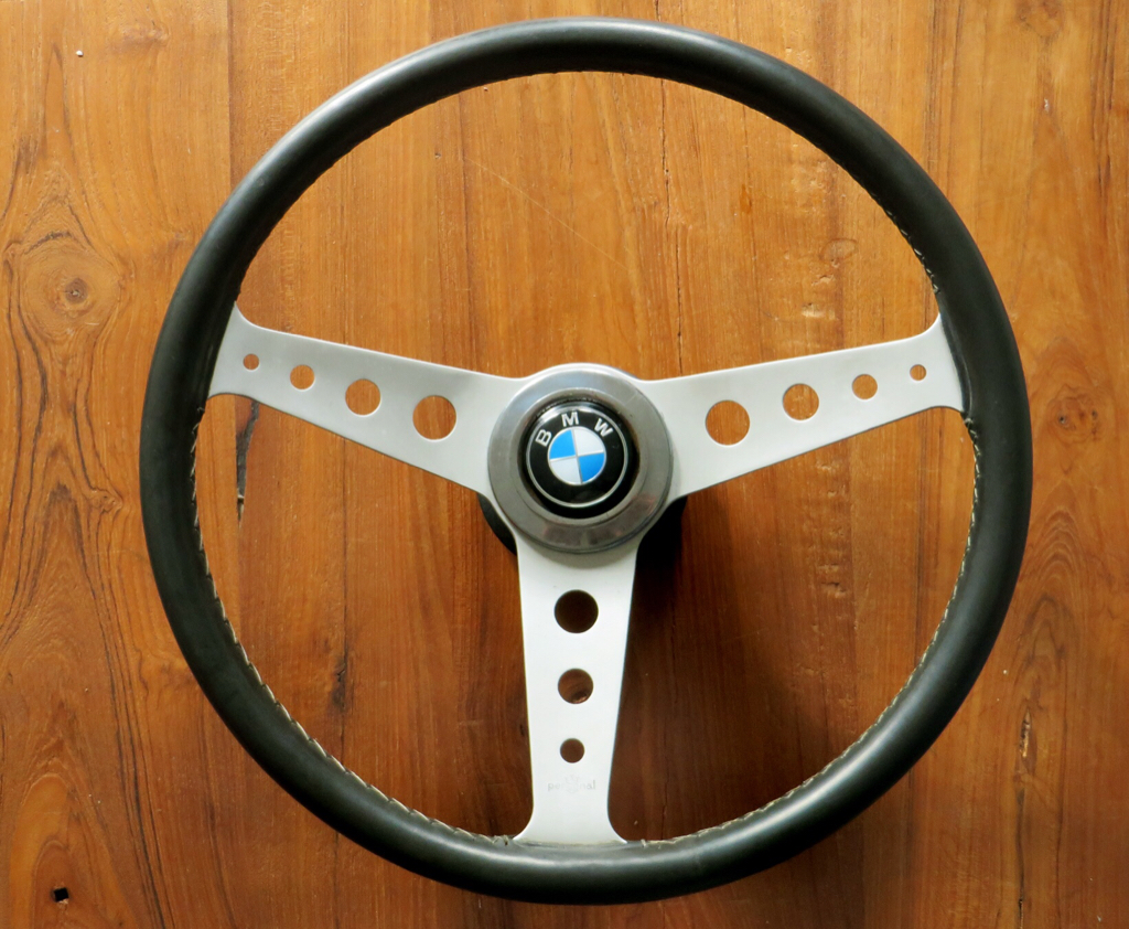

I have a 380mm and 400mm Petri wheel that both needed to be restored. The metal spokes were blistering, the foam was pitted, and one was a little bent. I initially wanted to have the spokes re-nickel plated leaving the foam in place. My local shop would not do it that way. They said that the chemicals would get under/into the foam and continue to leach out. So off came the foam. Unfortunately, when you do this the wheel needs to be wrapped in leather to cover the glue seam. There might be a be way to paint the foam to hide this, but I wanted the leather wrap anyhow as I find the foam by itself makes for too thin a grip.
The wheels as they came. This one is the 380.
The foam coming off. This involves carefully cutting a slit along the inside radius of the wheel, then carefully prying off the foam.
The 400 foam came off fairly easily. The 380 was stubborn and I tore it in a couple of places.

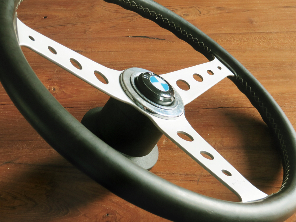

The wheels back from the plating shop.
Then glueing the foam back on. I used the Gorilla glue. This involves wetting the surfaces as the glue reacts with the water and expands. I also used this glue to fill in any holes in the base foam, then sanded. I initially tried using tape to hold the foam in place while the glued dried. Not even close to being strong enough to keep the gap closed. I used some stainless steel wire I had and tightly wrapped the entire wheel.
Sven
1,145
110
Seattle
Lastly I restored the one horn button I have. I took it apart and painted the back side with blue, white and black model train paint. Patched and painted the outer ring and put it back together. Almost like new. Getting it apart required carefully prying back two of the aluminum tabs.

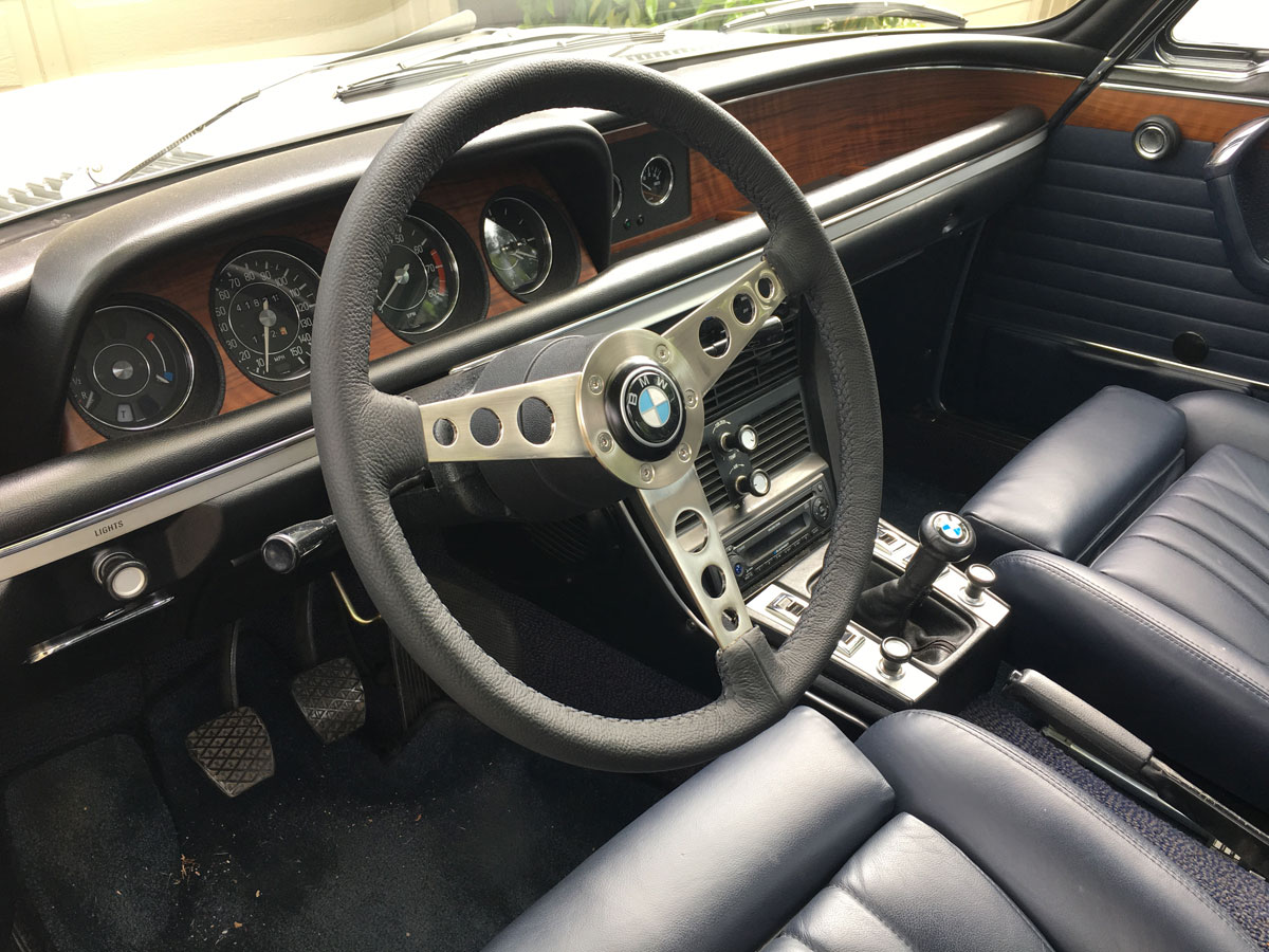

I almost forgot the most important picture. The 380 installed. I first had the 400 mounted to try it out. I felt it was maybe a bit too large - but I would certainly be able to live with it. Leaning ever so slightly to the 380 for now (which is already larger than the Nardi I have been using all these years). My wife's comment when she asked me about all the wheels laying about - "I think the wood one looks much better". I think she is right, but the Petri feels better for driving.
The looks sooo good!! The interior on my '02 looks like the mini version of your coupe's.
