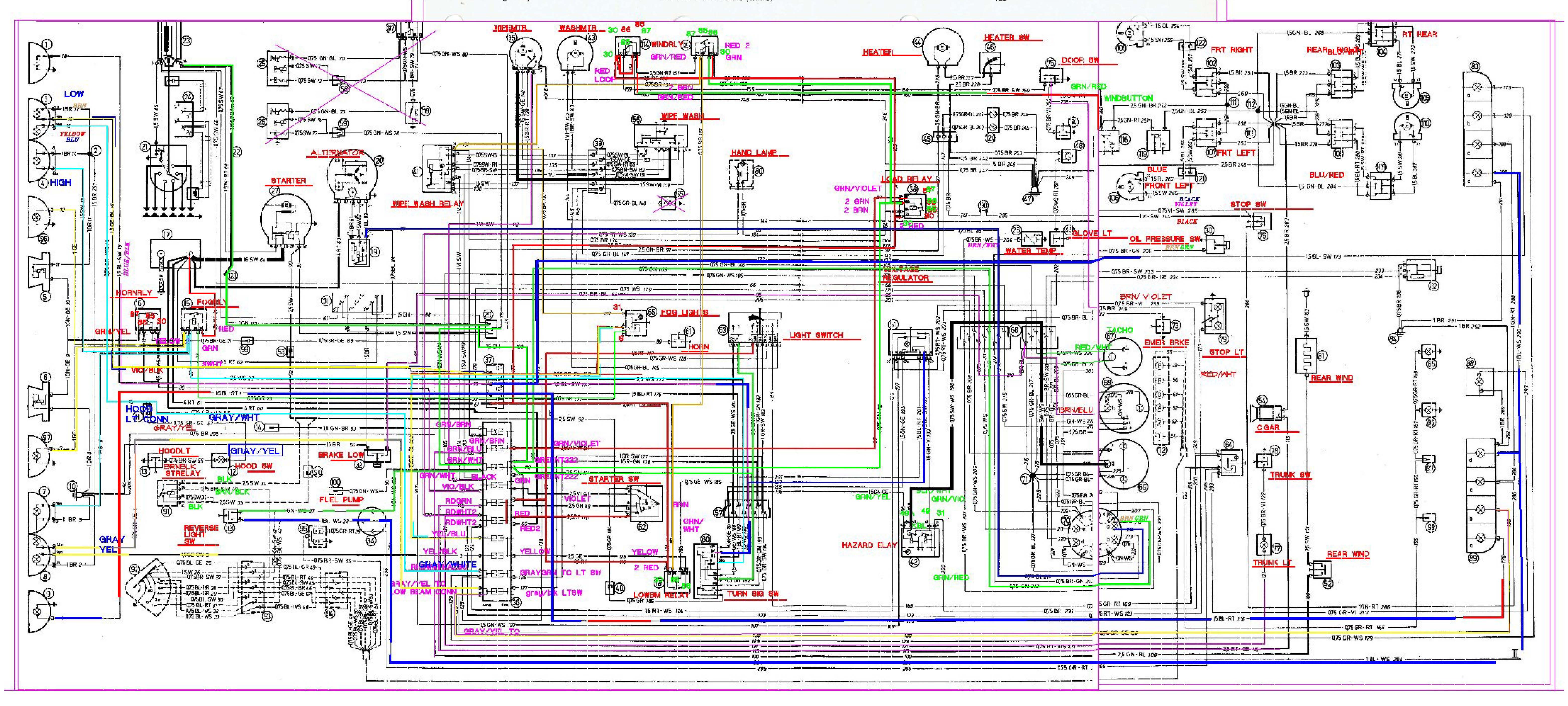

your best bet would be to get the used 74 parts
the rear window switch goes to the console
heres the wiring diagram
