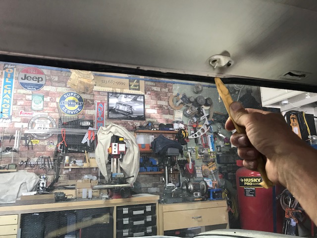

Minds out of the gutter, please....I mean my windshield rubber...:) So I finally sat and looked at the rubber gasket and found that it was very easy to remove the windshield and gasket without damaging either one. If your gasket is in good shape, go for it. Yay!
Looking at the pics, I just folded the rubber lip edge around the metal frame on the inside top and sides...after that the windshield just leaned right out...no trouble whatsoever...so glad...with the stupid NLA gasket drama behind me, I can move forward on body work..Happy day..
