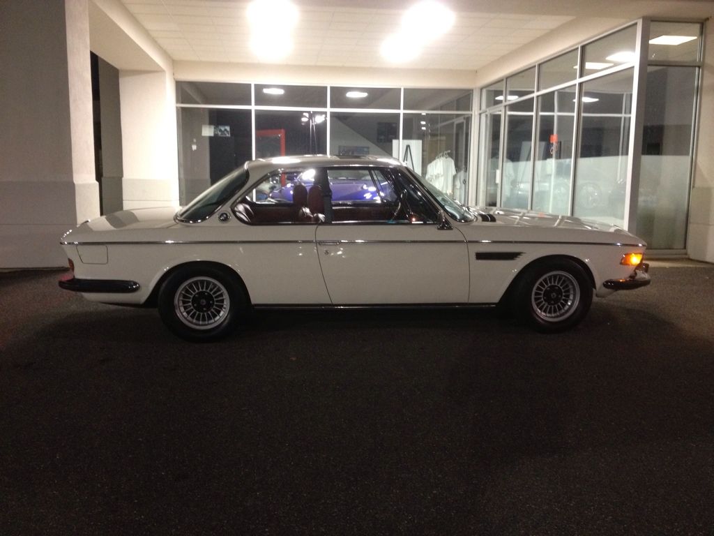

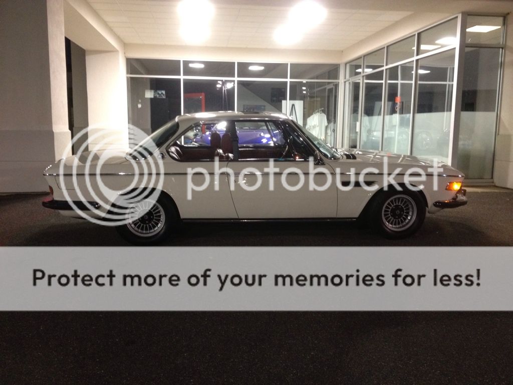

Stan, that is a nice garage though carpet probably isn't all that practical. From what I was told, the ST springs were a little firmer than the new LJI springs.
Take about 200lbs off the front wheels and your height will look like mine.
Hahaha, not a carpet, a nice new paved driveway at the BMW Dealership in NH.
