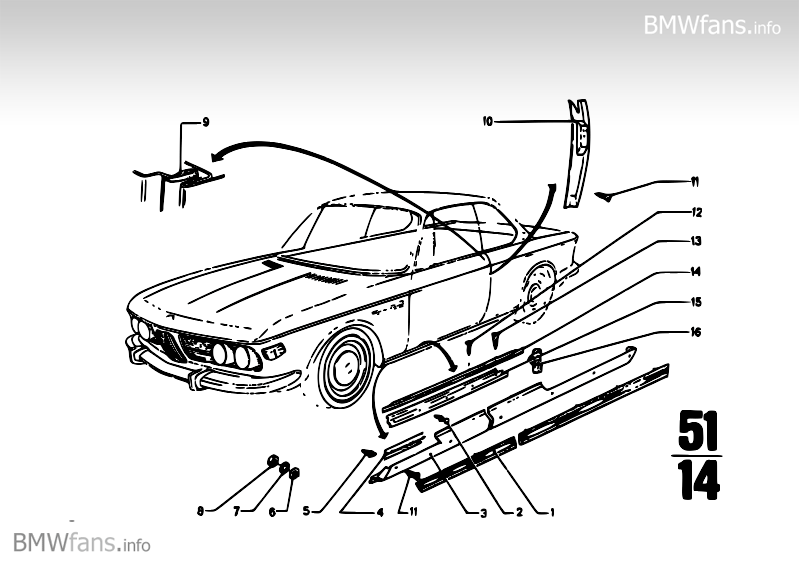

No, the covers are shown on a different "page". They are #3 on this diagram:
http://www.bmwmobiletradition-onlin...el=3435&mospid=47811&btnr=51_3430&hg=51&fg=20
The diagram in your link shows the 3 structural parts.

#1 is the moulding. We are refering to the actual metal welded to the car.

Ok, now I am really not following you. What is the "outer" decorative and what is the "outer" structural panels? Can you use RealOEM and maybe some pics to illustrate which are which?

Confusion--ORC--is non-structural
#1 is the outer s/s with vinyl insert strip that is decorative--and attached to the ORC
#2 & 5 s/s screws--correctly installed ORC is screwed in place--screws go into upper part of structural rocker--then screws covered by the outer s/s threshold trim strip--plus screws at front and rear edges of wheel well openings--some have pop-riveted the lower edge of the ORC to the lower edge of the structural rocker
#3 ORC--original was covered with a rubberized texture bonded to the underlying mild steel of the cover
#4 short seal that goes between the ORC and lower part of front fender--there is also a longer seal--? not showing--that fits similarly from the rear edge of the door to the rear wheel opening
believe this may shed light on the confusion re the ORC's decorative role
BTW--the ORC--does a great job of collecting and holding silt between the inner surface of the ORC and the first layer of the structural rocker--then the presence of any moisture turns that silt into a mud pack--the result being an almost univeral rusted condition between the two pieces as many of us have discovered or will discover when the ORC is removed--having learned this--it makes a strong case for avoiding pouring water over the top of your Coupe or driving them in the rain once they are renewed to fine condition.

7,8 and 9 in the above link are all structural, 7 is not normally seen due to the non structural cover. I think what may be clouding the issue here is if someone has come across a car where the non structural cover has been welded on as in the case of the first ever CS I worked on. It is on reflection an easy mistake to make if you are not familiar with these cars.
