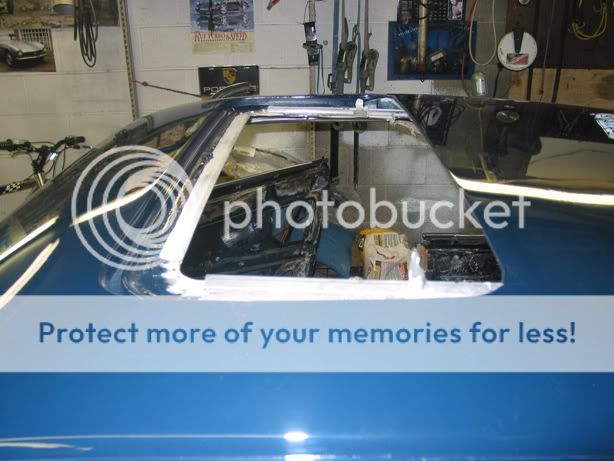

Hello all,
I am in the Paint phase (which I believe follows "Bargaining" and "Guilt" in the 6 phases of coupe restoration) and have found the causes of the paint bubbles on the roof behind the sunroof opening. There appears to be a piece of foam sandwiched between two layers roof sheet metal there. Over the years I am sure this sponged up any water that found its way into that part of the roof through condensation or seal failure. I am wondering if this is evidence of a clog in the roof drain lines. In the meanwhile, the restorer has cut out and replaced this entire section of the roof since I’d hate to repeat this process in 5 years.
Note the rusty spongelike material I put by the taped section.
Here's the latest from 2/9/2009
Now all done

Can you explain how you attached the new metal and how you prepped it? It looks nice by the way.

Metal attachment
Chicane,
I personally attached the metal by writing a check to the body man. :D
His technique was to cut back and bend down a section of the roof and then glue (yes glue) the new sections onto that lip. The new metal was held in place, while the glue set up, by screws that were ground off later.

That's what I thought. Very cool. I know the M3 CSL roof is glued on via an aerospace quality epoxy. Do you know what type of glue he used?
Actually it is quite smart. I imagine he chose this path because welding could have possibly caused warping to the metal which would have created issues with the sunroof.

Sunrroof Painted
The car is back from the painters where it got a touch up around the sunroof (my mechanic is VERY particular).
Here's a picture (pre-headliner replacement).
