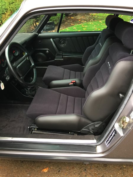

Hoping someone could advise on how I can source this piece. I beleive my seats are the 400 model but I’m missing an inner plastic piece.
I realize these seats have been discontinued for some time.
Any leads in finding this part?
thank you!

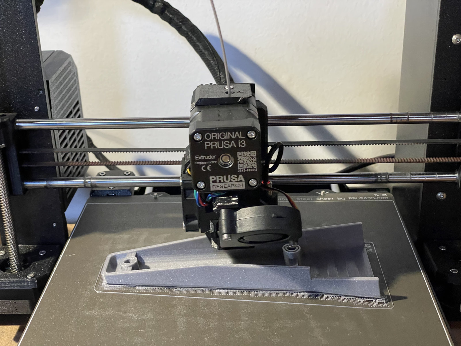

Hello Andy!

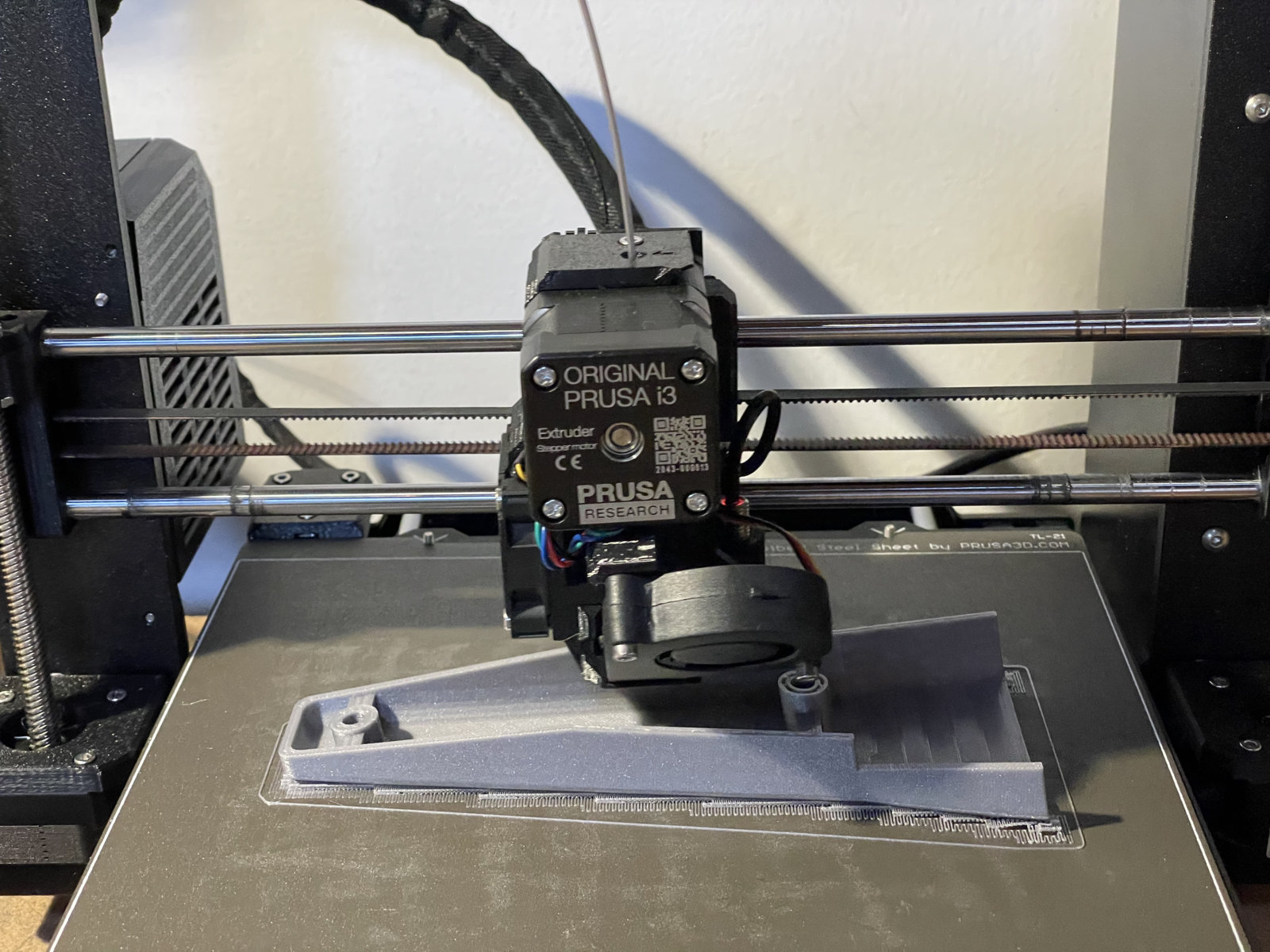

The printer has been hard at work!
I have had to cut the model into two pieces so that it can fit on the print bed. Attached is a photo of the first half.
The final model will have a thin coat of bondo which will be sanded down and painted so I am not too worried about seeing any print lines. I am hoping that the first iteration is perfect, but unfortunately it rarely is...
More to come when I have updates on the part!

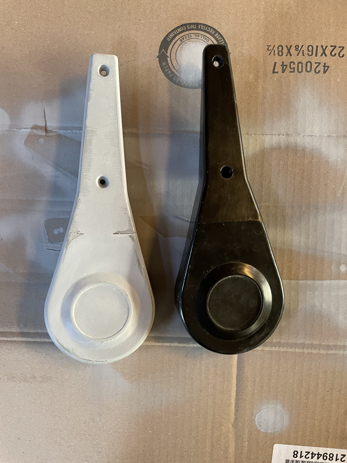

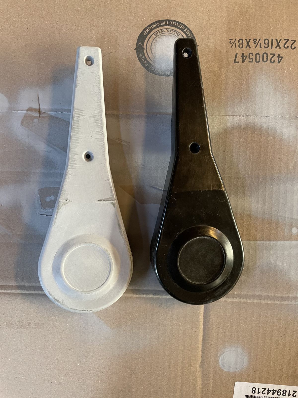

On the left is the 3D Print versus the original on the right. I am still trying to get the right level of gloss, but I am happy with where it is going. The image is capturing it in the best possible light haha.
If I were to make it again, the big change I would make to the 3d model will be the top. The original has a little larger radius than I calculated.

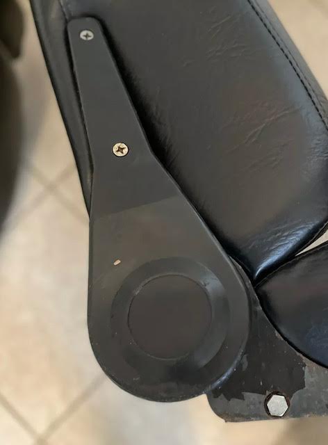

Do you have a good picture of what you are making...I might be in for a pair if they match what I have..
The same as above, Dave. Here is a picture of my one 'good' plastic cover that I will use for scanning. (its from a Scheel 200 series, but would guess that they are all the same?)
