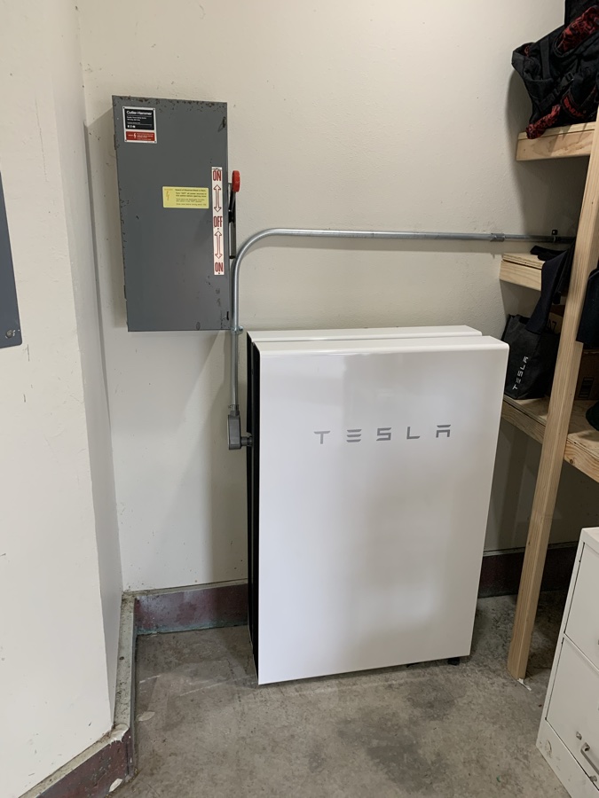

We just had a 7.2 kW Tesla system installed on our newest house. This time we included two Powerwall batteries which can store up to 27 kW. This means that during the day the solar panels feed the house and recharge the batteries which then power the house at night. These days, with the lockdown in place, there is something really comforting in knowing that even if the power grid gets to be disrupted we are completely independent of it.
EC329B3D-B7EE-4EB5-8762-A062FBEB1B3C.jpeg FBF8EB47-C6A8-421F-81A8-8498E653FCAA.jpeg
Cost wise, the system retailed for $35k including installation in December 2019. It came with a 30% tax credit which we got back recently, making for a net cost of about $24k.

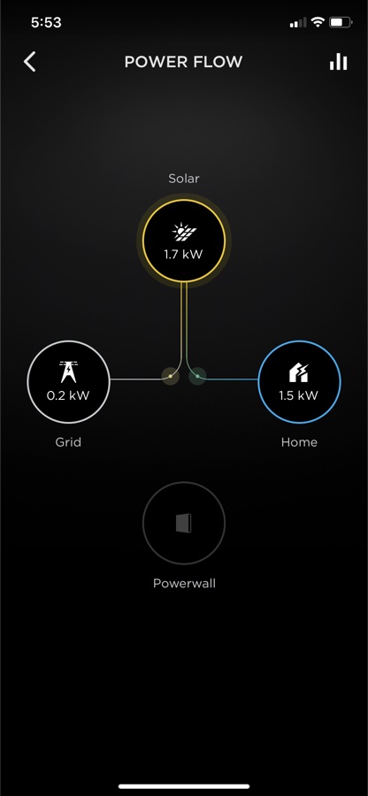

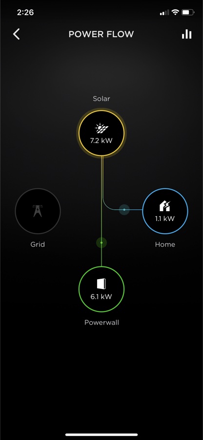

During the day the system powers the house and recharges the batteries.
When the batteries are full, it sends any excess power back to the grid.

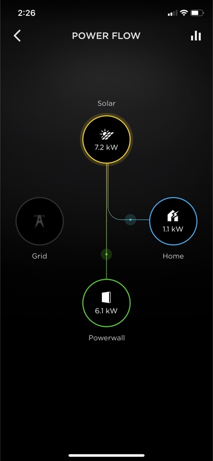

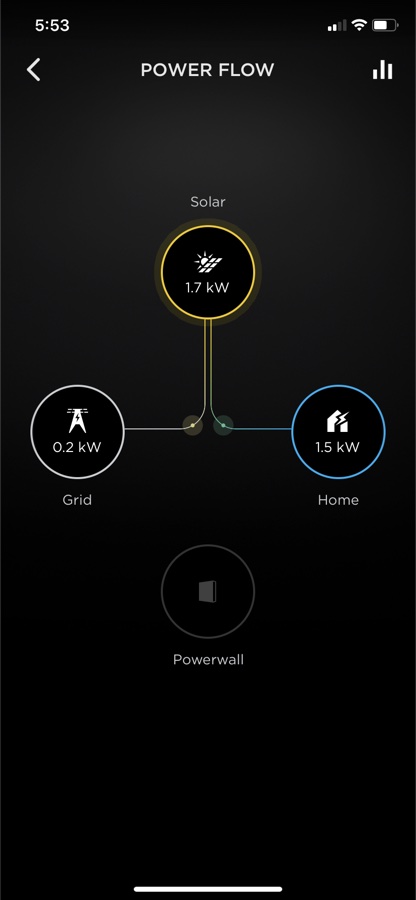

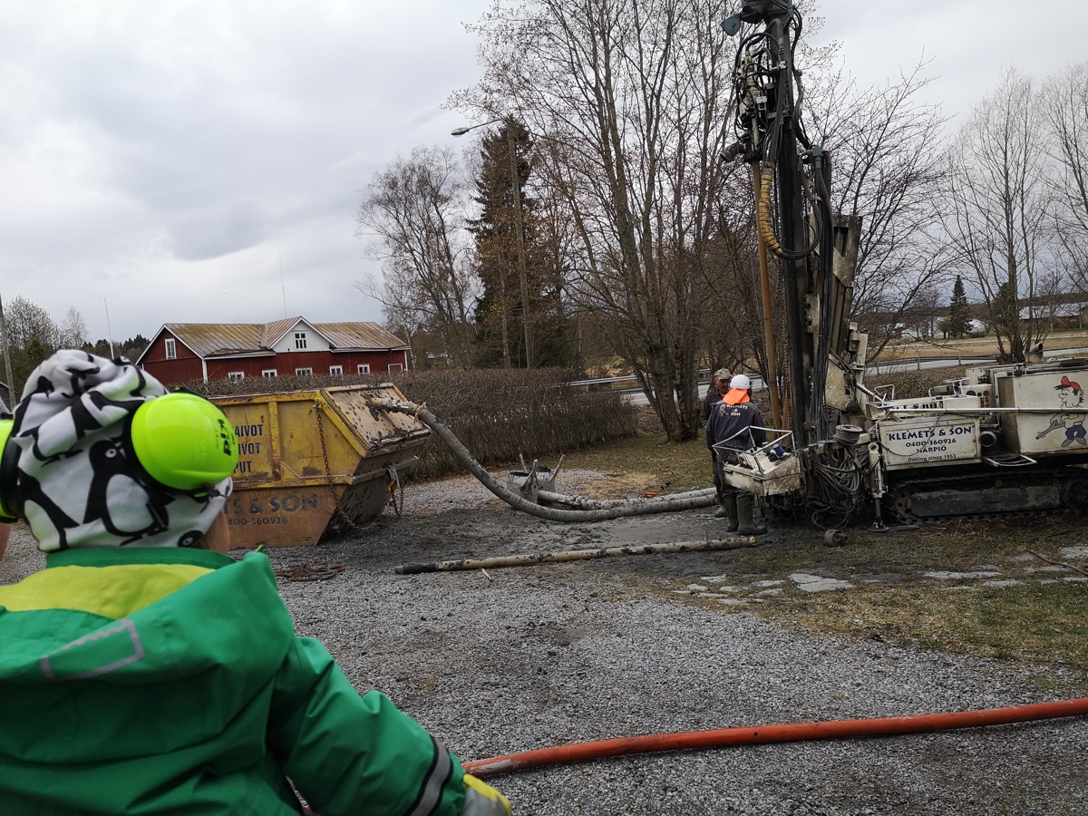

Part of the problem is that we don't have enough room to do a horizontal system and that it is rocky terrain. Therefore drilling straight down is difficult and expensive.
Over here we have an average of 6 meters until you hit hard rock, that's what they estimate if you get a quote.
The funny thing is, it's much more expensive if you have a deep layer of dirt until you hit rock, because that upper part of the borehole needs to have a big thick expensive steel sleeve inserted to prevent the water pipes from getting crushed. So at least here, drilling straight down into rock, is cheaper than drilling a borehole through a layer of dirt.
It usually takes one workday for a small crew to come out and drill, put down the sleeve, dig for the pipes and finish everything off, then another crew comes out and installs the pump.
Drilling action + installed pump at my parents:
