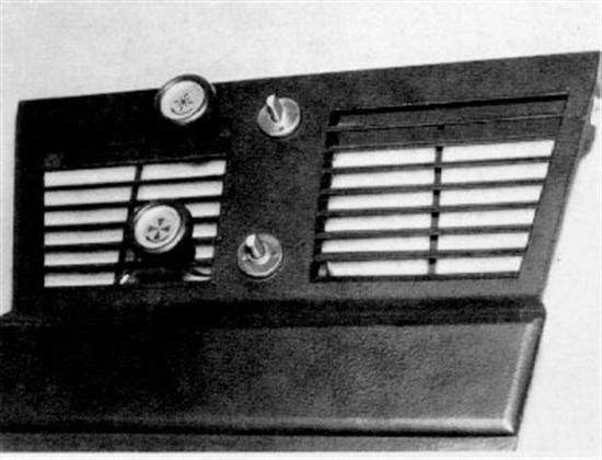

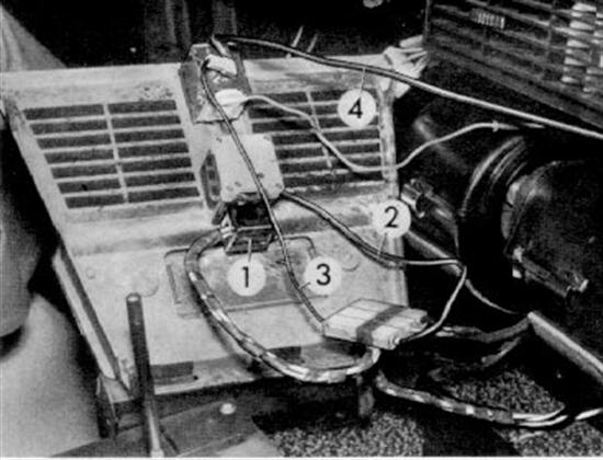

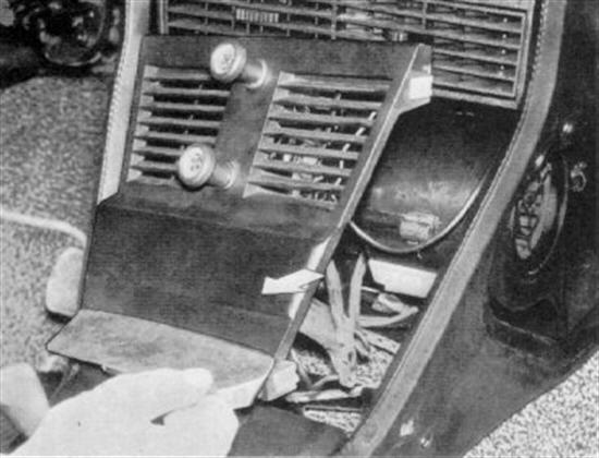

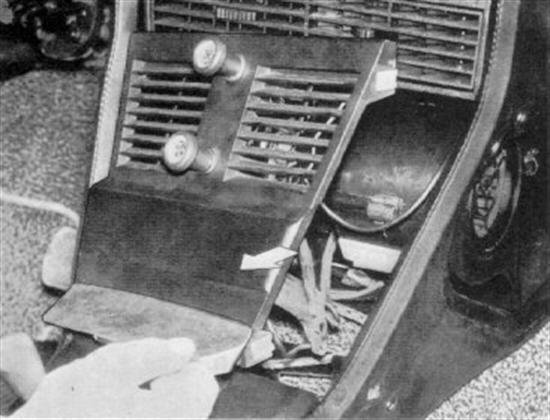

You actually have an e3 AC face plate in your car, modified with a closed opening. That is why the fitment is poor. There was a “no radio” option. I just posted pics of the face plate as seen in the blue books. The pictures aren’t great but as you can see it appears to have a cover panel.
You have a few options:
1. Modify your existing face plate for a radio cutout. You will likely need to move your plate upwards, as the radio opening is way too low. If you go this route I have the template for a becker opening. I know that @aearch modified an e3 plate.

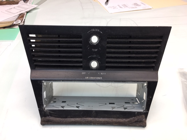

2. Find a used e9 face plate. Several e9 members have one, but they aren’t listed. Try posting a WTB ad. A used one in good shape goes for $400 - $600. You may also find one that has been gouged for a DIN radio, for $100 - $250. You can either fix it or if the opening is small enough, use a decorative Blaupunkt cover plate: @Enoz sells a lot of radios on the forum.
3. I sell 3D printed versions for $225 shipped and painted. They are made from plastic and not nearly as heavy dufy as the original cast aluminum ones, but they look the part and get the job done. Also @m73 sells the AC decals. I also have a prototype that I can sell for about $25. It was the first draft so fitment is “meh”, but likely better than your e3 plate.

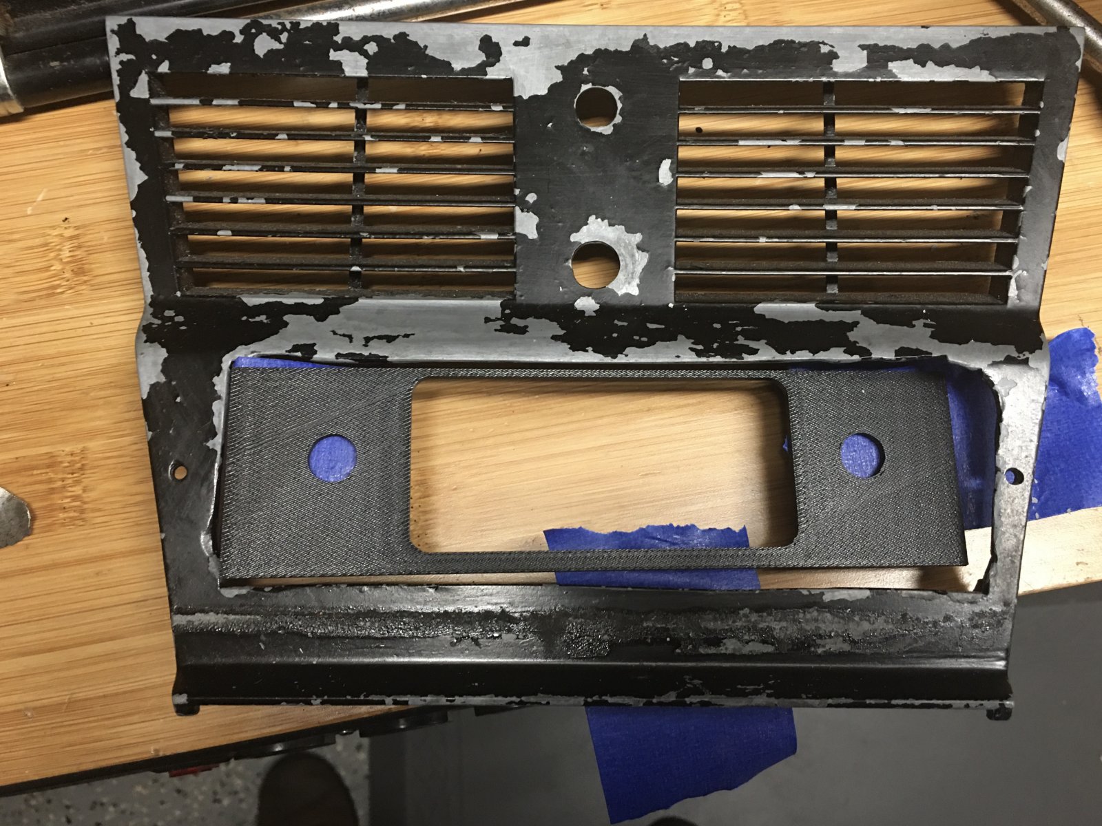

I am working on an aluminum repair plate. I need to make it bigger as seen below. This *is the blaupunkt template if you do want to cut out the opening on your e3 face plate.
