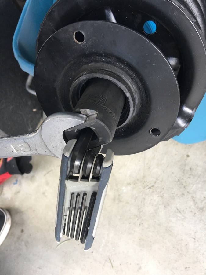

First things first, I will tighten the nut as soon as I can find either an impact gun or the special socket that allows me to tighten it by hand while holding the Allen key.

I made one of those tools by grinding down the top to fit a wrench:
KUzaLZkMjZgAVWG8g0eQJss31E4h0SZQNLCuh9xxSZM8IWlAPedRTAHuNckzqZVEO2YTXTbSC0tXwR_KvDyKmA8MdrZwT01fAbSe1DhiXXYB1D29OzTI73eaS8QyAs-b7dX-Y6_FnxTGLT5LhUsBUTtxr5iC_4LJZo3FIzUjyYN9Xc4JC-SPVWlEFktlHOiqkxC9ZjHcFyFDgN_a6cTf9h5aKSgG2_9oPQ5RsNqbUmRGQvQMlKwVzpATYymLLCc4vLmNG2h8B7F-yt4IgC6bHImnOMygzI6GlCS4Mx2mqZO8QCDIIJqNWU7hl6jVR0u58znFtHQg9OWbObj8BGcPSqcq6J5c9ojKpzTw2SWybTBUE_lmQiyQI46_qtrkxxvWumxEC9p47pNZy1NCJIhUyQpajQeJ2WHh_8x5AIoDMCsI0TAmK4tBCdv3TSTccMeXP2oLD685cd2u-BpRWJuYevpvhUXjwexsdCVHAMjx5mXXnUGqA6-Ul0V4Ylvf8aQnNUkXVWemLvB80-UNJqyRGhHJnlYPk_2nh4s9-oWYVJPIFMYOW_mylqX10mEXB8sBr1gSdIEJKe7BZY1bhomJwVh0b_eQPDHuTmbcyNT1ZdHW9fB1KJgYcvlijJfCwG7G1ezOzWo0sP6j55a1qBTVvDM5ztmlA9w=w1024-h768-no

Thanks very much for the offer, Steve. But I have a friend who is bringing a battery powered impact gun at Chris' Huntington Beach concours tomorrow. Hopefully we can fix the problem right there!
