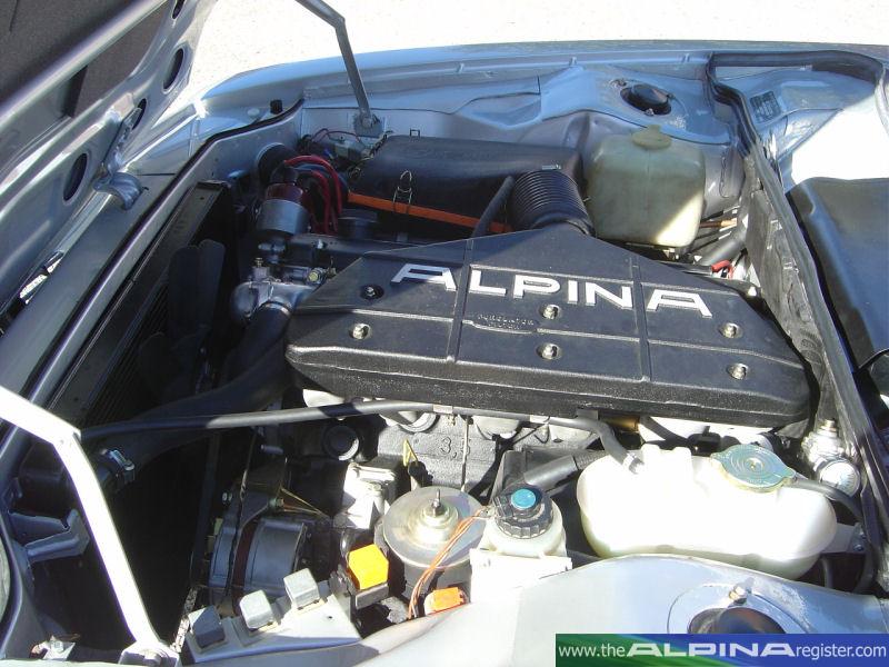

VIN is 2270162. Will see if I can add some info on my profile. Had to downsize the engine shot. Here's the Webers w/o the Alpina intake box.

Interesting. It looks like one of the POs had a fuel injection setup. Why leave the D-jet air filter box in place then?

Ok, that makes sense. I had always assumed the Alpina box had the filter inside (wrong). Thanks.

Mine looks just like that, but I' missing the large hose between intake and airbox. I found one that I think will fit, and have it on order.
