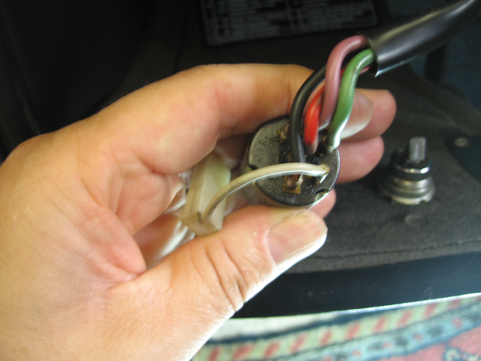

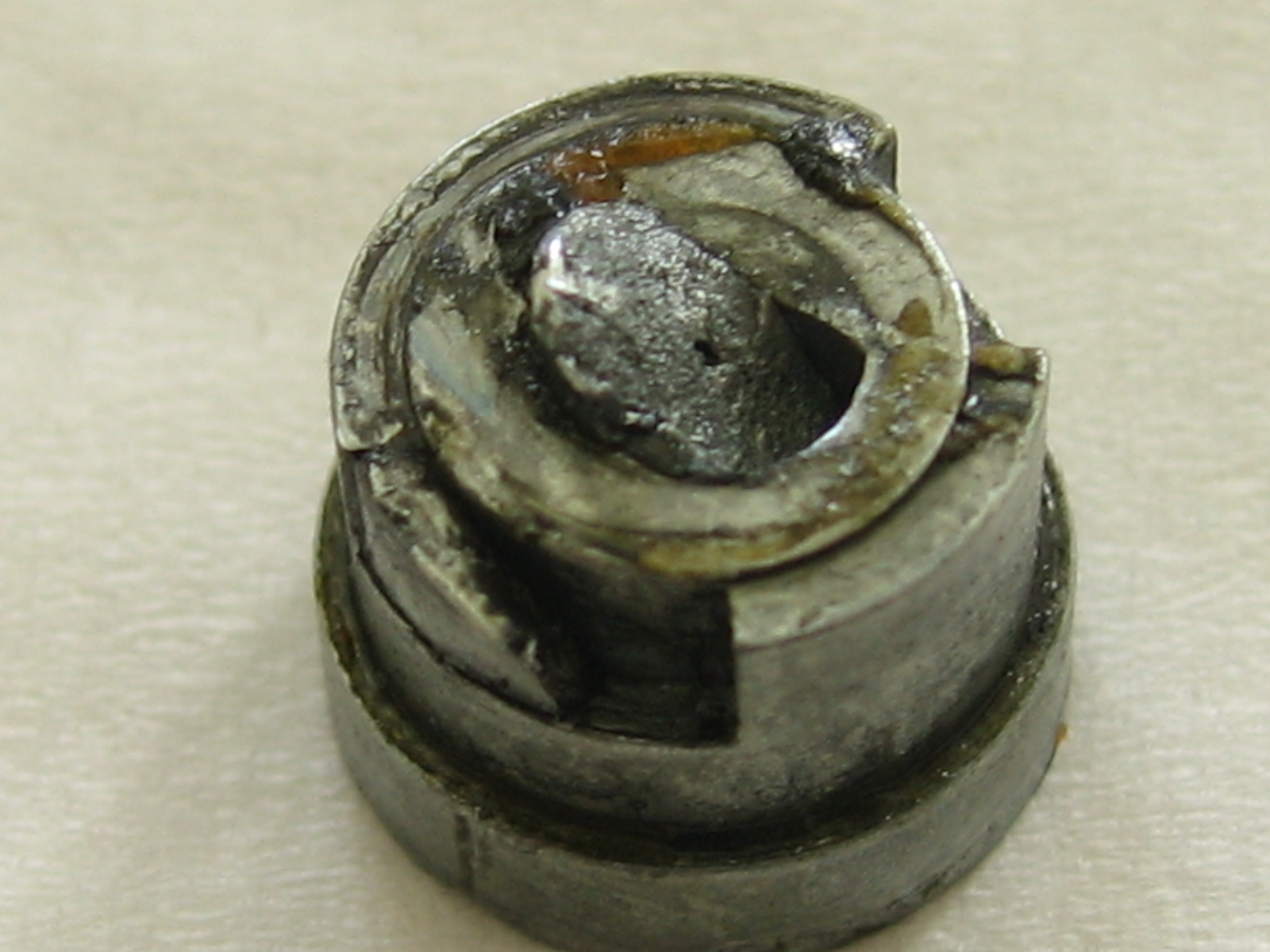

Hi guys,
Little follow up.

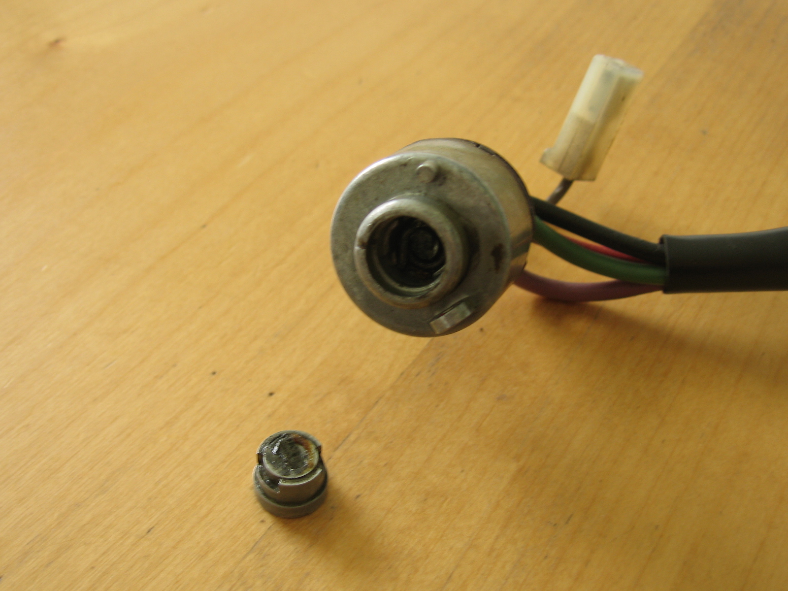

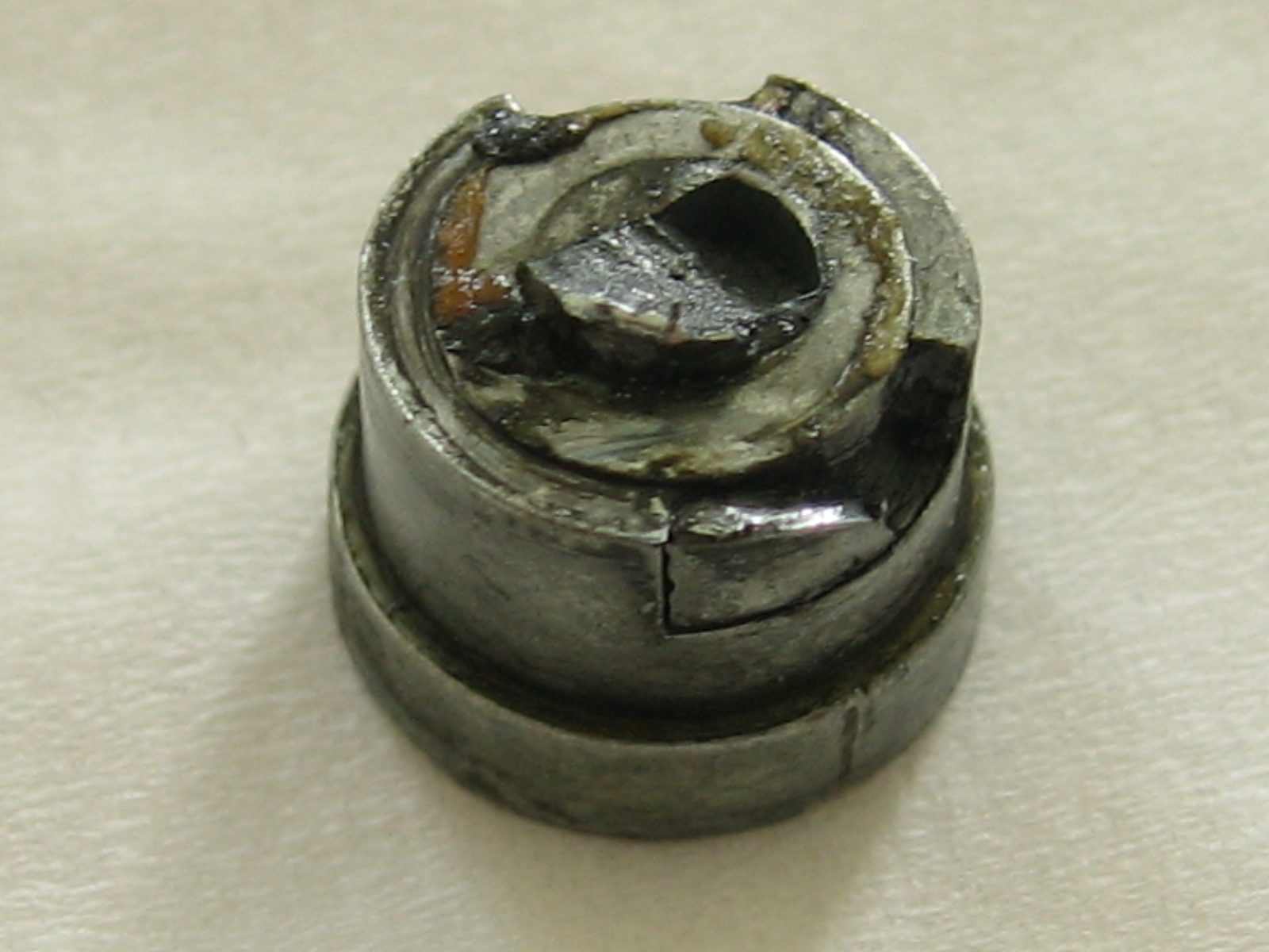

It indeed was the ignition mechanisme itself that after 16745 days decided to call it a day.
This fell out of the lower part of the ignition switch mechanisme. Clear break in a 0,50ct piece of metal

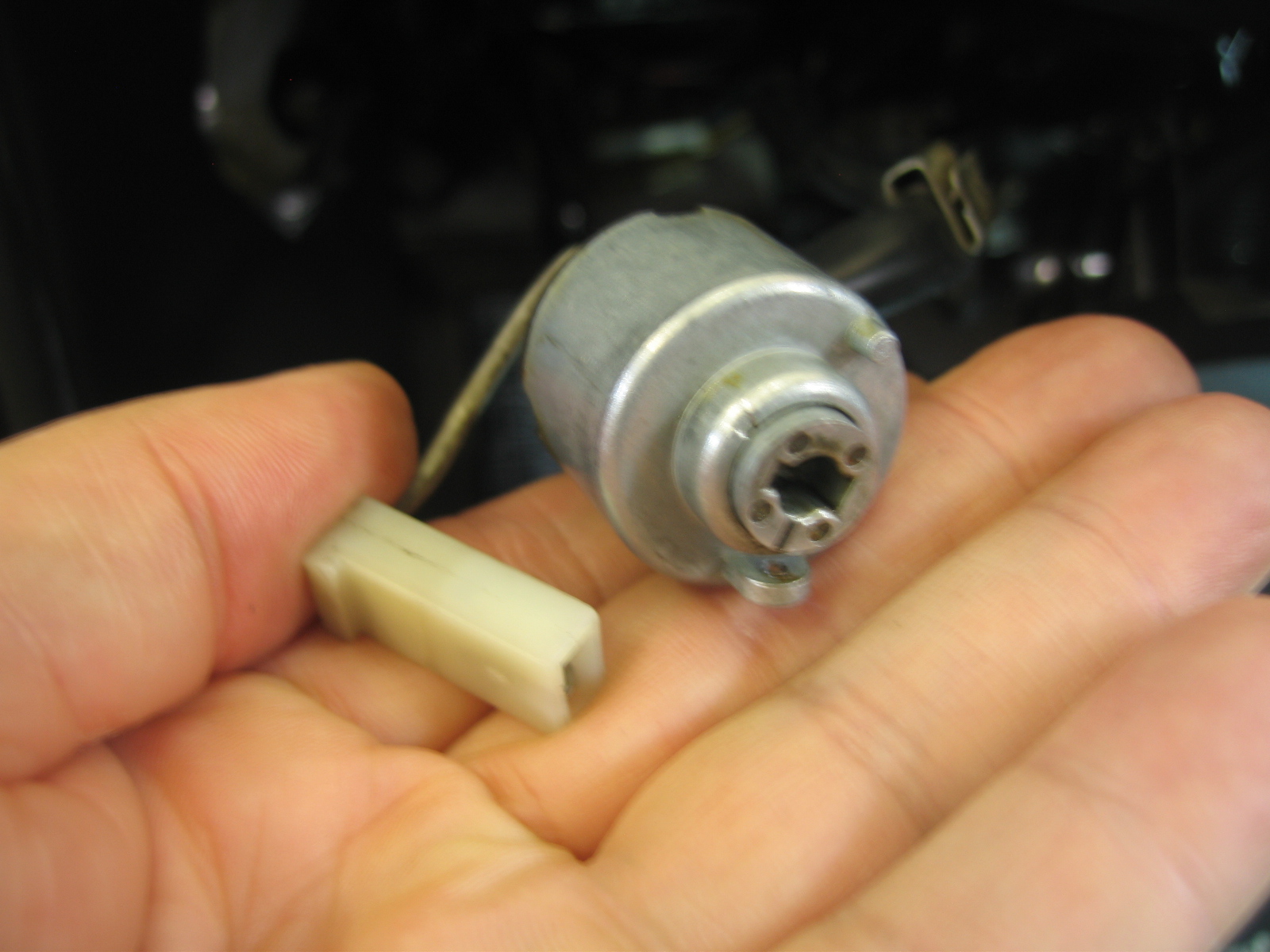

Hi Guys,
First of all big thanks to DQ in assisting me pin pointing my problem.

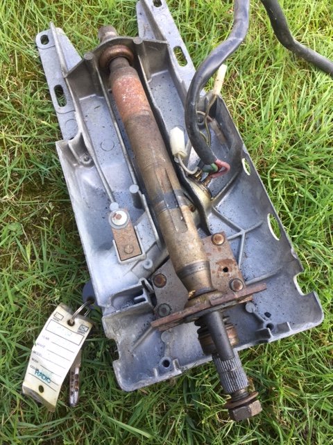

So what I need is a 1971 replacement ignition switch with cable tree in good used condition because apparently you can't by these new anymore.
So any help in getting my E9 back on the road would be very much appreciated. Below two more pictures of the switch.
Big thanks in advance and I'm really counting on you guys.;)

Was offered this replacement by a friend here in Belgium. He'll ship it tomorrow and hopefully it will get me back on the road. I'll keep you posted.

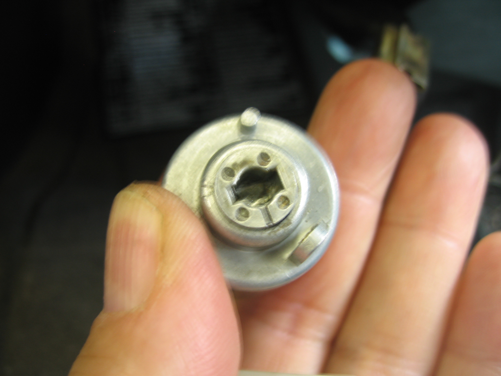

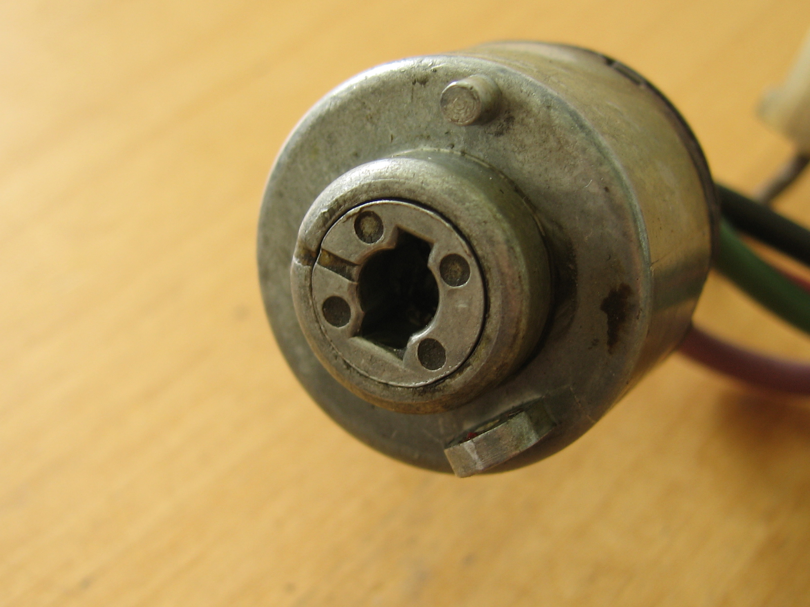

Hi Guys,
My new "old" part arrived but now I'm really puzzled!!
Took the contact out and much to my surprise the center piece fell out and looks just as broken as the piece I posted before. (cf pics)
Since the key in the old piece worked perfectly with correct spring resistance I just pushed the "new" old piece in my ignition cylinder and my key also regained its spring resistance. So without connecting the cables it feels OK.
What am I missing here? Is that center piece supposed to fall out and if it isn't and this one is as broken as my original contact , why does it appears to work?
Many thanks in advance for any help in solving this riddle.

Philippe db
726
205
Belgium
Hi Guys,
Well since I felt the spring reaction I just connected the replacement part and the engine started immediately. So however this switch works it must have been something else that broke in my old one and not the piece I posted. End good all good and for a guy who 2 years ago just managed to change his spare tyre I'm quite proud of myself.:)
