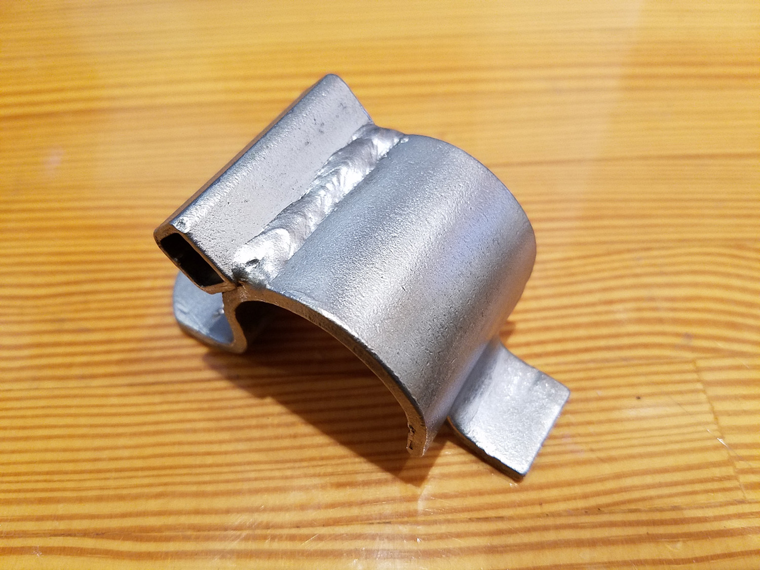

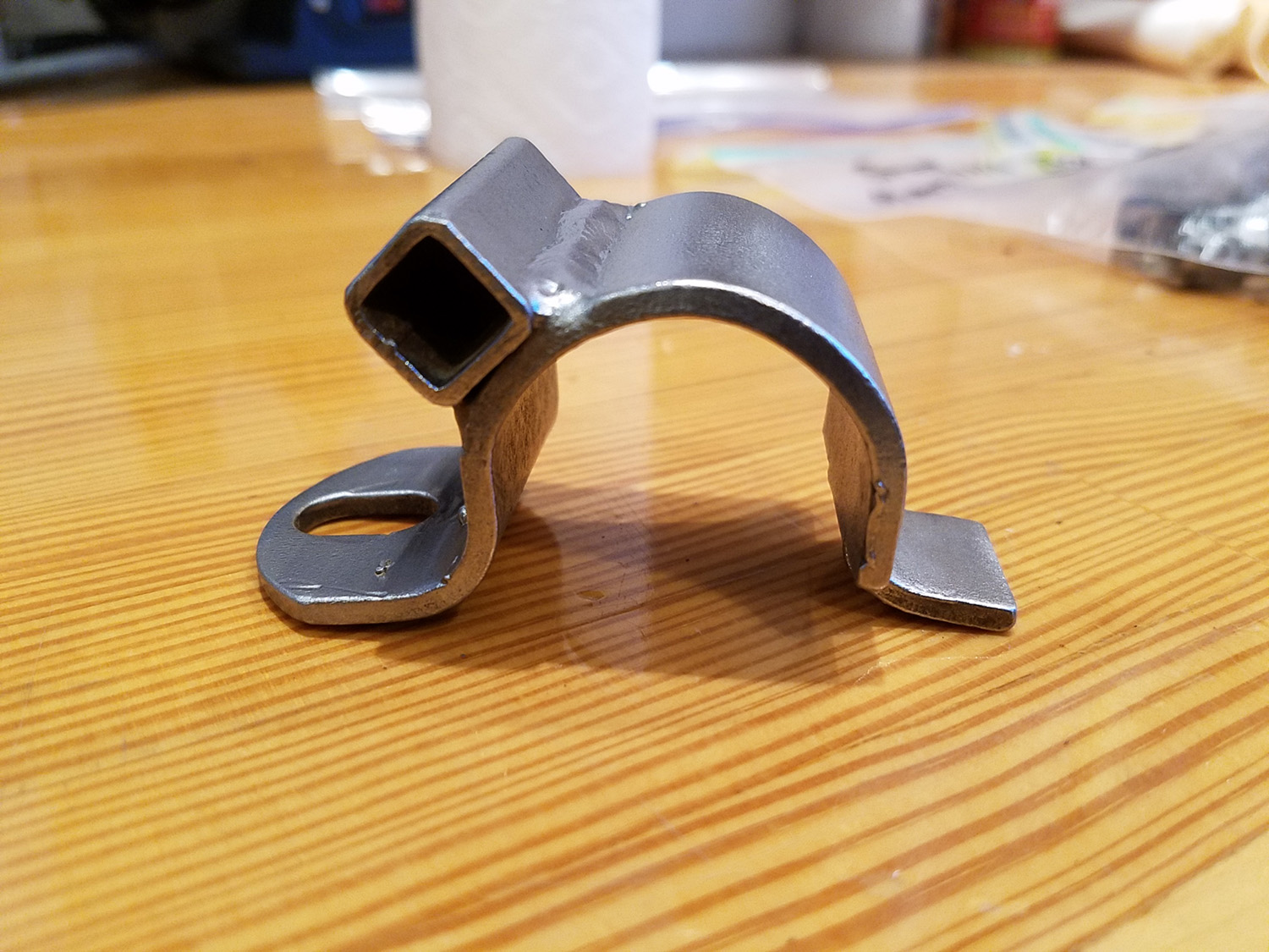

Can I ask how you guys got these to fit in the front. The space for the bar, bushing and bracket is really tight so the bracket or something has to be modified.

IE offers new clips with their bars.
Mine are aftermarket as well - and are reinforced with a small square tube welded on. Not sure where they came from, but they are nice. The problem is, the weakest link is the tab and slot where it attaches to the subframe. I am reinforcing the slot in my subframe a bit.

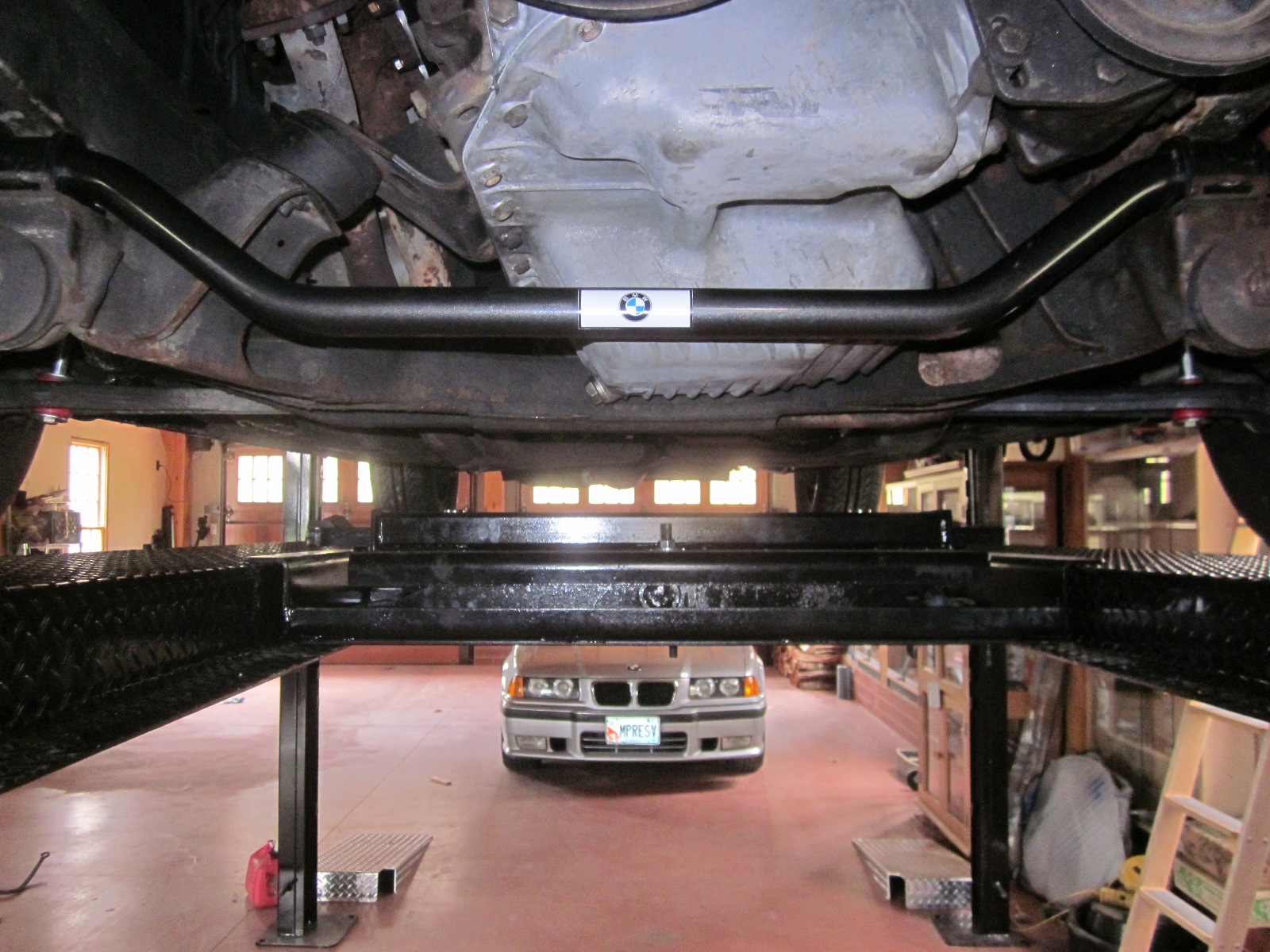

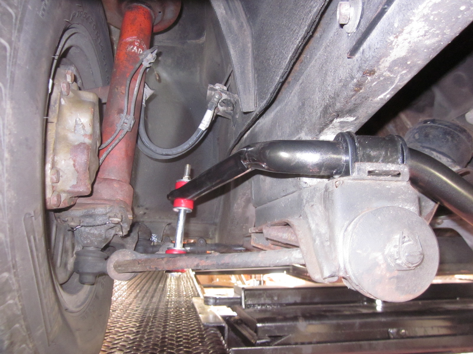

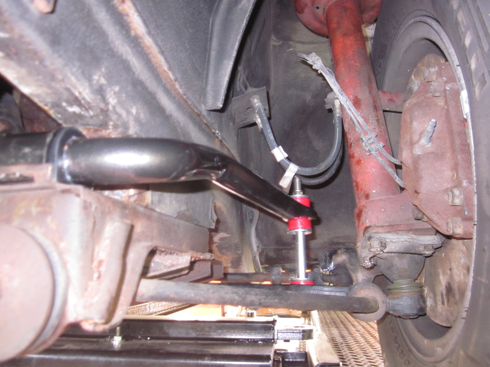

The bushings allow for the bigger bars in the stock brackets. These photos are when I installed them in 2011. I had a bracket break in the bolt side, had it welded back together last Fall.
