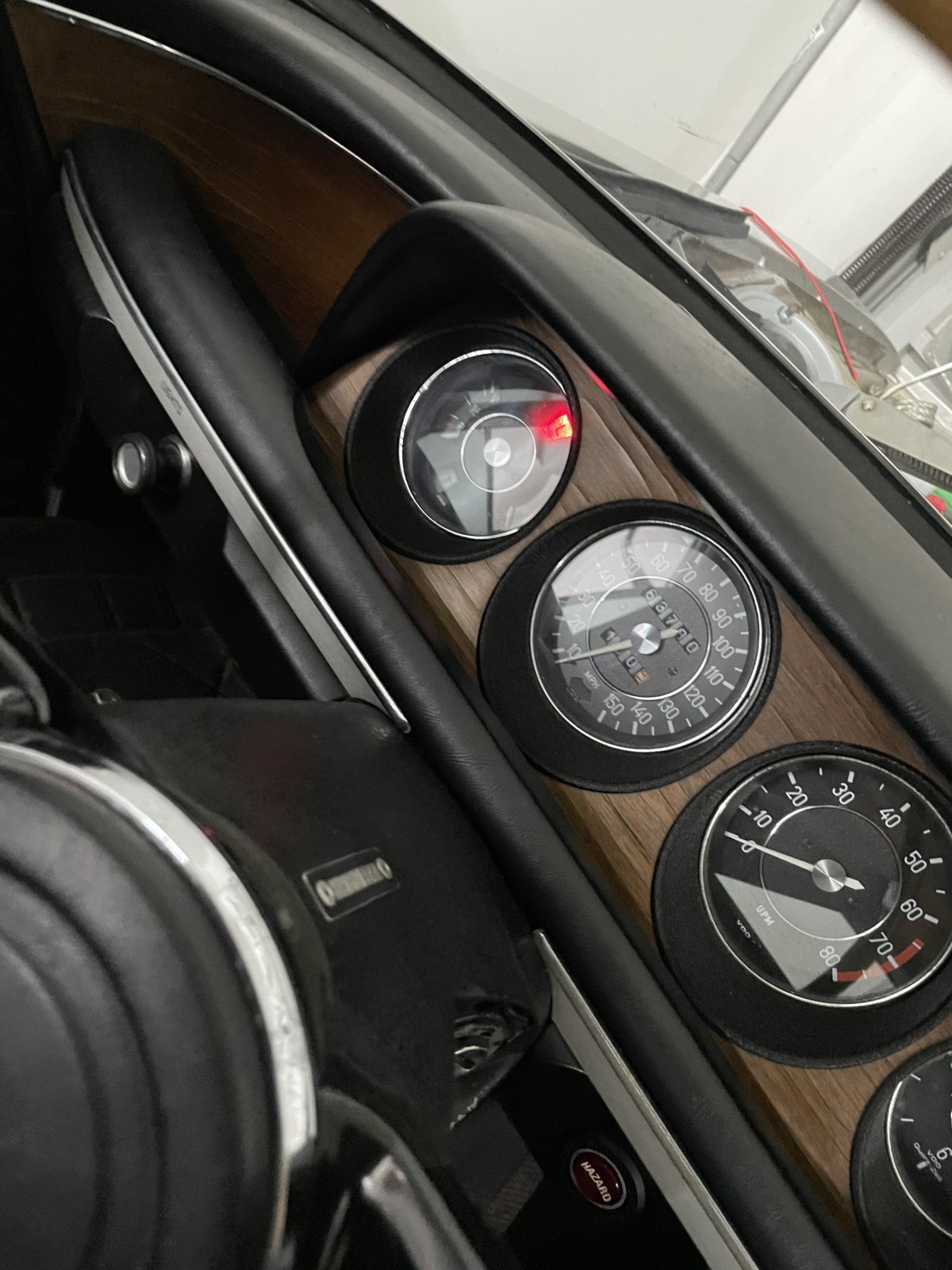

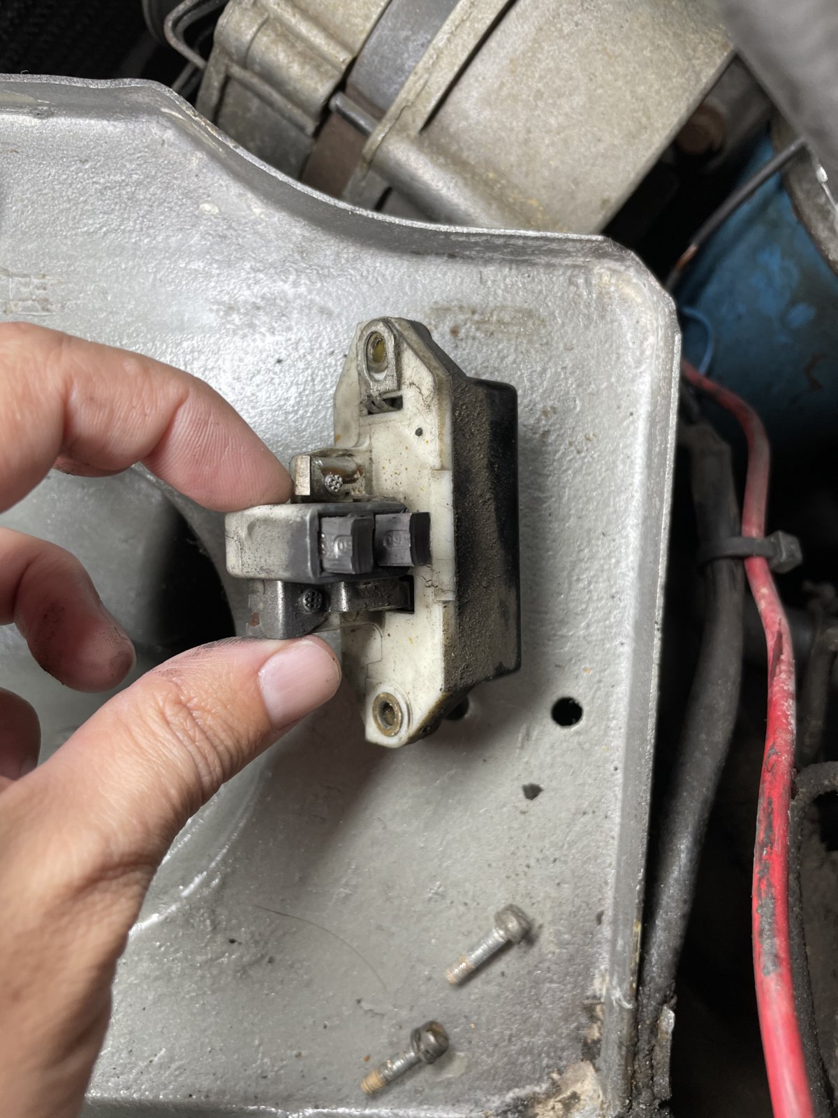

Has this been seen/resolved by anyone else? I had the same problem show up today. Assuming I have a short somewhere but not sure where to look.
L-light turns off when I turn the key over to on.
Acc, off and key out L light stays on.
Battery : 12.2v while off
Check the wires on the back of the alternator & could be a faulty regulator.
Do you have the owner's manual or Blue Workshop Books?

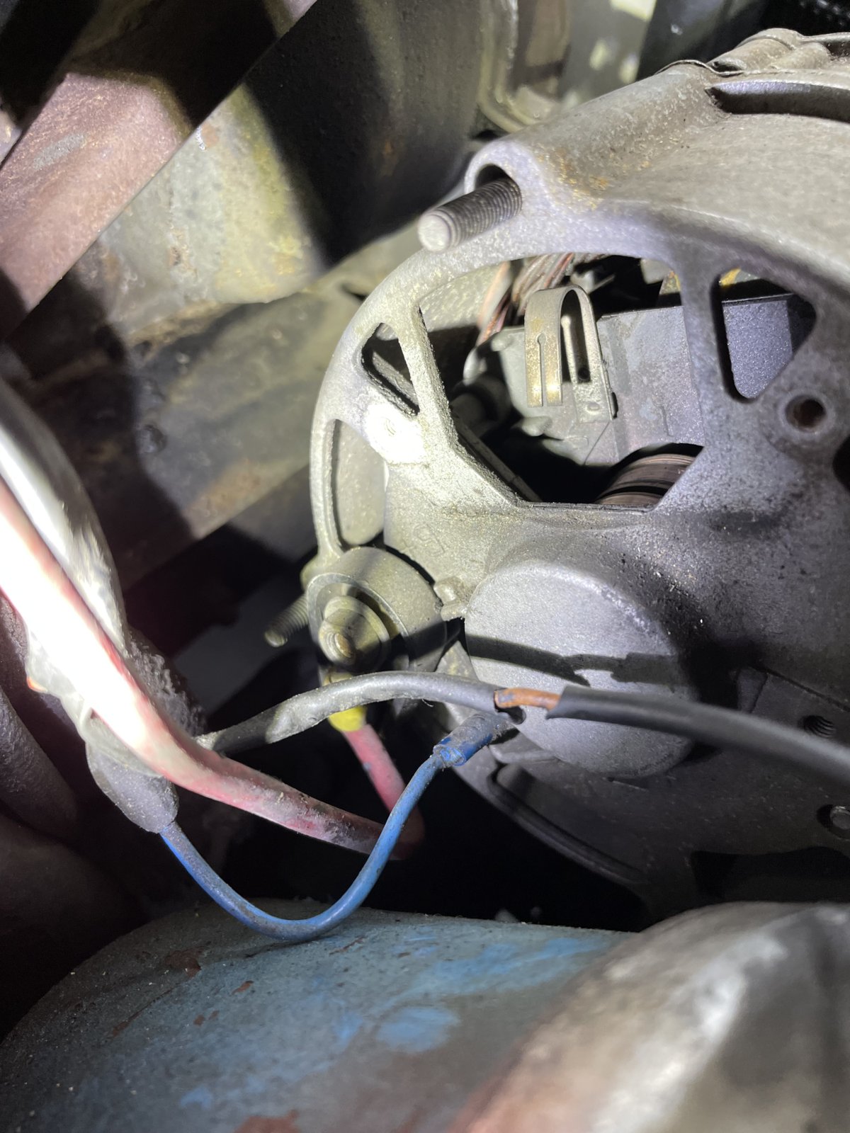

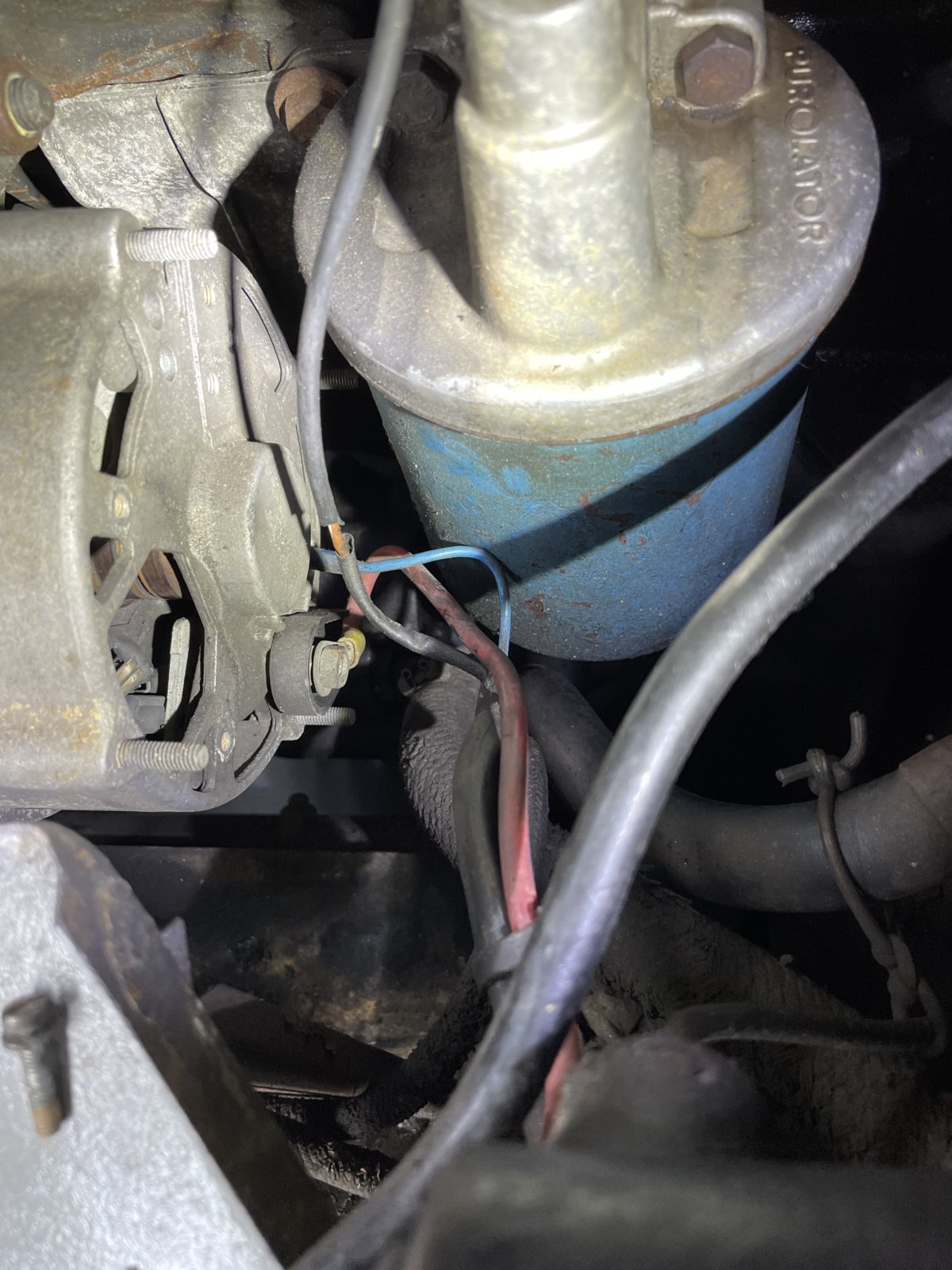

No change with pulled fuses but I have chased it to the cable running to the alternator. The voltage regulator is warm to the touch after being parked for 2 days which I assume is no bueno.
Got it unplugged and battery on trickle charger for now since it’s been drained a bit the past few days.

The three wires from your regulator are in a plastic sleeve, open it up and your wires are probably bare and shorting out, this is very common. I wouldn’t charge anything until I examined the wires.

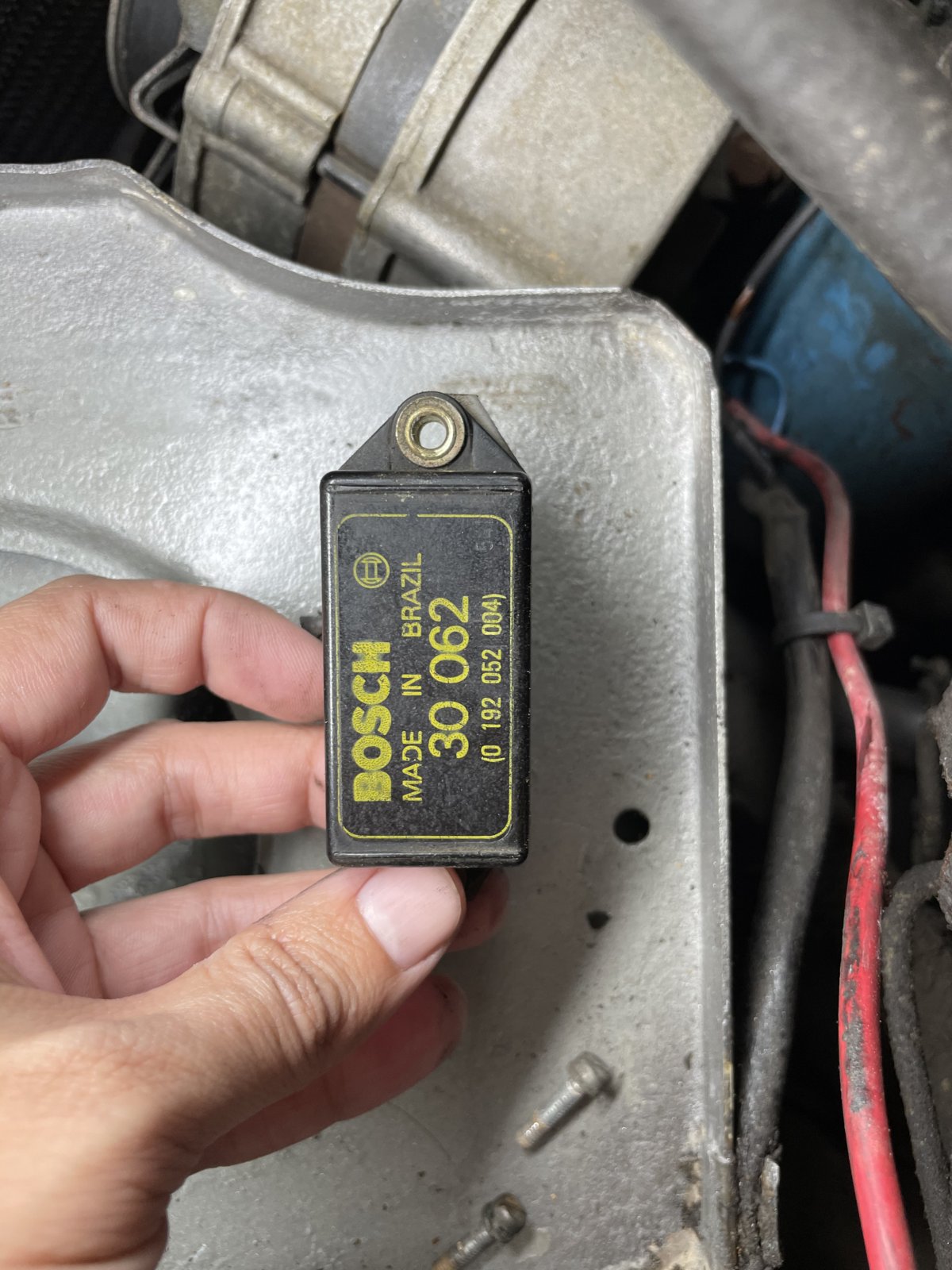

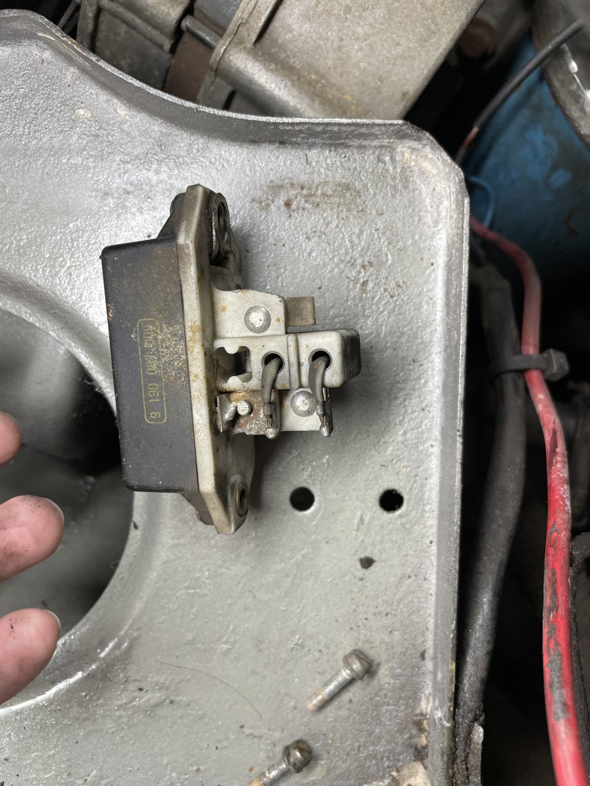

@adawil2002 I think this conversion has already been done, the external regulator location is blank. Not sure what went in the 3rd slot. The part that was warm is the internal one. Pics below.
@HB Chris I should have mentioned, battery if off the car. So far haven’t found anything super frayed besides some shrink missing from the coolant temp wire.
