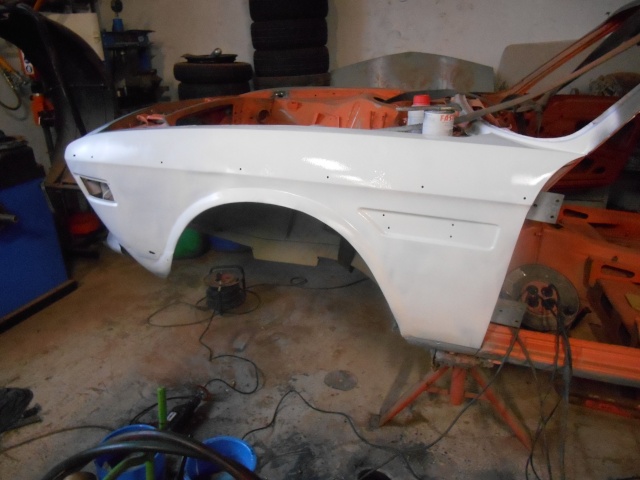

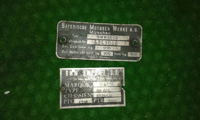

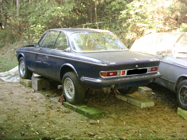

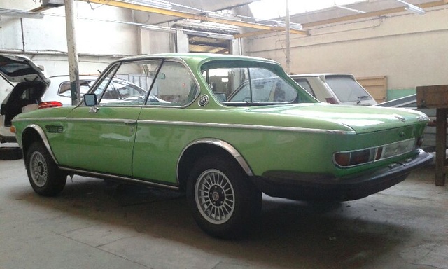

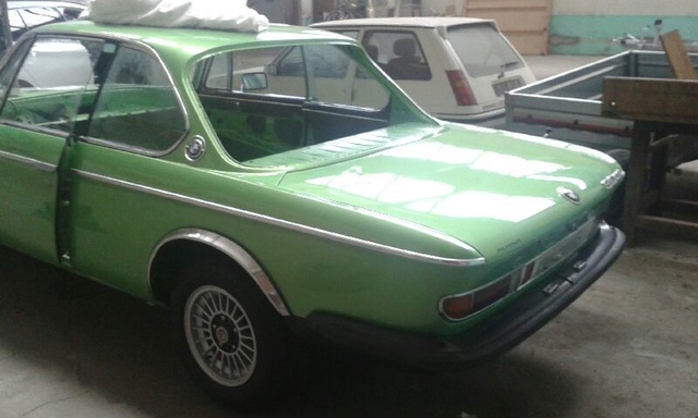

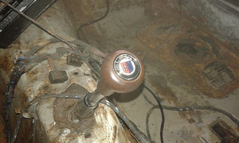

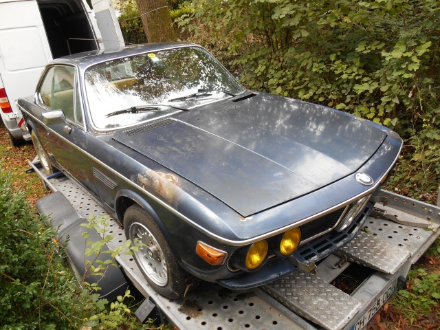

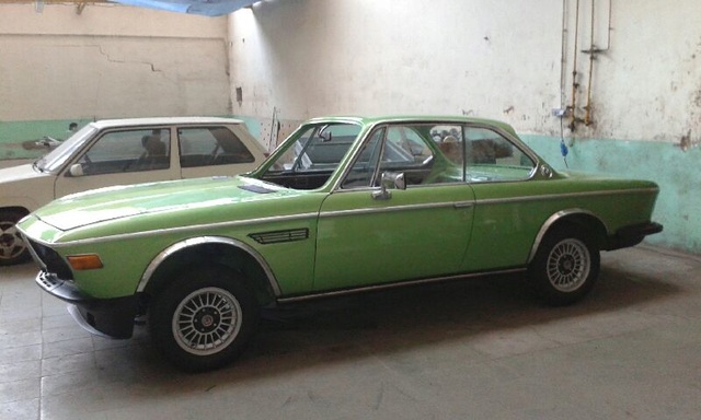

    This is some photos of my 3.0 csi story.
    Discovered in a wood...

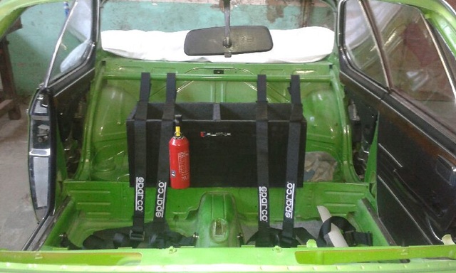

  2. NONO88
    NONO88 Member
    Messages:
    55
    Likes Received:
    26
    Trophy Points:
    18
    Location:
    france
    [​IMG]

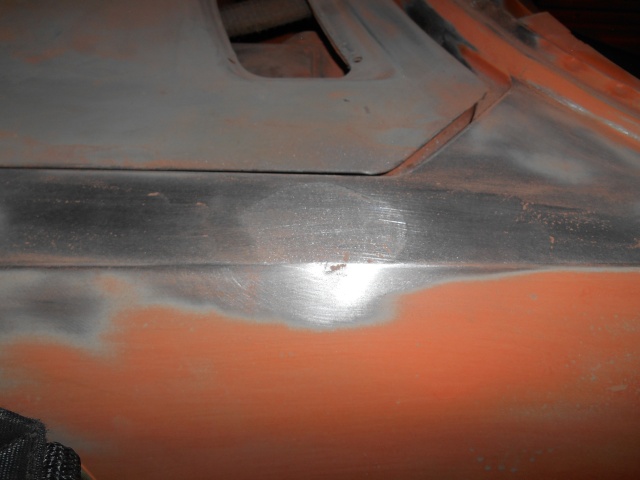

  5. eriknetherlands
    eriknetherlands Active Member
    Messages:
    560
    Likes Received:
    197
    Trophy Points:
    43
    Location:
    Netherlands, Eindhoven area

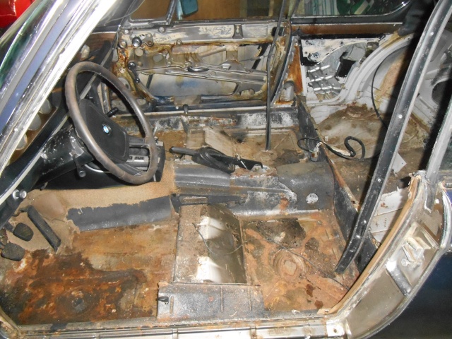

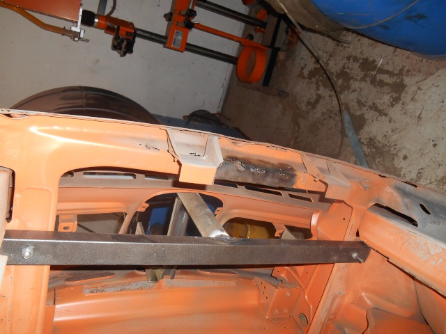

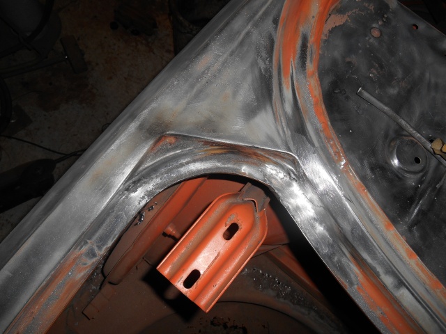

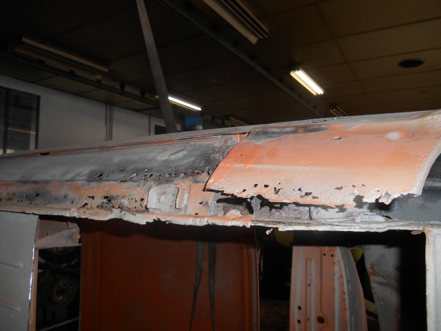

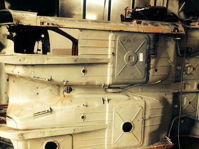

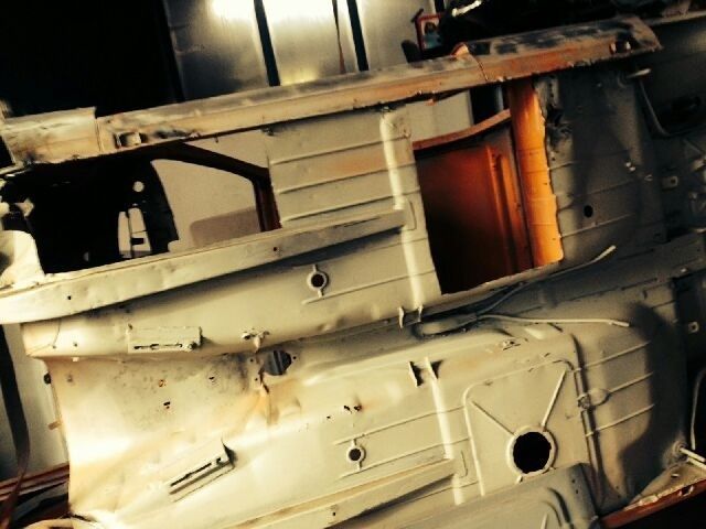

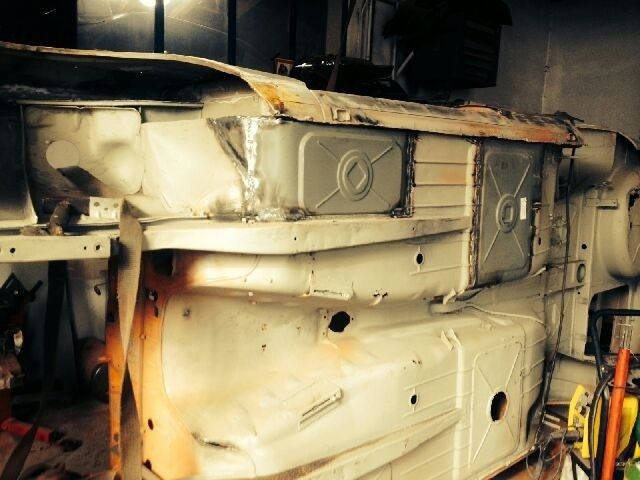

    It seems something is going on in your transmission tunnel, It wasn't like that when it left the factory. My car was also like that.
    It seems that this can develop into cracks, or has already perhaps. I'd clean it with a wire wheel and find out.
    I'm not sure if it is or will be a problem, but it seems you're now in a good spot to make sure it doesn't get any worse.
    http://www.e9coupe.com/forum/threads/weak-spots-of-the-body-tunnel-is-it-one-of-them.24161/
  6. NONO88
    NONO88 Member
    Messages:
    55
    Likes Received:
    26
    Trophy Points:
    18
    Location:
    france
    This is so that the water does not go back... If she went back up there.
    On the first e9 there is a single drop of water

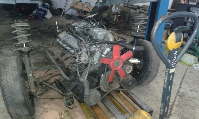

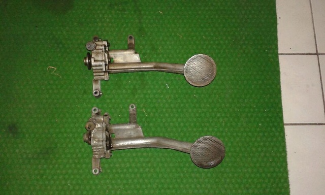

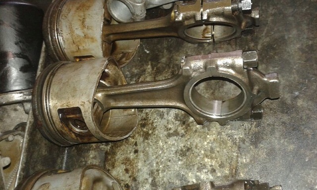

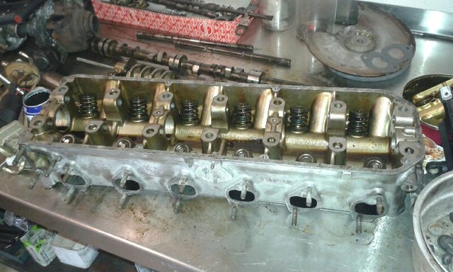

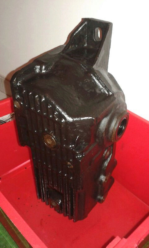

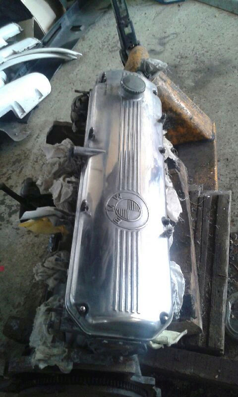

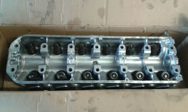

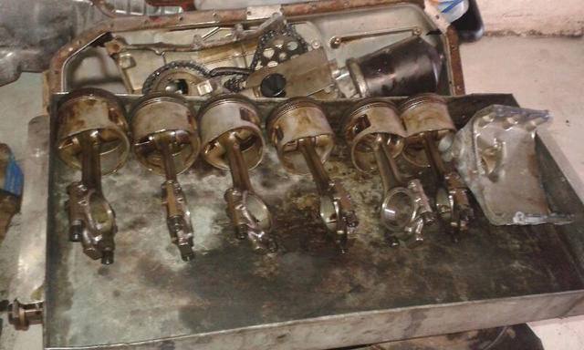

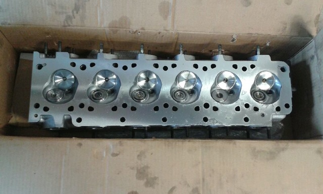

    disassembly of the engine, all going well except a crank which is not same as the other
    [​IMG]
    [​IMG]
    [​IMG]

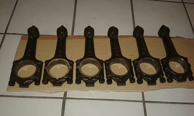

    I found a set of six rods

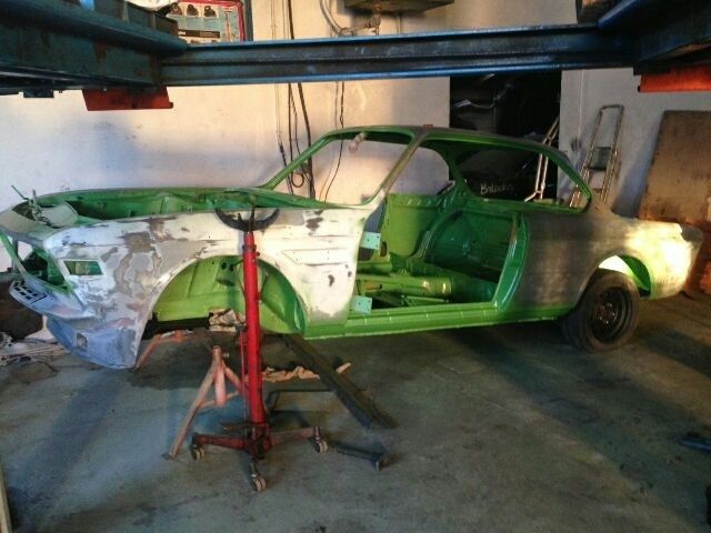

  14. NONO88
    NONO88 Member
    Messages:
    55
    Likes Received:
    26
    Trophy Points:
    18
    Location:

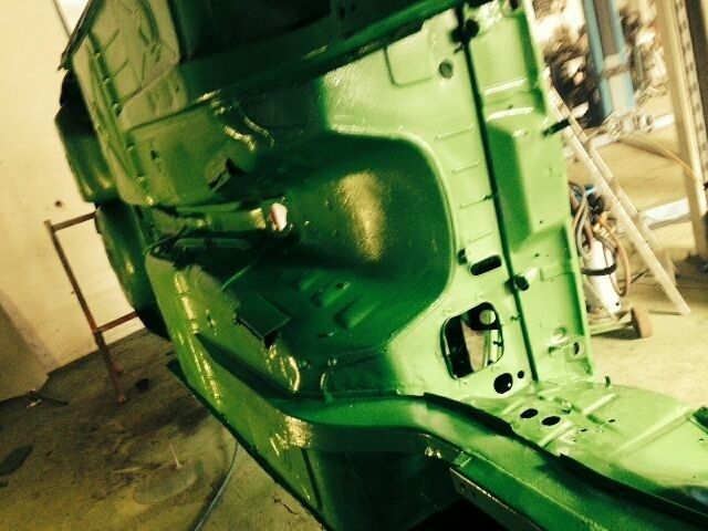

    france

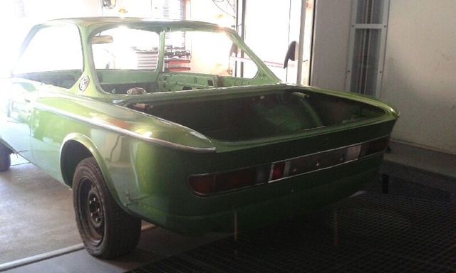

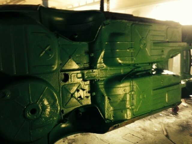

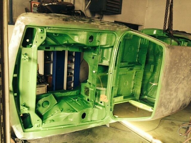

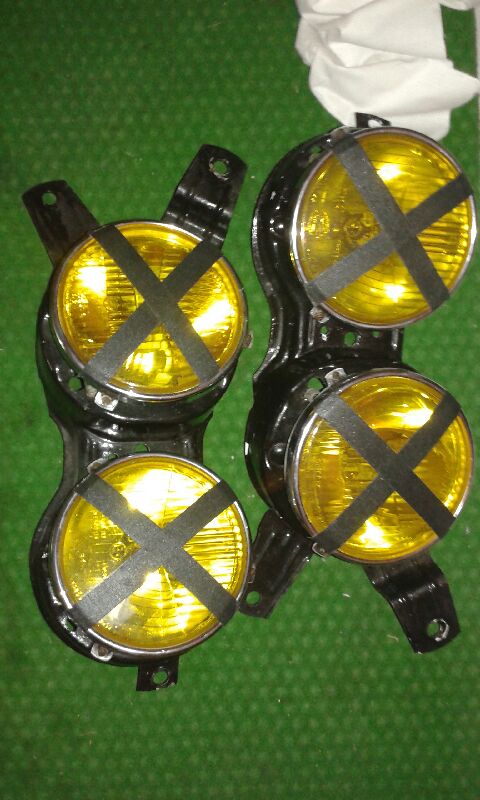

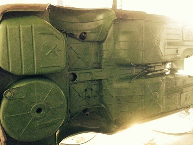

    Ready for painting, see you Monday for the Green Lantern....
    [​IMG]
    [​IMG]
    Stevehose likes this.

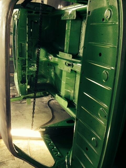

  15. NONO88
    NONO88 Member
    Messages:
    55
    Likes Received:
    26
    Trophy Points:
    18
    Location:
    france

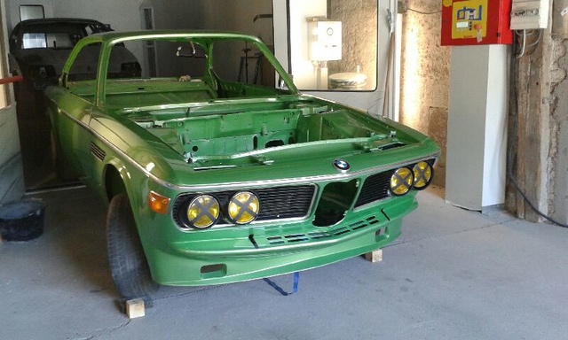

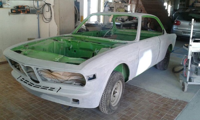

    the reassembly begins.
    The black will be applied in the coming days.

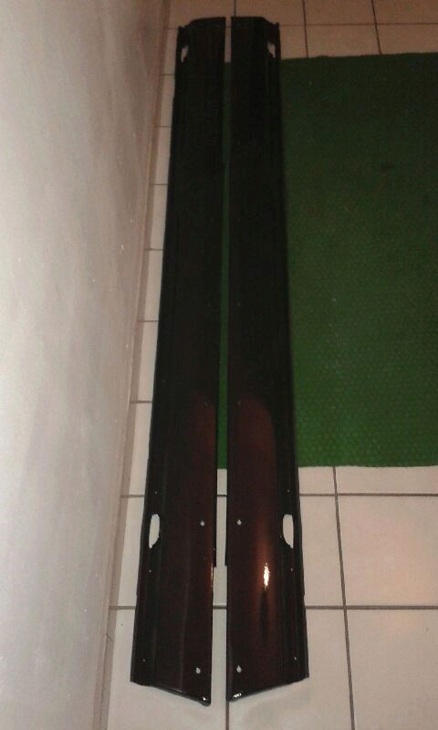

    Hi NONO88,

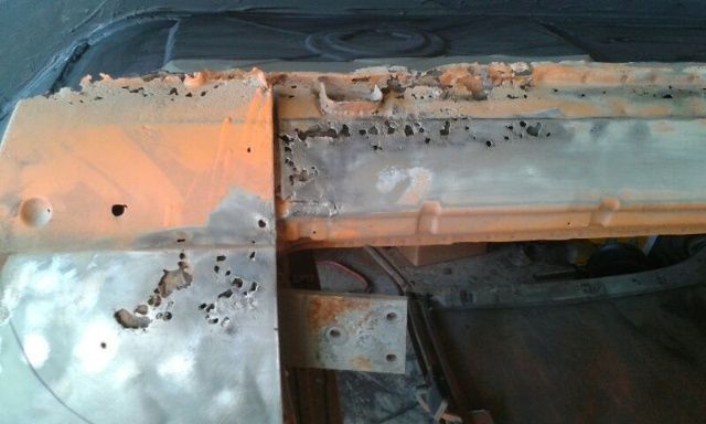

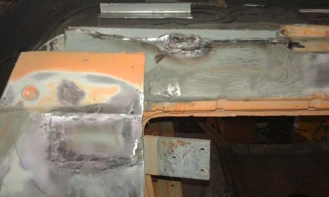

    Do you also have more pictures on the repairs on the sills?
    I am going through these as well, and like to learn from how others do it...

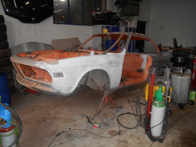

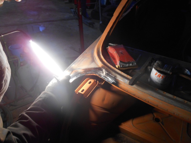

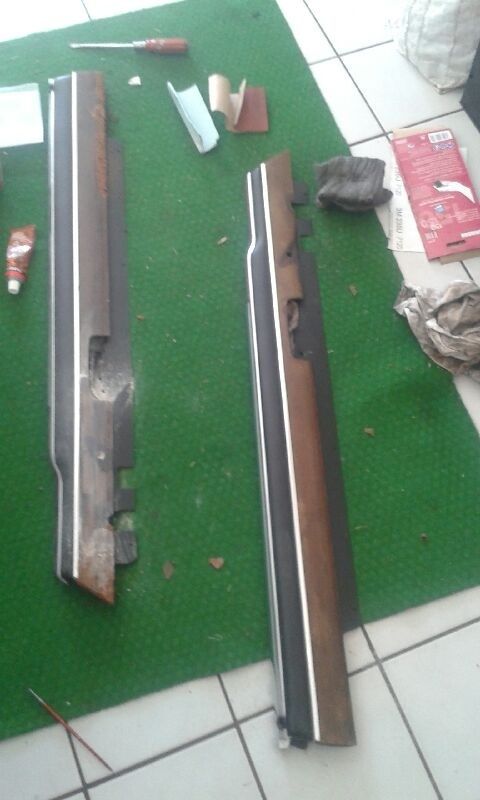

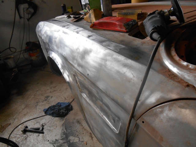

  17. NONO88
    NONO88 Member
    Messages:
    55
    Likes Received:
    26
    Trophy Points:
    18
    Location:
    france

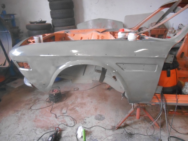

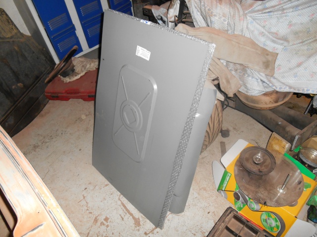

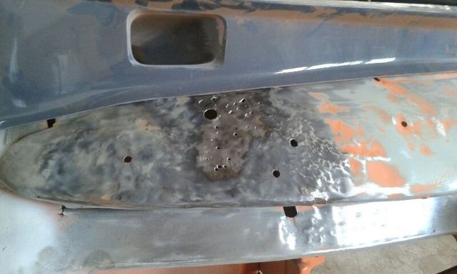

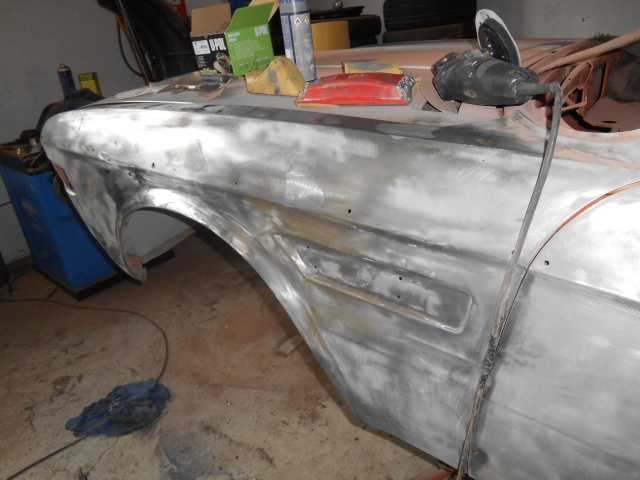

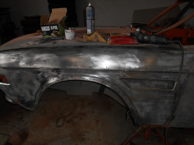

    The best is to open.

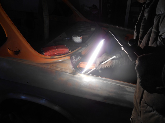

    To treat or scrape the rust.
    And for the front wings the best is to remove them.
    Rust is everywhere in the front.
    Sorry for my broken English...
    [​IMG]
    [​IMG]
    [​IMG]
    [​IMG]
    [​IMG]
