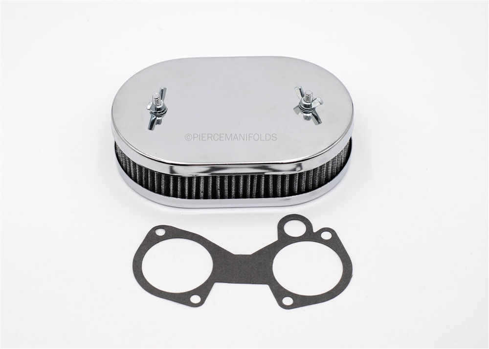

    Filter type?
    I prefer the look of the RamAir style filter but am concerned with the foam being as effective as the oval paper styled ones. Pros and cons?
    [​IMG]
    vs:
    [​IMG]
  12. Bill Riblett
    Bill Riblett New Member
    Messages:
    734
    Likes Received:
    1
    Trophy Points:
    0
    My big gripe about the Ramflows is that the foam filter elements deteriorate pretty quickly. I think they filter ok.
    They should give you maximum intake noise!

    That's what I'm thinkin! I will probably go for this style, I don't mind maintaining the foam to keep them clean and it seems by design they will let more music out as opposed to the paper ones with metal tops.
