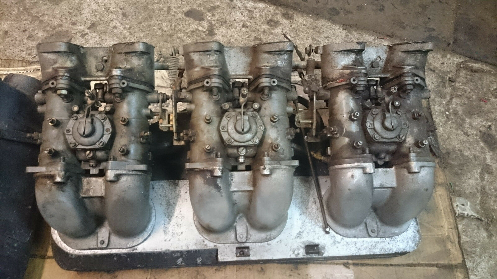

I had an real Alpina manifold on a 2002 a long time ago and it was one piece
The original m30 setup has a manifold
for each carb. Also note the flat slots. Also note that all cars referenced so far have the early pancake booster. The pancake booster looks bigger in diameter but it is much shorter. I don’t know the dimensions of the two, but the CS master cylinder practically touches the battery tray, and the chamber is a good 6”+ “deep”.

That is an original Alpina setup?
do you have an end view?
Length of booster I don't think is an issue, it is in there now
