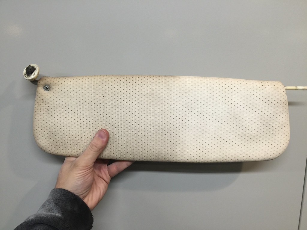

I did soda blast a visor. It worked fairly well, with no damage to the pattern. It's still dirty. I think that I will invest in a real soda blaster. This was done with a $20 gravity feed blaster from Harbor Freight. I did read on their reviews page that it help if you drill out the gun to feed more soda.
This was a two minute exercise. You can see the spots that I missed.
