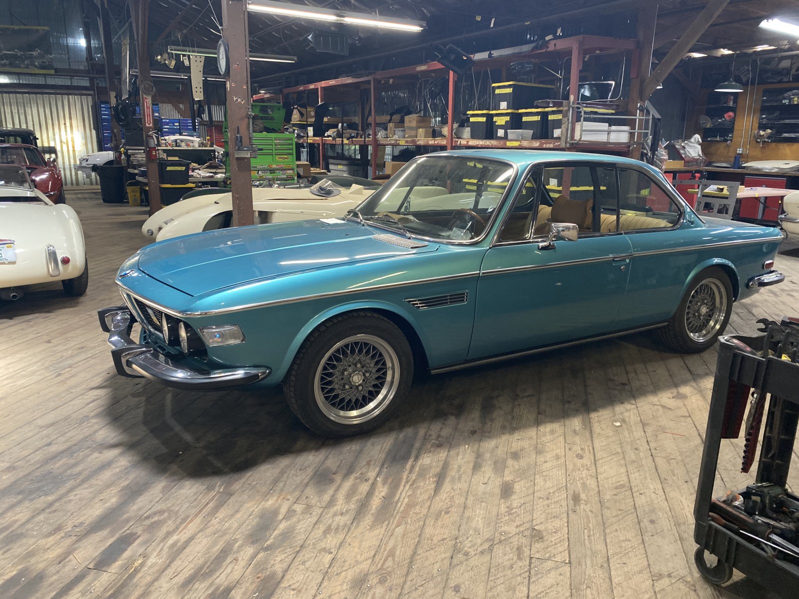

This is a new offering. I requested a price and received a reply--$115,000. Here are the pics of the car and the restoration. Finding an original Turkis #065 in this restored condition will be extremely difficult for this price.

Looks nice but I expected perfection for that money.
Telling for me that despite there being 100s of pics, but no picture directly from behind the car. From the other rearward pics ,looks like the boot (trunk?) lip isn’t quite straight. Maybe repaired or poorly fitted back?

Sunroof Turkis CSIs are the top dawg aside from CSLs of course.
Well worth the money me thinks; even w/the black underside.

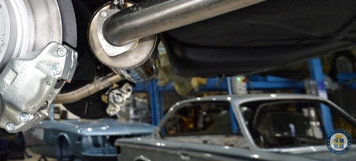

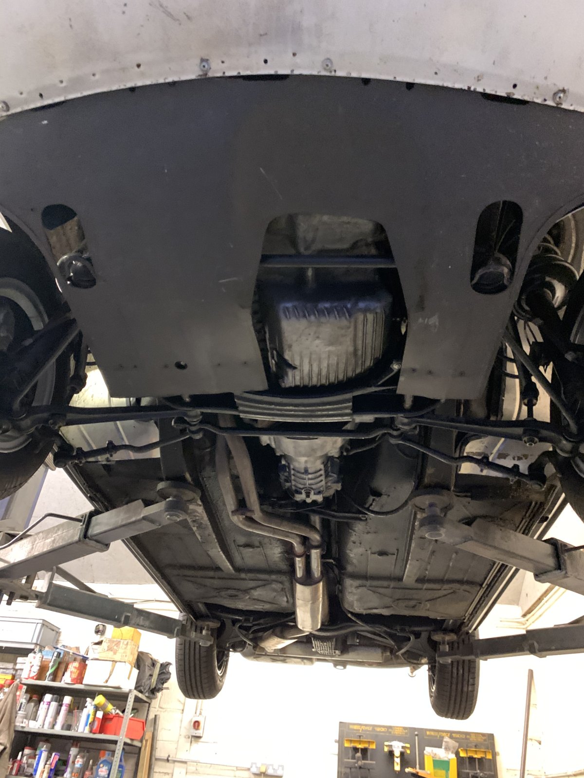

Very clean but why black underside and wheel wells, no under door seal, cheap Alpina (sort of) look wheels?
Is the treatment of the underside a matter of preference, or is there a generally accepted standard? I noted disparaging remarks about the grey green painted undercarriage on the recent BAT sale that was finished by this company which is why I’m asking.

Is the treatment of the underside a matter of preference, or is there a generally accepted standard? I noted disparaging remarks about the grey green painted undercarriage on the recent BAT sale that was finished by this company which why I’m asking.
I too would be interested to hear what the accepted approach is.
The previous owner of my E9 waxoiled the whole underside of my car and in all cavities and in the wings etc etc.
So my car looks very similar to this car (although not as clean!).
I’m kind of glad he did and it’s protected it a huge amount.

There is a minor issue with this car that also presented on Williams (I told him about it). Apparently it is an artifact of Oldenzaal work. I'm not going to go into details on said minor issue.
I'd like to learn what this "issue/artifact" is so I don't repeat it on my restoration. The Oldenzaal photos are one of the resources I use to assess what it is "supposed to look like", because they take and show a lot of photos. I know of a few things that aren't original, but any additional clarifications would be helpful to me and others that are embarking on thorough restorations.

Underside was khaki/green primer, factory grey undercoat with body color wheel wells and slight color overspray near rockers. Gas tank satin black, subframes very dark grey with hint of green, almost looks black.
I've been told I'm nearing the paint stage on my coupe. I'd love to figure out how to make the underside correct since its essentially 'better than new' , at least as far as what Karmann produced at the just before paint stage.
