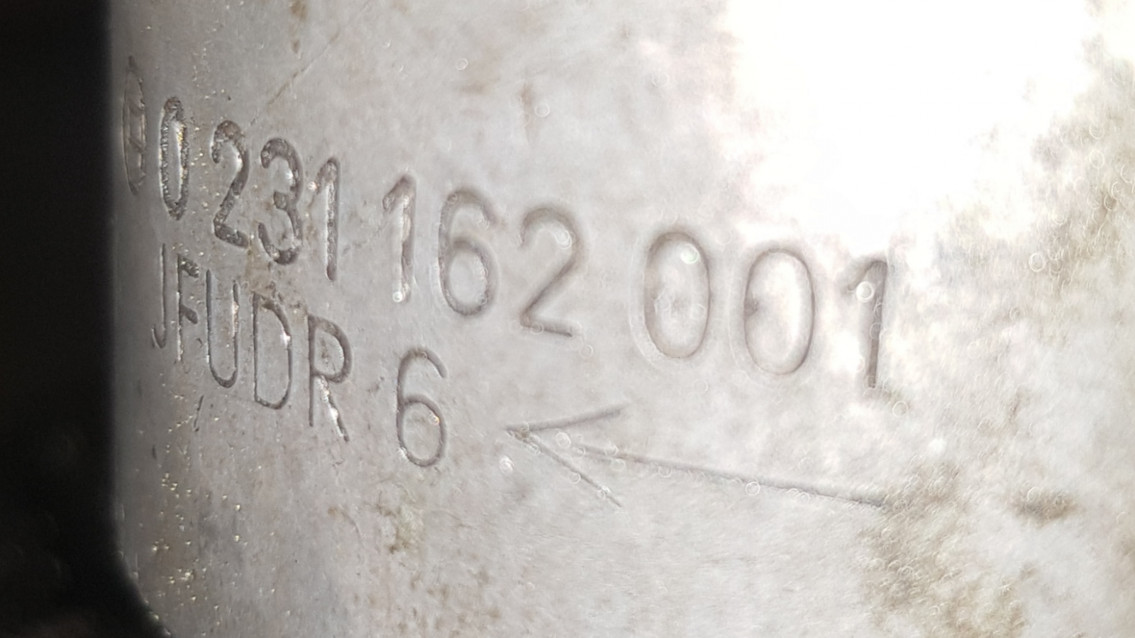

Going through some rough running issues with my 2800CS, it seems that my distributor might be the culprit. So I checked and it is a slightly different Bosch part number from what you mentioned: 0231162001 (JFUDR 6)... Which is right?
