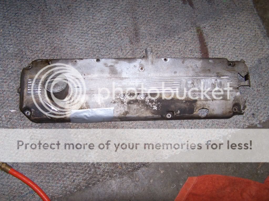

You start with something that looks like this...
And work hard for something like this...
Let's see your own take...

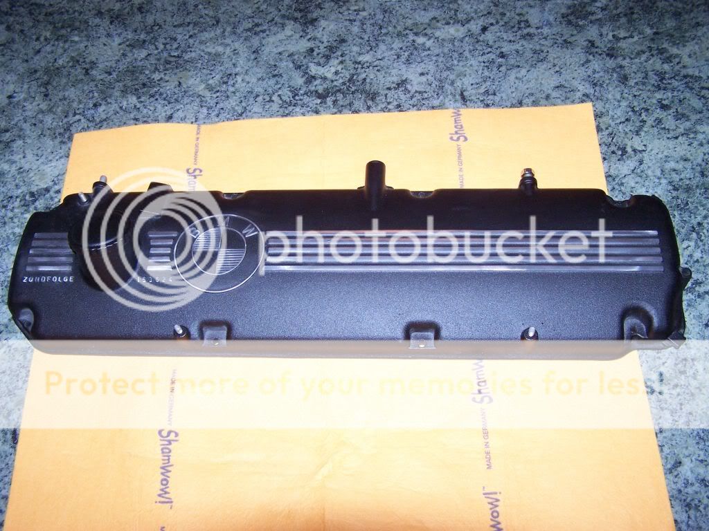

Wow...I was hoping to see some examples but, Mr. 84E24...that is over the top! Way cool!
On my project at the moment, engine compartment detail, I have had my intake components media blasted. Powder coat for the valve cover, heater blower motor cover, air cleaner housing, headlight access covers, as well as orangeners strut brace stuff. On the valve cover, the entire surface was powder coated, as to bring out the ribs, etc., if they wiped away the dry coating it would clump up in the ribbed areas. I used the die grinder with a small circular 3M style abrasive disc, medium then fine grade to take the coating off the raised areas. I looked at the piece for a while before getting brave to do this, as it takes a steady hand and I was chicken I would mess it up! I was careful not to over work this process and not get too carried away. I would have to call the local powder coat shop for specifics on the material used but I believe it is a special heat resistant wrinkle coat type material.
I will for sure post some pics once all is completed (more or less as is it ever "finished?)
I am certain there are many other fine examples of the valve cover, mine is basic..
Bring it on guys and girls...show your stuff!

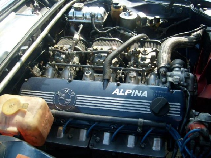

cover valve black
are looking for a black valve cover for my bmw cs ...
just a month ago I bought on e-bay.de a beautiful black valve cover for 102.00 euros, but the seller never sent it to me and I was very bad ...
MECH COMMANDER .. this is the nickname used by this person on e-bay ... Warning!
are now willing to buy you a valve cover black type Alpine Alpine written by or better yet ...
what type photographed by the great friend orangener ... BEAUTIFUL-BEAUTIFUL BEAUTIFUL ...

Just to answer some questions...
We did the cover in a faux wrinkle coat called "Sandtex Black" My boys do valve covers all the time for Chevy etc. and have had no issues with this coating in as far as temp tolerance. There is a phenomena called "out-gassing" which can be an issue on cast alloy bits depending on the quality of the casting (the out-gassing will cause pits and pin holes in the finish) A Yugo bit may not survive, for instance, vs good German metallurgy. This can be an issue using smooth finishes, regardless. Not so for the Sandtex as it fills any pits quite nicely. I asked to do my intake trumpets, no go, and media blasted only on these bits. So safe to say that the cover is an OK, as you can all see from the photo.
