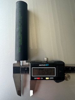

Note for future reference: I received the correct part after a few weeks wait, and the inner diameter is way too small to fit on the connection to the valve cover or the air box. I ended up buying a piece of radiator hose, 3/4" ID and 1" OD and even that was a tight squeeze.
I ordered one off eBay using the part # and it fit fine. Tight but fine.
Maybe I got one from a bad run? 3/4" ID hose was super tight, this is over a a tenth of an inch smaller in diameter. No way this was going to fit.
