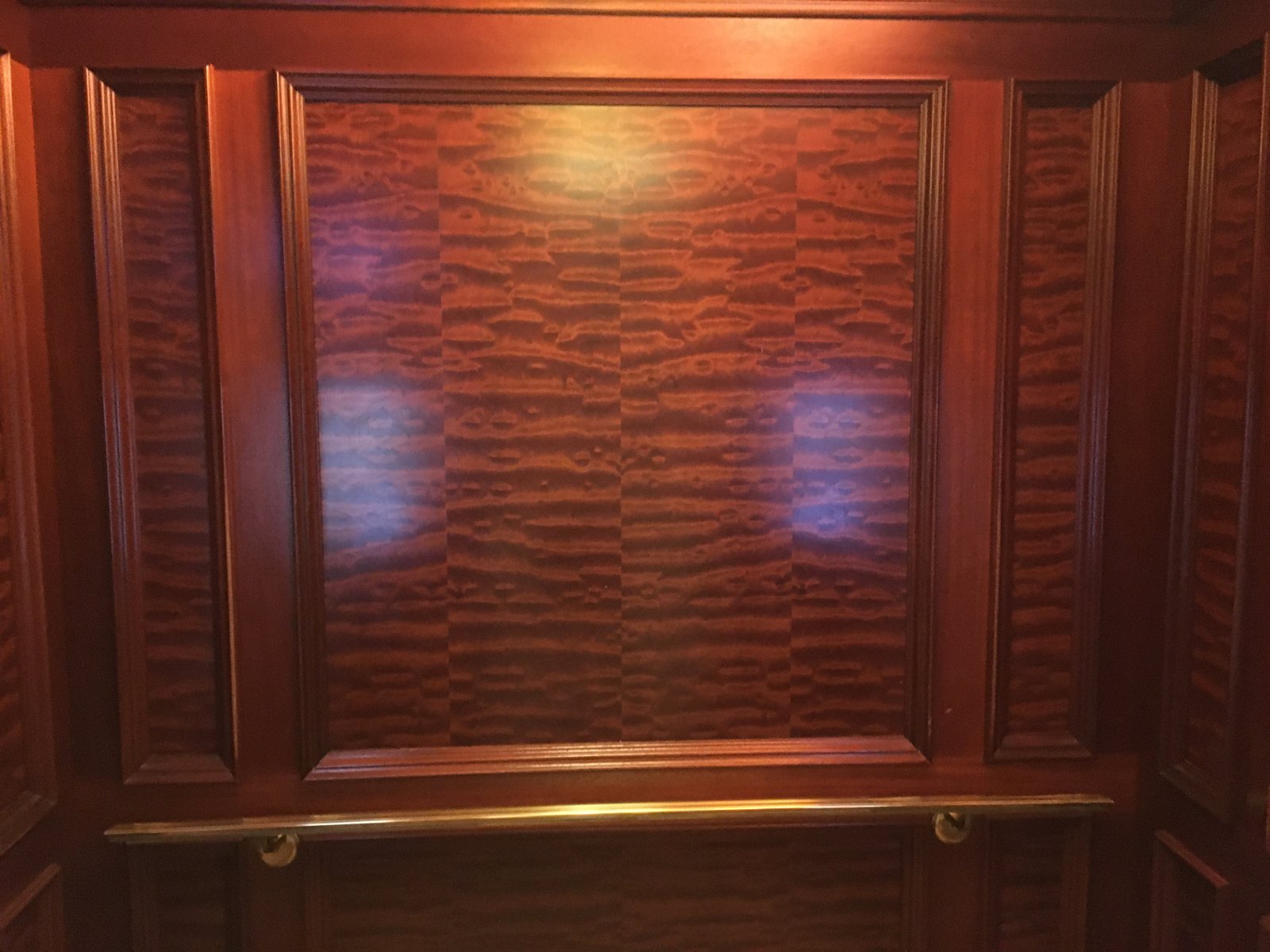

BTW, i do agree with both of you that its too busy for the coupe ... but its still one of my favorite woods for furniture / wood inset paneling in a millwork environment. i did elevator cabs out of this wood in the Ritz-Carlton Key Biscayne about 15 to 17 years ago.
I lived in key biscayne for a bit!

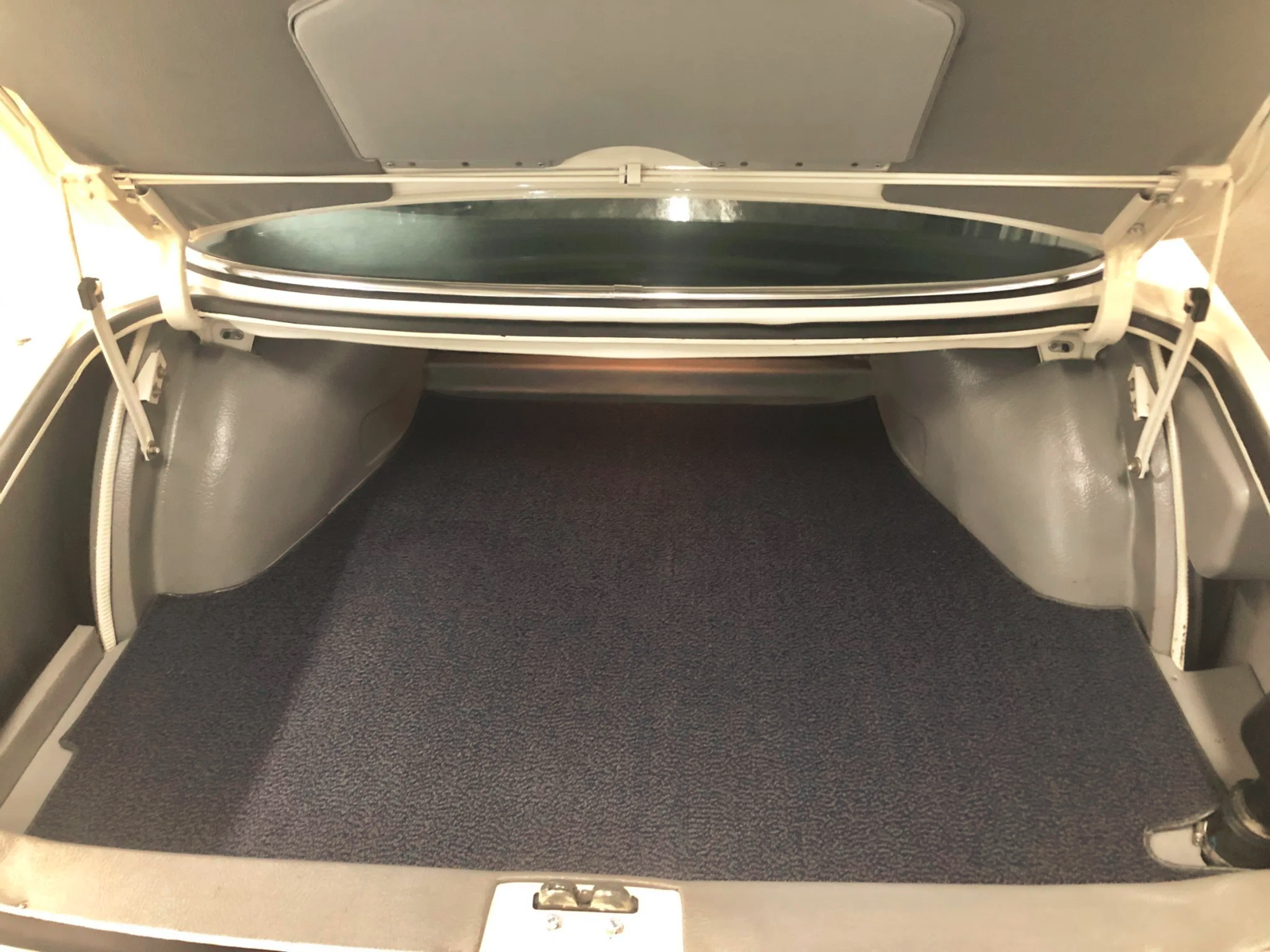

one very minor thing - the trunk carpet is from a '74 - notice how it is too narrow. there is a cutout for the bumper brace on the left and the gas tank filler pipe is too far away. the cocomat for the trunk fits so much better. all in all, this is a nice coupe.
Elevator cabs still look very nice!

thanks for posting!!! this is a really big figure. i had forgotten how big it was.
@dang - the grain of the wood on that dash is horizontal - the figure is vertical. look at the elevator cab above - the grain is running vertical (the flitches are about 10" wide), the figure is running horizontal. that's just the way this type of figuring works. i agree with you, i would have also chosen a different wood for a coupe. i chose a different figured wood for mine. i did not want a simple straight grained (non-figured) wood on my coupe ... most coupes are like that.
