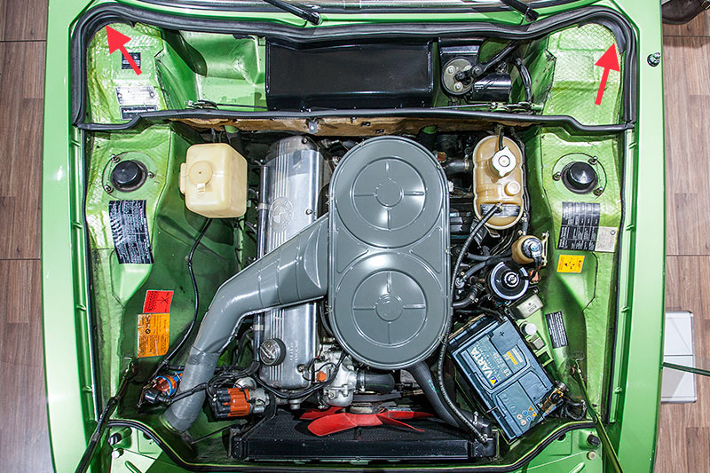

    #4 (discussed just the other day) is for the bulkhead gap. Best explained via the picture

    Do they look like these?
  8. pickman
    pickman Member
    Messages:
    45
    Likes Received:
    9
    Trophy Points:
    8
    Location:
    South Haven Michigan
    Yes Sir!
