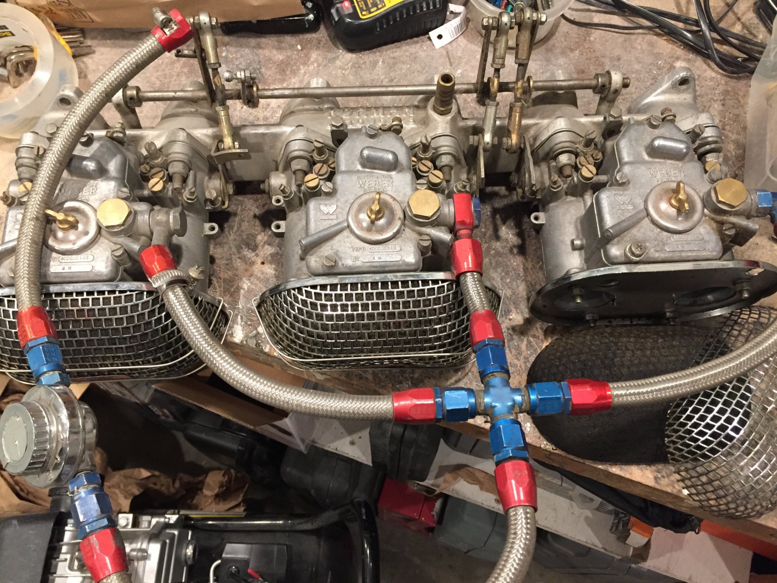

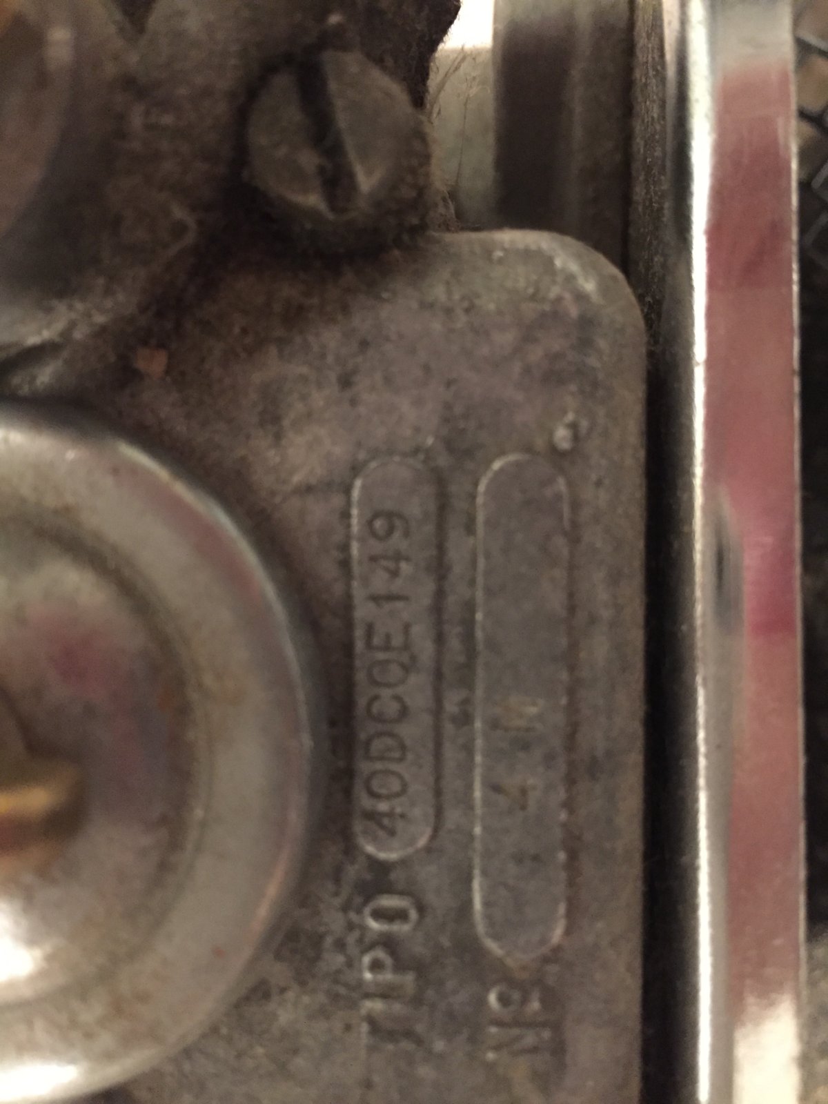

Weber 40DCOE149
Korman Manifold
Definitely need to be cleaned up. Internally they look ok. At least the one I looked at.
Bought this set up 6months ago, here. I have since decided to go EFI M30B35.

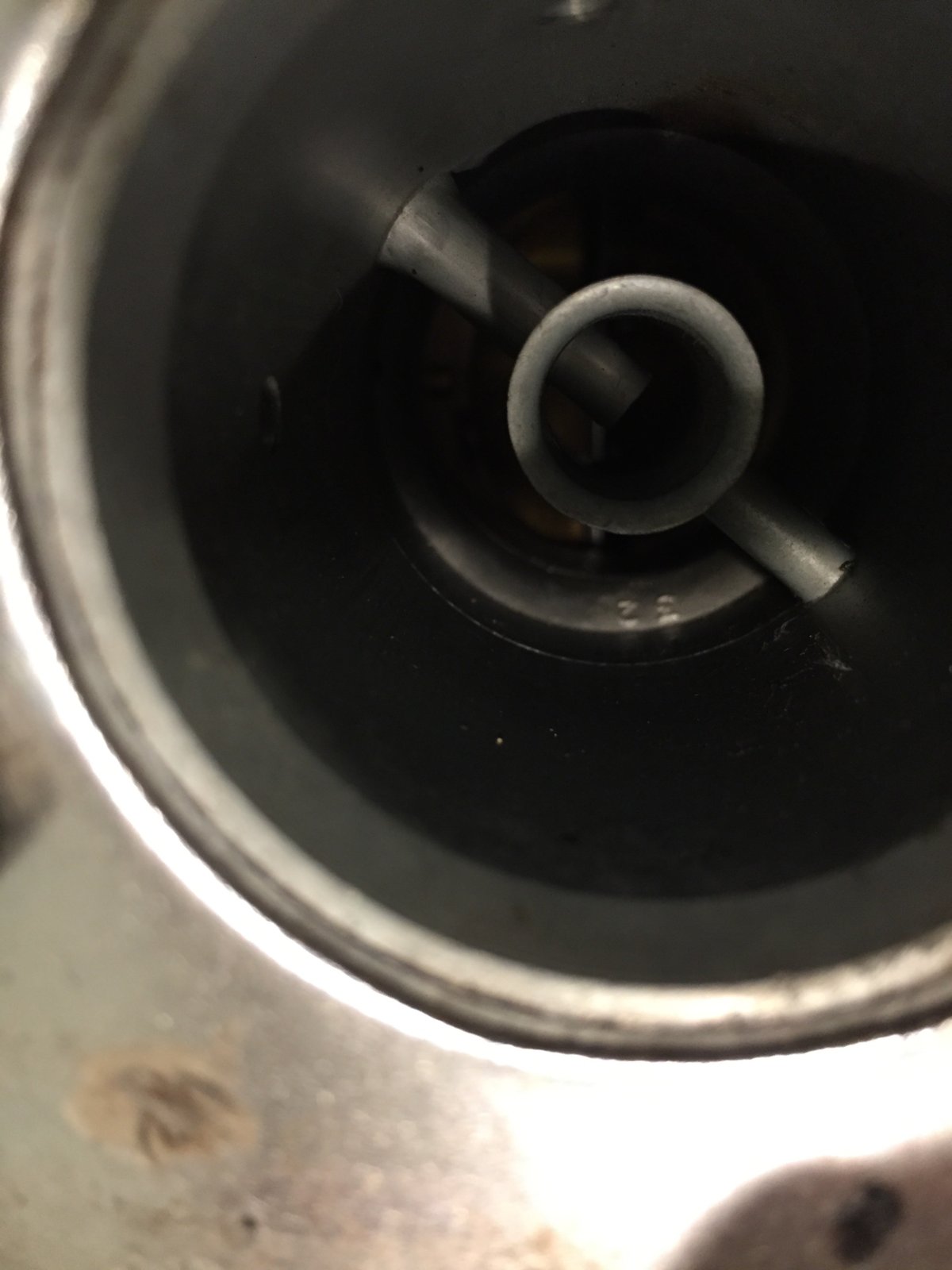

32 chokes
idle jet 55 F8
main Jet 125
imullsion tube- F9
air corrector is a 175
Paid $1400 shipping included. Willing to sell for same price; shipping included.

This is the set-up on my 3.3CS with a Korman stage 2 engine. The carbs are running very rich and I need to have them adjusted and probably re-jetted. Did this run well with the numbers you have listed? If so, I'll give that info to the shop that is going to do the work as a starting point. Thanks!

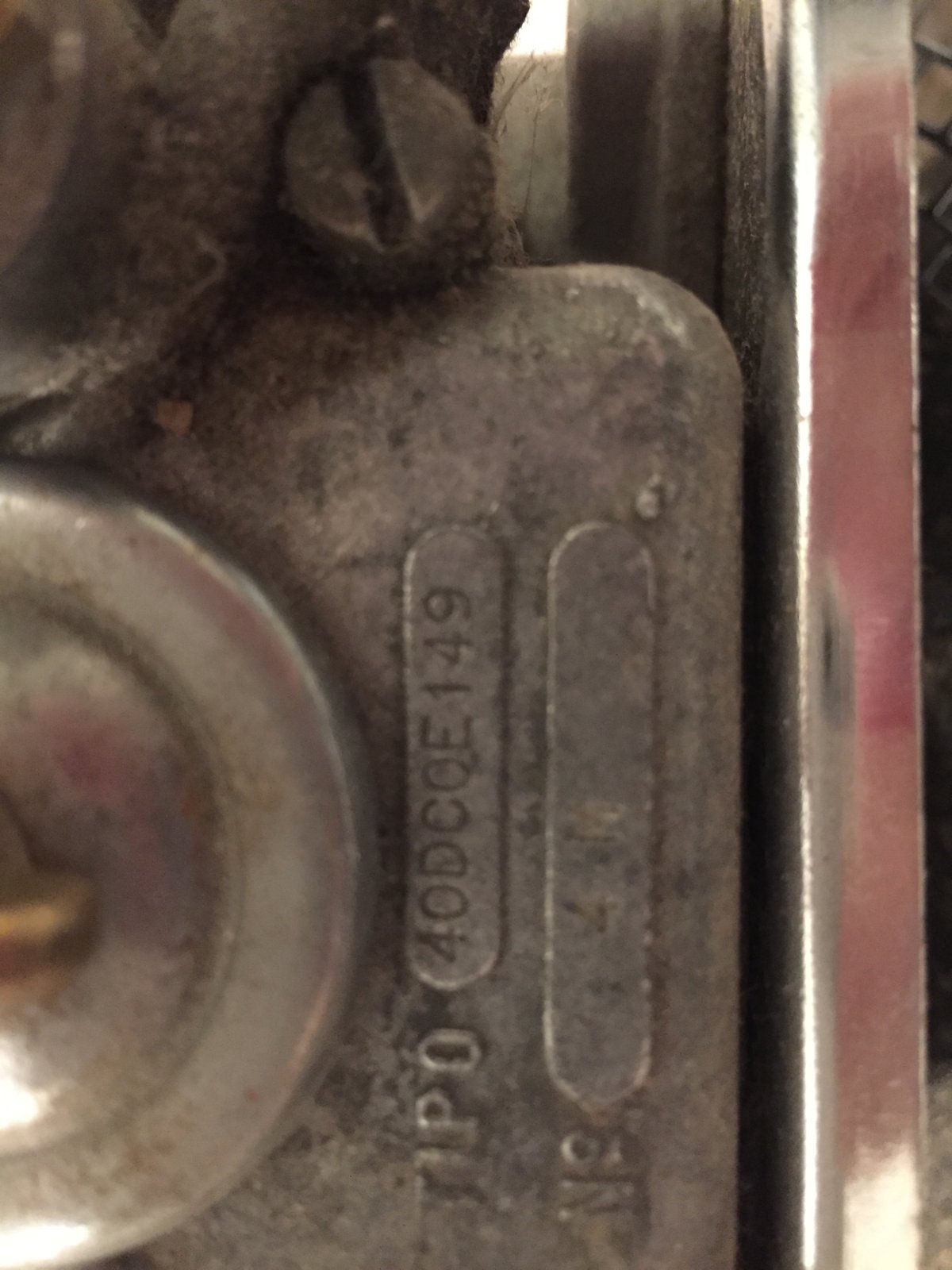

Weber 40DCOE149
Korman Manifold

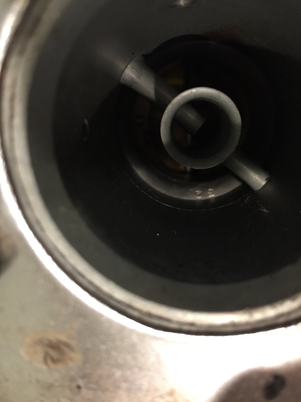

32 chokes
idle jet 55 F8
main Jet 125
imullsion tube- F9

Define running rich, at idle? Cruise? WOT? What is in the Stage 2 engine? If modified much these would need bigger chokes and jetting as they are more in line with a stock M30.

I ran 32mm Chokes on a stock 3.3l on the street (40DCOe). For track days I went to 34mm chokes but no change to jetting. Sorry but I do not remember the details, but it was all essentially Korman’s recommendations.

My engine was built by Korman in 2005 and has 3800 miles on it. I talked to them and they have no records back 13 years. The invoice copy shows an item # that they think was a 3.3liter M30 Stage 2 build. 3 DCOE40's, Schrick 282 cam,1 3/8" Stahl header,Alum. flywheel,Mallory distributor with points, Coupe King stainless exhaust,just installed. The car accelerates with lots of torque in the first 3 gears. I hear rumbling in the exhaust note upon deceleration shifting gears. Idle at 1000 RPM,with a slight looping. When I pull into the garage and turn off the engine,there's a strong gasoline smell for some time. All of this has been observed while driving the car at speed only twice for about 30 miles. The other drives were slow around the block while I sorted the brake problem. I live in Ft. Lauderdale and there have not been any "cold" starts--70 in the morning and 80's during the day. Car starts up with just a blip or 2 of the throttle. I hope you can give me a baseline of carb settings. BTW the custom exhaust made by the PO was full of black soot that left a trail in my driveway and a puddle on the garage floor.

I agree it sounds like it’s too rich in the idle circuit.
If you have adjusted the idle mix screws per the Weber of Haynes manual and it’s still this rich, then you may need to change some jets. It might be as simple as going one step leaner on the idle jets.
If that doesn’t help, I recommend installing a couple of bungs and buying a wide band AFR gauge (I have one from Innovate). Or, have a professional old car mechanic spend a hour checking the car setup. Ideally, he/she will
an exhaust gas analyst (an AFM gauge) so he/she can give you a report on AFR for the
(1) idle circuit,
(2) transition circuit,
(3) main circuit
(3) the accel pump circuit.
A knowledgeable mechanic should be anole to get this done in about 1.5 hours assuming the car is safe to drive on the open road (a dyno is an alternative). With this data in hand you can then make more intelligent choices of jet changes

The car is going into a restoration shop referred by Hagerty. They were tuning a Lambo with 6 Weber 45DCOE's when I was there. They'll fix it. Thanks for the advice.

"The Creative workshop" http://thecreativeworkshop.com/ is a world class restoration shop for all types of vehicles. Their carb expert took the big air plenum off my carbs and found a bunch of things to be sorted. Just balancing the carbs smoothed out the idle and eliminated the black smoke. Now I need to find the short horns and mesh covers to clear the brake booster since the custom air plenum is not being used again.

Back to the OP, I think this is a very good buy at $1400. Everything I’ve ever gotten from Korman (mechanical, not body), was really good stuff.
This kit will clean up easily/nicely and would be my first choice for going to triple DCOE’s. I’m using a real Alpina setup and the older style DCOE’s only because of the bling factor, not that it will work better than the Korman setup (it won’t).
