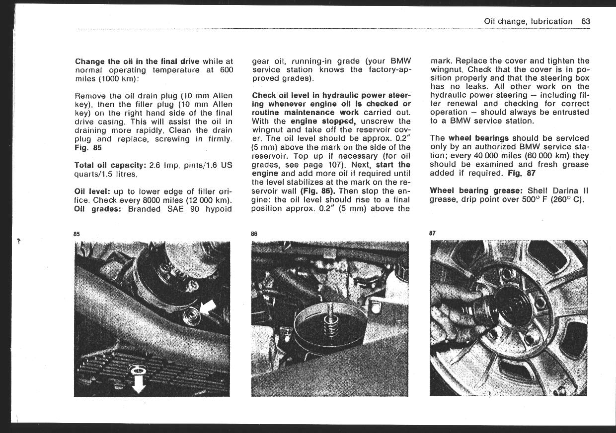

The wheel bearing play should be obvious, even without removing the wheels. In any case, removing each disk and examining the bearings and bearing races would be a good idea and is part of routine maintenance (every 40k) that is easy to overlook. I would not be surprised to learn that many E3s and E9s are still rolling on their original rear wheel bearings, which, to the best of my knowledge, are not not designed to be disassembled and reused.
I would venture to guess that virtually all commercially available name brand wheel bearing grease suitable for disk brakes would meet or exceed the original recommended grease. However, if someone is unlikely to neglect their wheel bearings - for decades - maybe Krytox is the ticket. http://e9coupe.com/forum/showthread.php?t=5500
Hth
http://www.e9-driven.com/Public/Library/BMW-E9-Manual/pages/en/31200040.html#refertoc
