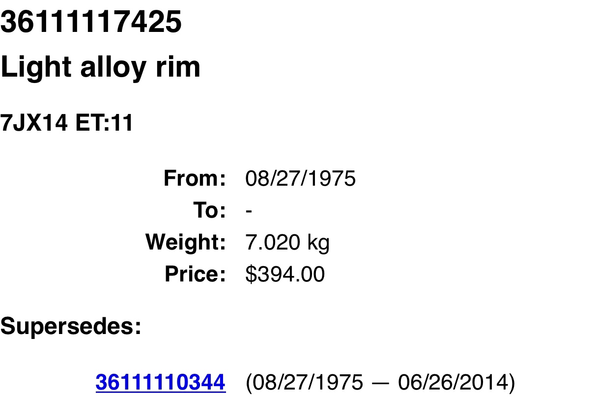

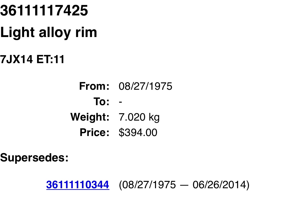

No the 6x14 are what came on the 74’s. The lip is smaller. The 7x14 FPS look just like the CSL Alpinas but with 10 holes and the FPS logo.
Different part number, size, offset, and part number:
My apologies if this is off topic, but I'm new and trying to find out if this wheel is a good fit. I've laid my hands on a 72 CSi with the alpina 7JX16 + 8JX16 setup, which is very pretty, but the front tyres rub the fender. I'm looking into switching to these rims. I understand the offset is the same on 7" wheels. Would these take care of the rubbing problem, even with 205/14R70 tyres?

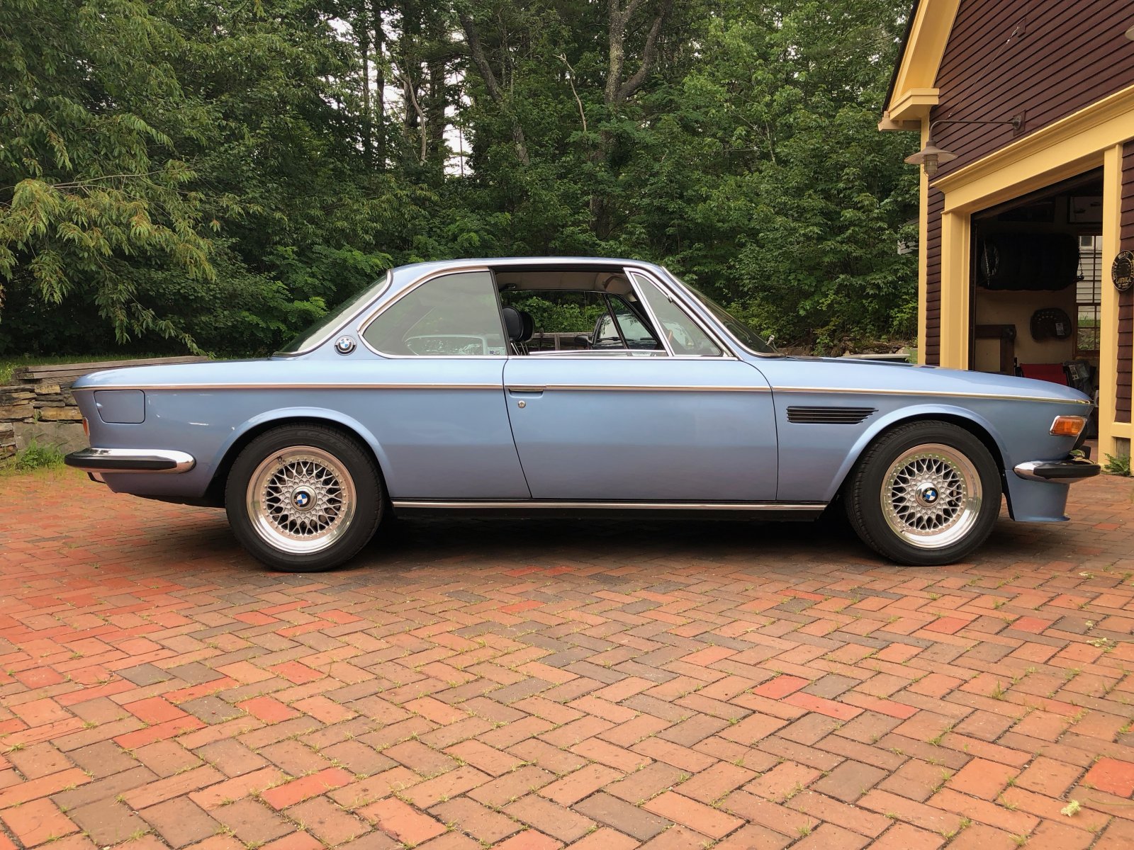

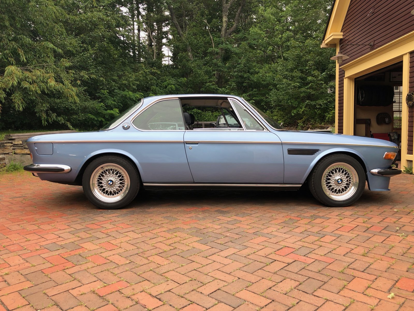

BBS RS, 16 x 7, ET 11 with 205/55 16 and adjustable negative camber plates. Front fenders rolled between 10 & 2 o'clock.
