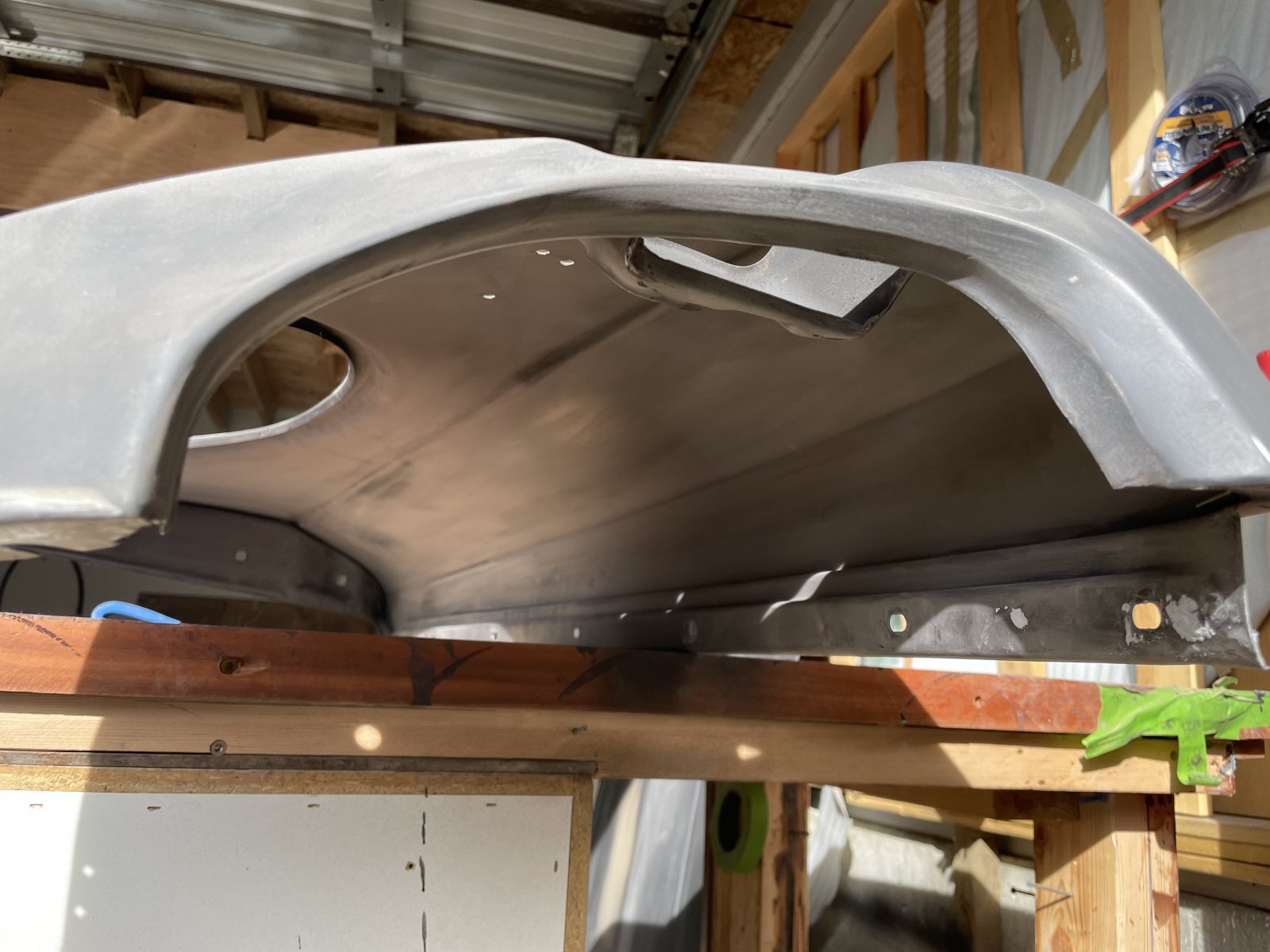

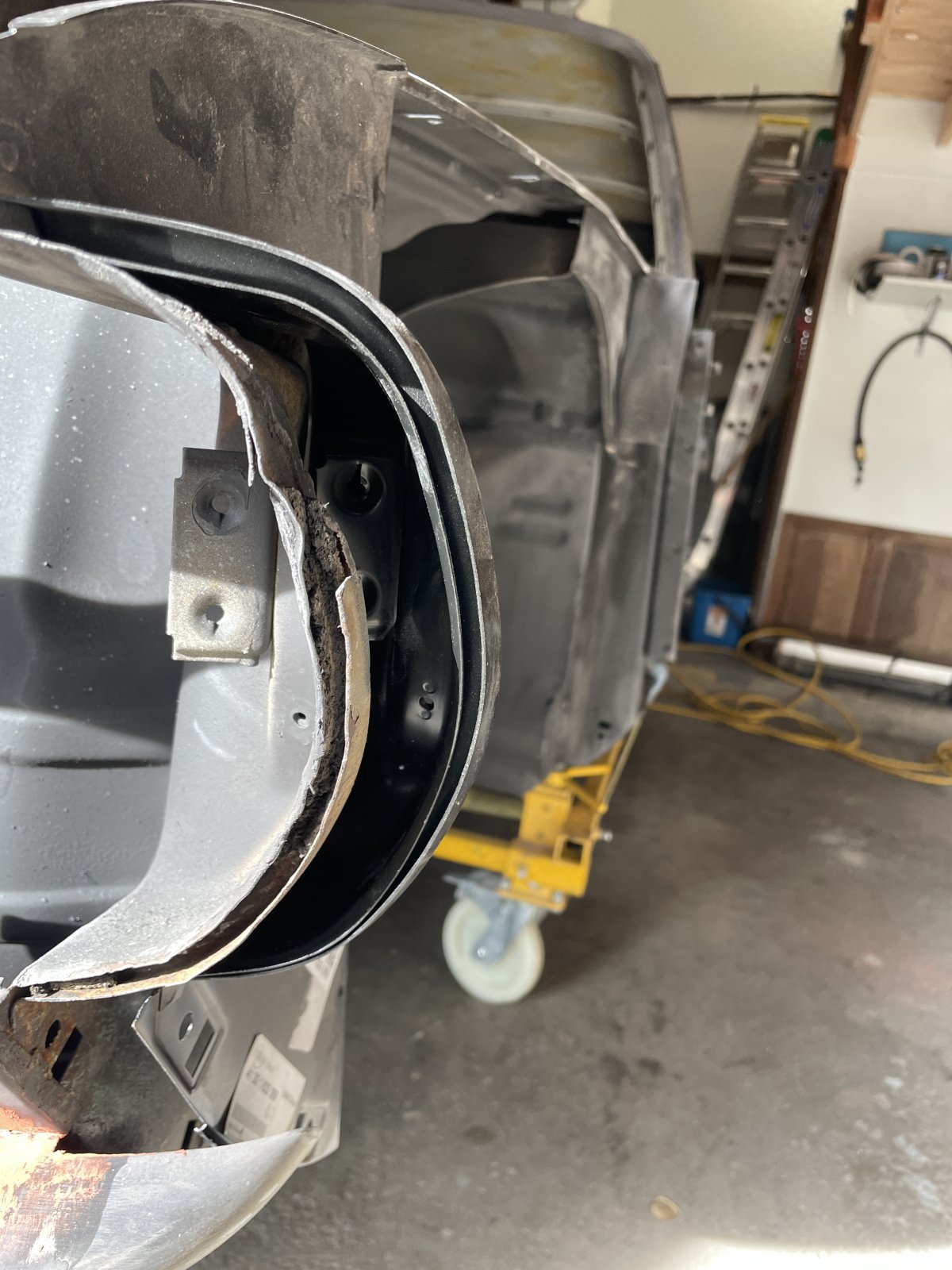

I was able to source a left and right “front side panel.”My question is: how far should/does the lip on the fender
Insert into the side panel slot/recess? The side panel is filled with a seam sealer material which envelopes the fender lip
but how much affects the precise placement of the side panel?

I have mocked It up and the fender doesn’t quite slide into the Side panel but there is some room for the panel to be slid forward. All in all, it’s probably not critical so long is the fender can slide someone into the seam sealer which gets laid into the side panel. I suppose it’s more critical that the vendors lineup with the hood and the lower valance, etc.
