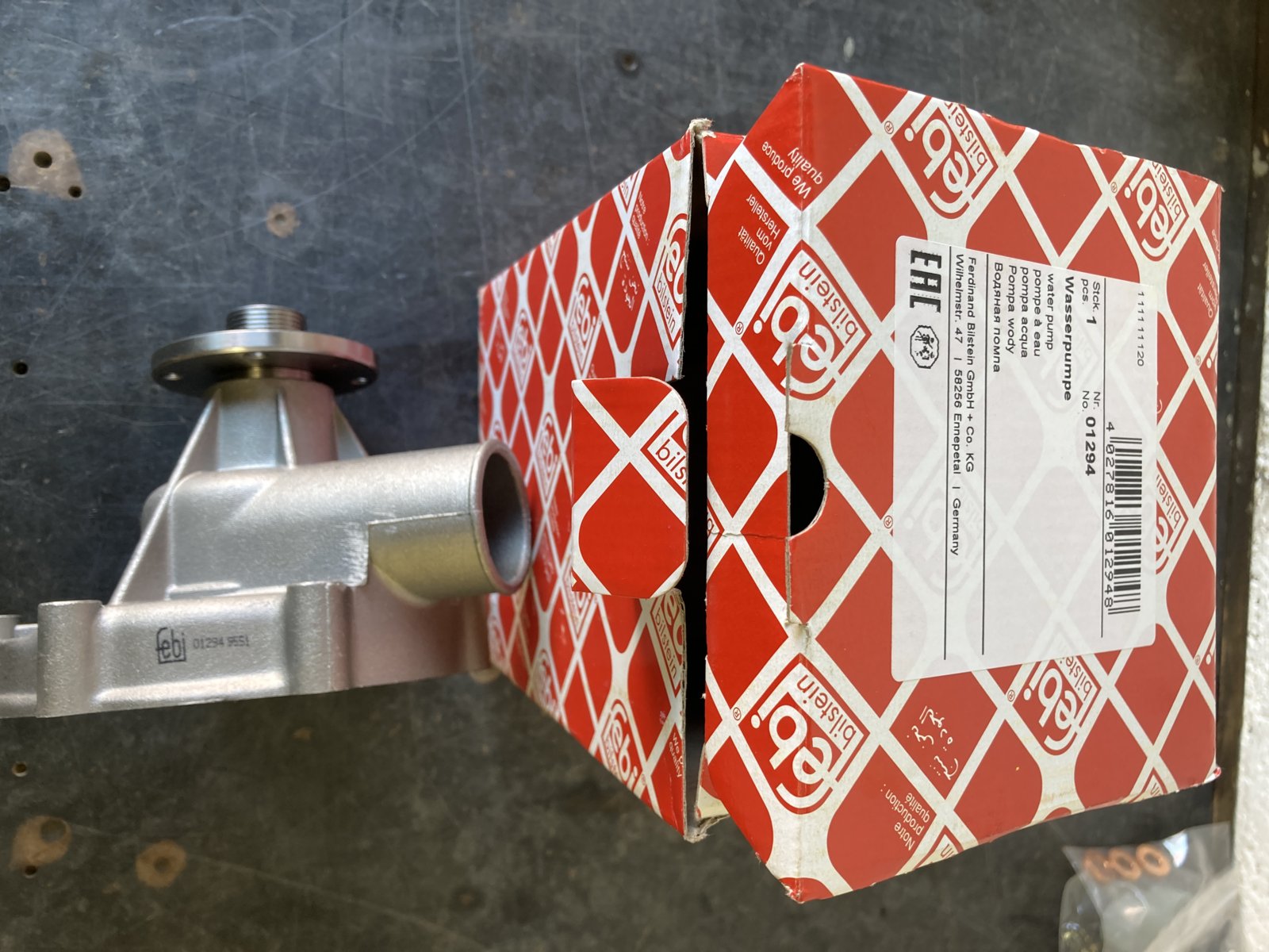

James Poulter
59
42
Royal Leamington Spa
Hi,
These are very good quality, Febi Bilstein so German made very close to the original, also very good value, fitted mine today. Should certainly be good for 40,000 miles which my car isn't likely to see in a very long time.

Other thna the Febi corporate German address, does it actually say made in Germany on it? They can play loosey goosey with that
stphers
1,072
523
Made in Germany does not always mean that it is good Worked for Volkswagen Canada for 10 years and spent time at both Wolfsburg and Bratislava . We were right on the assembly line watching, talking to workers where the majority of them were from Eastern Europe better paying jobs that at home but still not great Saw plenty of poor workmanship! Most parts coming out of Germany are probably made elsewhere because it is the bean counters that really run the companies so they want to save a dime Lot's of it is farmed out to other companies All brands nowadays are the same so bottom line, just cause it says made in Germany doesn't automatically make it better Keep this in mind
