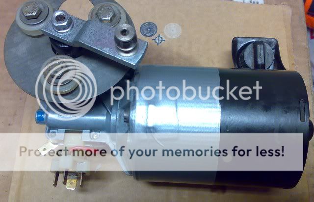

strange car this e9, the wiper-blade motor is laying open air, (well, yes, inside the water box, but if it rains, it gets wet)
the problem in my case is that in top speed of this motor, you can feel the supreme effort of moving the blades as if the world has came to an end
so a second hand younger 1974´s motor is here to help, but first, some cleaning and new grease
start
gasoline to clean it
clean

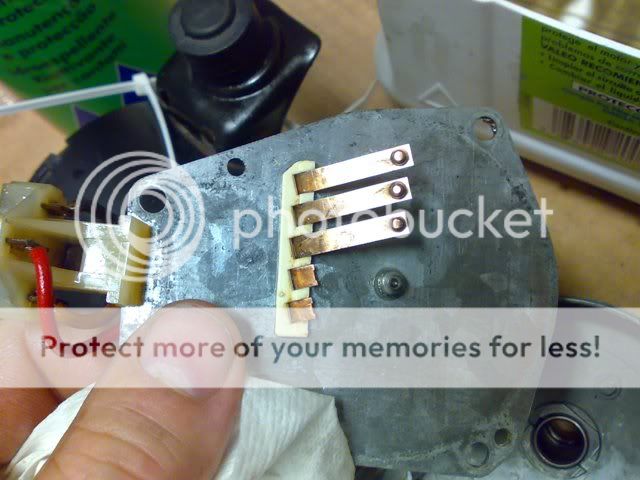

contacts sand paper and dielectric fluid spray

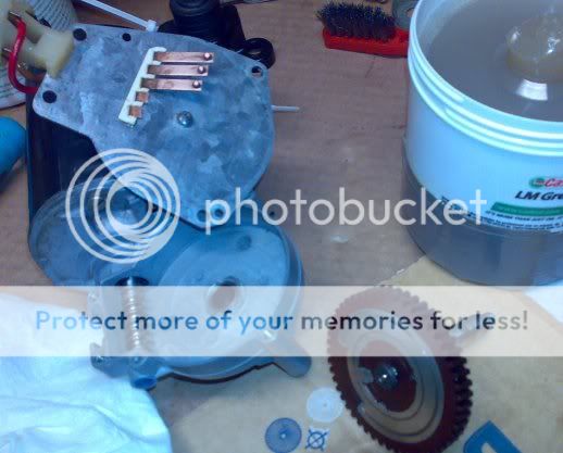

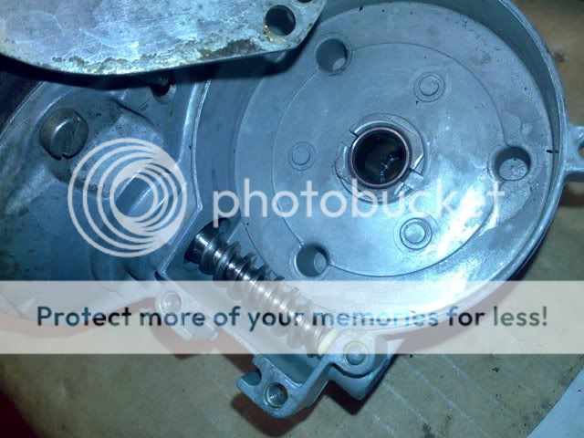

castrol LM grease

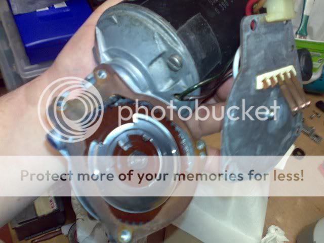

assembly

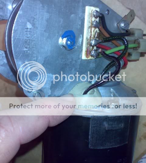

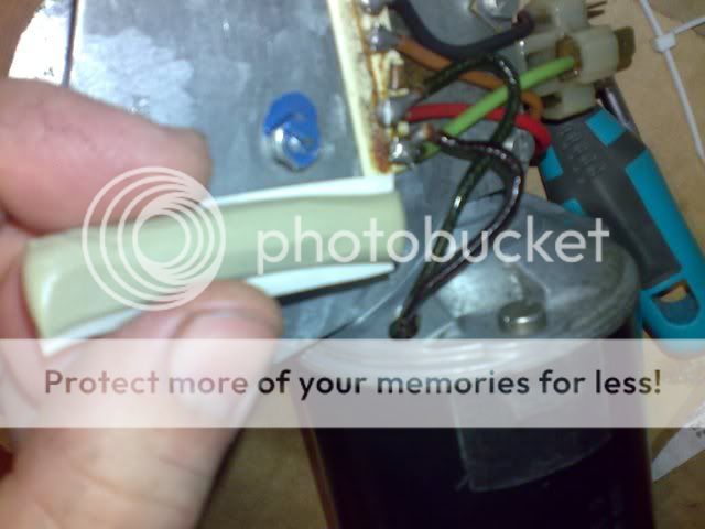

and plastiline (butyl) to close the hole of the cables going inside the motor
detail
ready for assembly

Just wondering if you took the motor apart and discovered the magnets were cracking and/or disintegrating? I had that problem with two motors from a '74 and a '75. I am wondering if it would be possible to epoxy the magnet pieces back together?
deQuincey
Quousque tandem...?
8,371
2,389
no idea, i suppose it depends on the damage, or level of disintegration
the problem i guess, is that if you use epoxi to glue the magnet to the wall, the thickness of the glue can make slight difference in the position of them and they might collide with the rotor
in the old motor, i took out the rotor, to clean some magnetic particles that had come off the magnet and were stumbling down there, but the damage was not big and i can stand with the result.
i don´t know how to help you, no ideas,...
