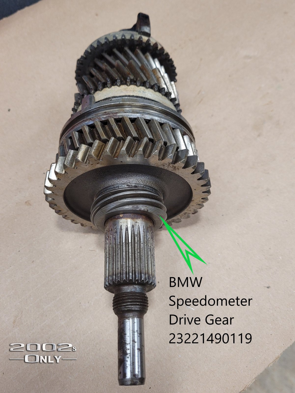

Those speedo drive gears are the same for almost all vintage BMW 4 and 5 speed transmissions. So you are not just limited to the ones on the e9s or early sixes. Here a pic of the gear from a 1968 2002 with the early style Porsche synchros. This is what I used for the 5-speed conversion.
