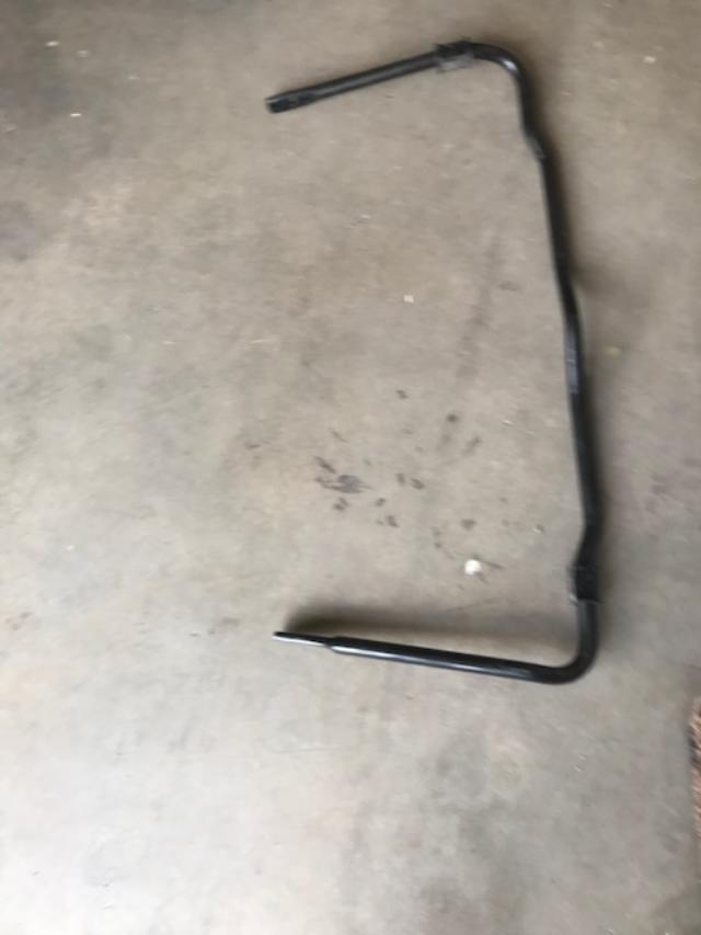

I have a hard to find 24mm adjustable rear sway bar from an E12 as pictured PM me for more
