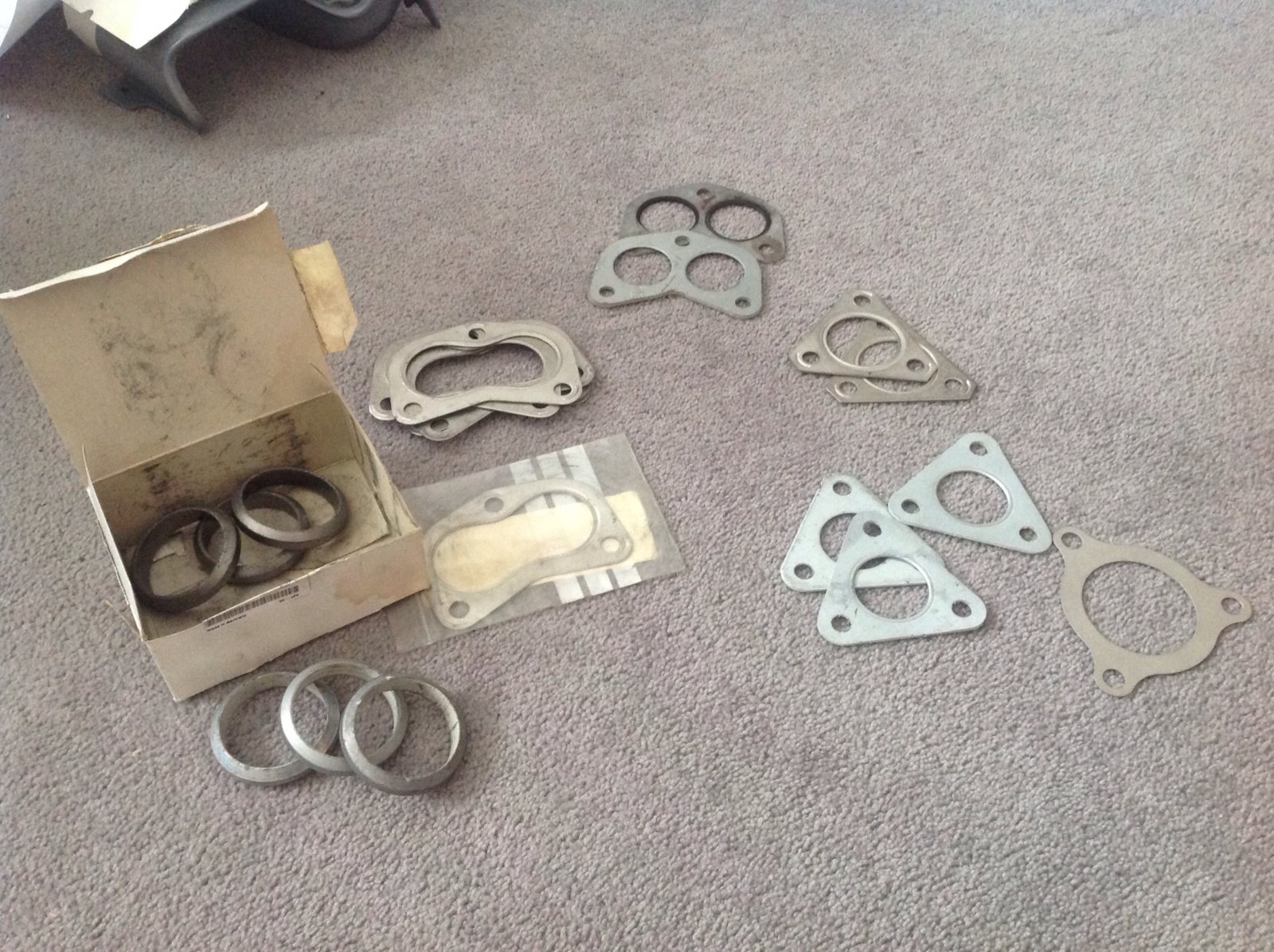

This is my box of exhaust gaskets, any of these?

That looks like a 2002 gasket for sure but the e9 LHD doesn’t use that as the down pipes are separate. Will it fit a RHD coupe?

In my car I have fitted the equivalent part from an E24/28, etc. 18111245500
I don't know if they are fully interchangeable, but it fits and works just fine. Fitted the later part as I had a small blow with the earlier part, likely due to my poor fitting

Walloth don't seem to show them on the E9 page, we buy them from them but its under this part number A18111728363 relating to the 5 series model.
Fitted one only last week on a RHD CSL.
Hope this helps

That's a big help mate. They also look the same on the 2002 page. No idea if they fit and haven't compared part numbers. Didn't think I'd be the first guy to have this issue :)
