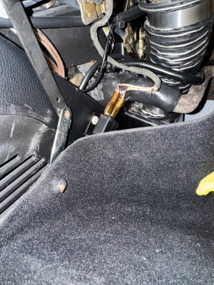

Switch pn 61311353291 for the glove box light mounted on the right side of the console for the 2800CS.

Bump - Should look like this

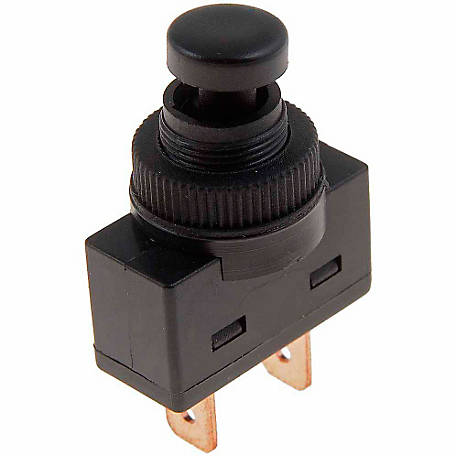

Dan If you cannot find one, there are aftermarket switches that should fit just fine and do the job. Found this searching for "Cambridge Switches" on Amazon.
Bob
I have looked at the autoparts stores and haven't found anything as close as you show.
That one appears to be normally off and the light switch needs to be normally on.

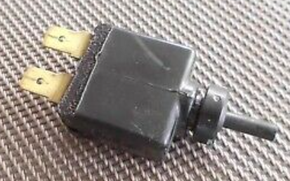

Switch was just for the idea. Gotta be one out there that works "backwards".
And I do appreciate it! That switch looks close to the original. I looked on their website and they didn't have the one that would be normally on. I did find a couple others on Amazon that might work. I am just hoping someone has an original that I can throw in and not have to adjust it to make it work.

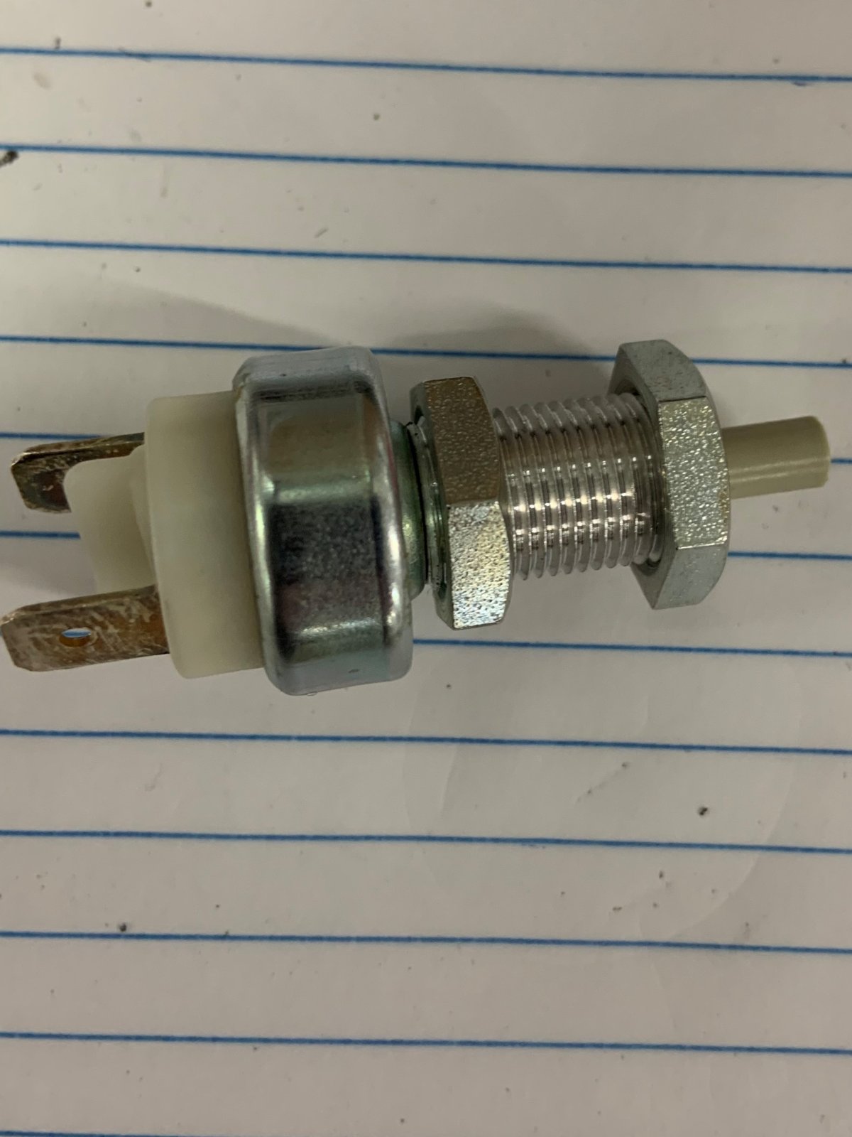

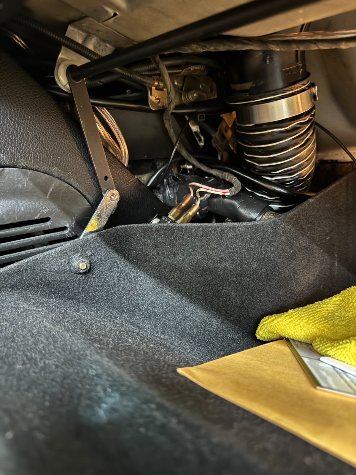

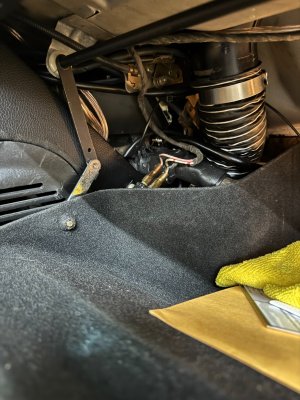

I bought an E9 aftermarket stop light switch pn 61311368786 and I believe it will work as a replacement for the Glove Box Light Switch.
It will take some adjusting since the plunger isn't as long but there is plenty of threaded length.
