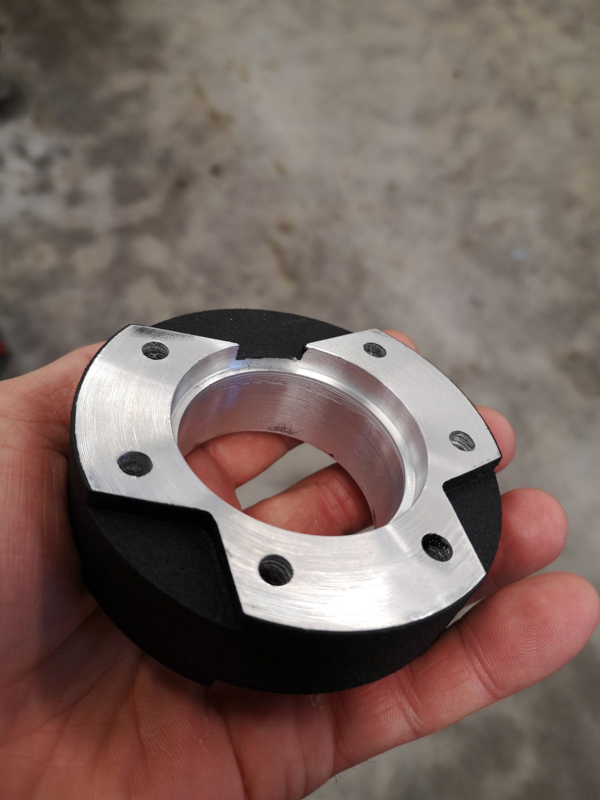

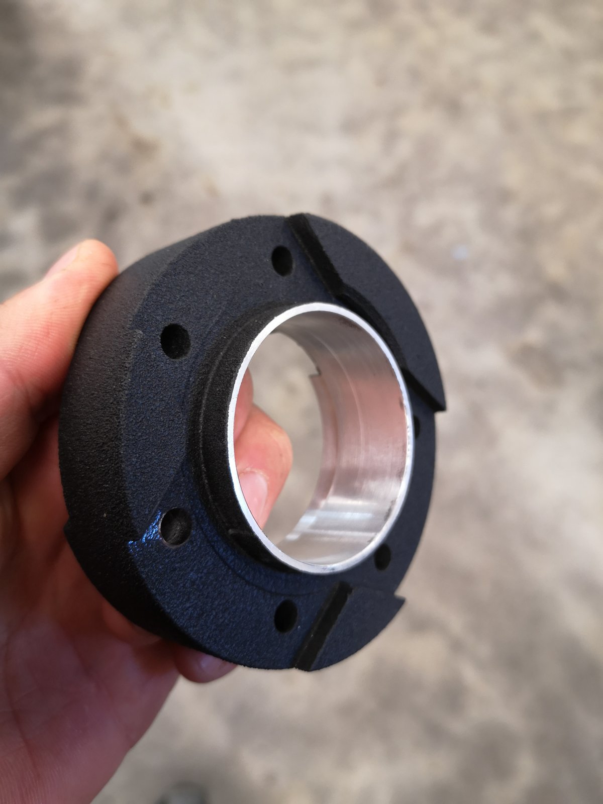

I think Robert if you need 2-3cm - one of the best ways will be spacer between hub & steering wheel spokes.
1. Option without original hub cover - from steel or aluminium on the cnc you make 90mm outside diameter round spacer/adapter on thickness you need + crown for horn button, drill the holes in it for longer bolts & that's it.
2. Option with original hub cover - all as in option 1 + from both sides you will have to mill on milling machine the shape & thickness of 3 spokes (from underneath - outside shape & from behind - inside shape)

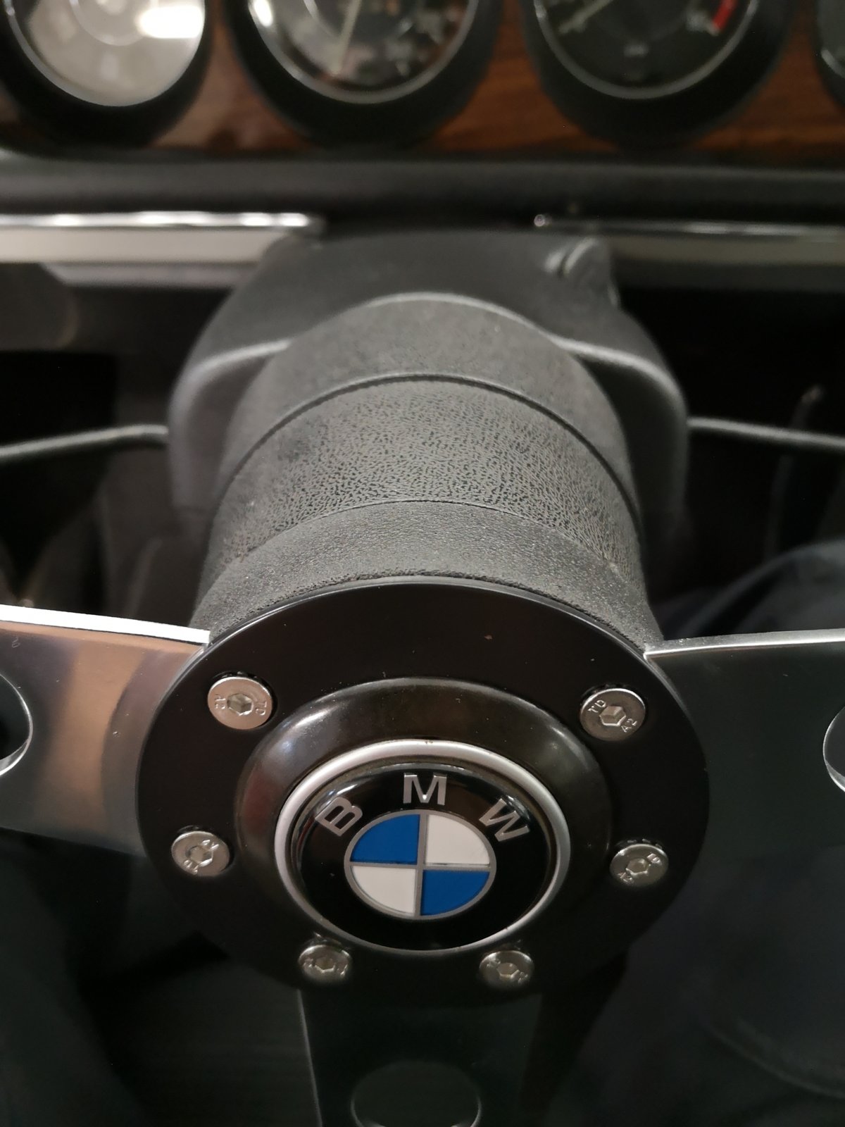

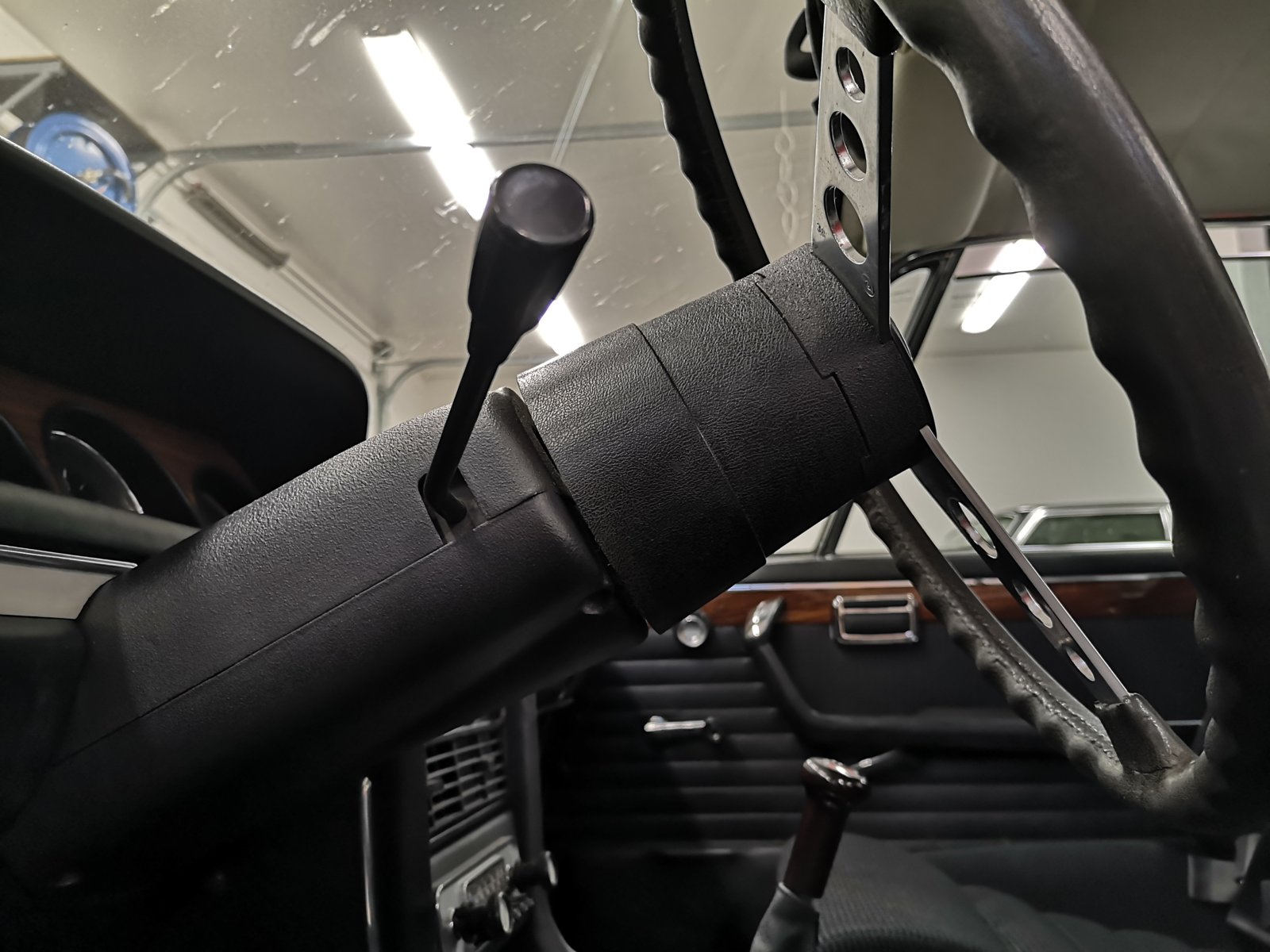

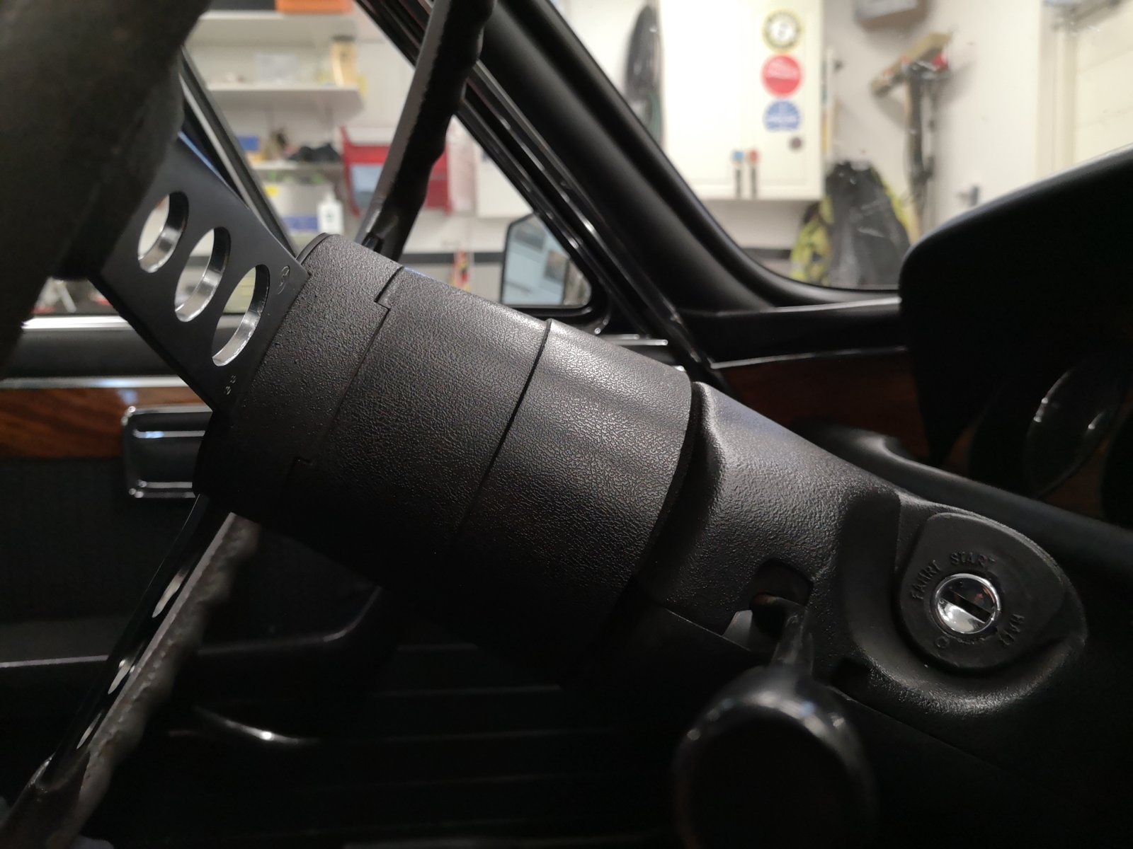

Look at this you guys, I've always been impressed, and continues to be so by how helpful everyone here is.
Ask for something that doesn't exist, and still someone, @Wladek in this case, reaches out and is willing to make a one-off special for you.
The spacer turned out beautiful, and the driving position is greatly improved. Thanks Wladek!
