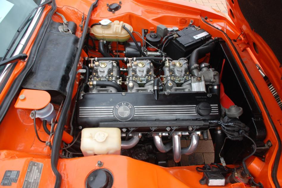

While I've got your attention Rod, what did you do for an air cleaner with your triple Weber set up? ( Been talking to Simon at RX ). And how did you clear the thermostat housing?
Gazz,
Say hello to Bill for me.
My triple webers have mesh filters on them. They are race car style which slip onto each throat.
Weber to thermostat housing interference all depends on which manifold you find for the webers. I made up a cad drawing of a 41-45mm (from memory) stand-off for the thermostat housing. I got an aluminium part water cut from the CAD plan. I put in some longer studs into the head and shortened one leg of hose which goes to the water pump and the radiator (on the left) and lengthened the hose which goes to the radiator on the right.
