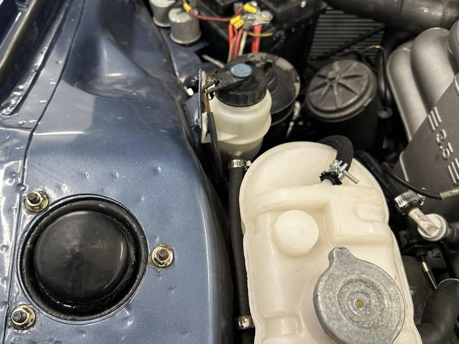

Here’s my favorite photo. Low brake fluid and too many Ace hardware hose clamps. There’s a clamp on one line at brake master too.

And the pic with the low fluid is the perfect example of the absolute and total lack of 'whatever' the seller/restorer has going on with this car.
I started a list of things of interest that potential bidders should look into. I gave up on that - the list just got too long and I got too depressed....
