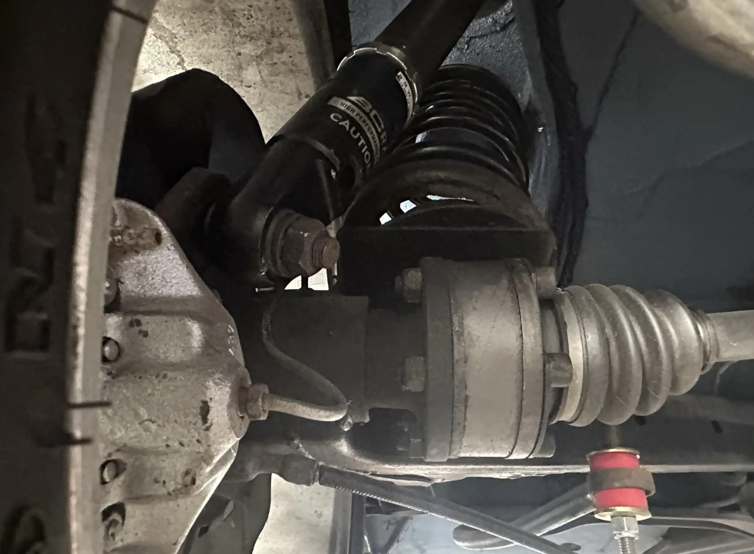

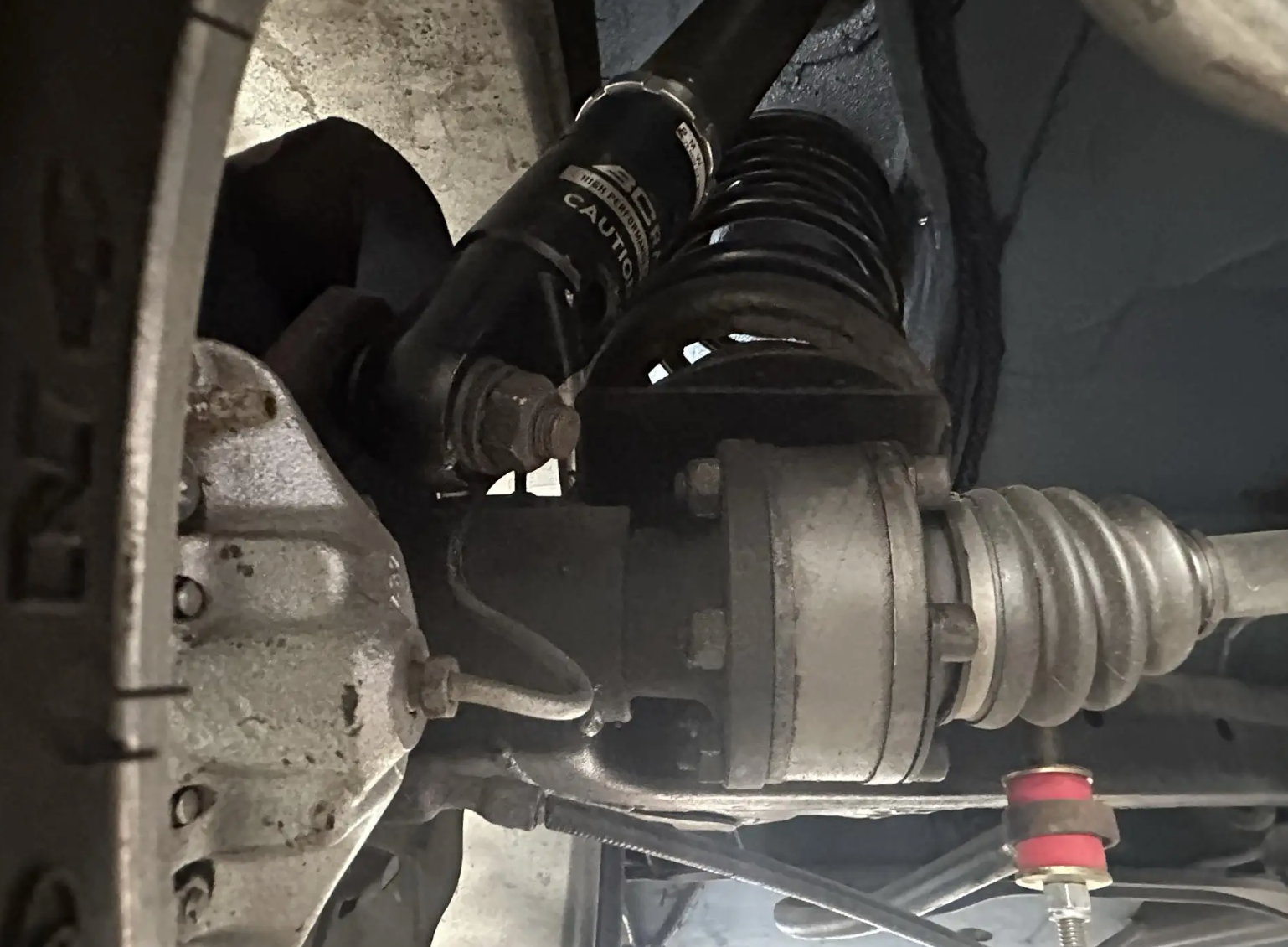

Is this normal geometry for shock versus spring? Is this just a camera perspective thing, or are these two enjoying some physical contact?
